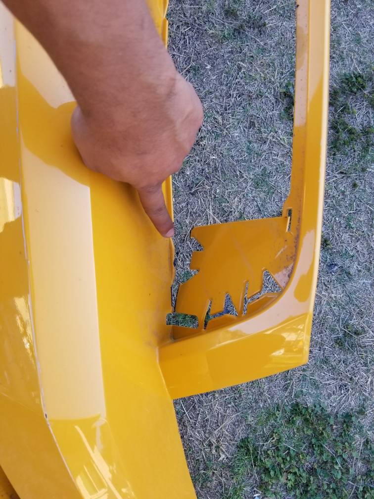

Hello,
I’m new to this sub and I can’t find anything about this topic, the part where the grill clips onto the bumper has cracked at the bottom, could I fix this with just some epoxy or JB weld?? Or is there a better solution to this issue.
Thanks for the help. Truly appreciate it

3m epoxy will work for sure they have different ones for work time needed 2 min, 4 min 6 min its a 2 part tube we use it in work from time to time
