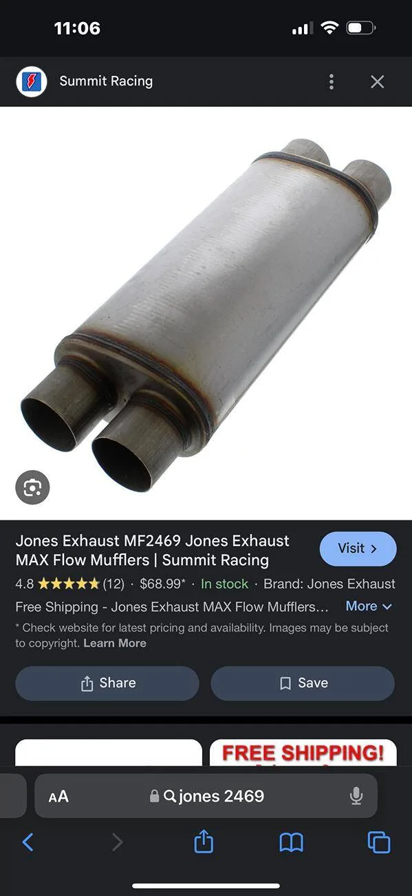

I had the true dual 3” jones max flow welded in where my resonator was, now it’s almost quieter than stock … sounds tits, it’s an X
Quieter than stock with headers just adding this muffler?? Do you have any videos you could send me?

No, but I have stock active, so when I start it in quiet it’s fantastic, and when it idles down there is zero rumble, just compressor noise from the whipple.
I’ll try to do a quiet start vid next time out in the garage
