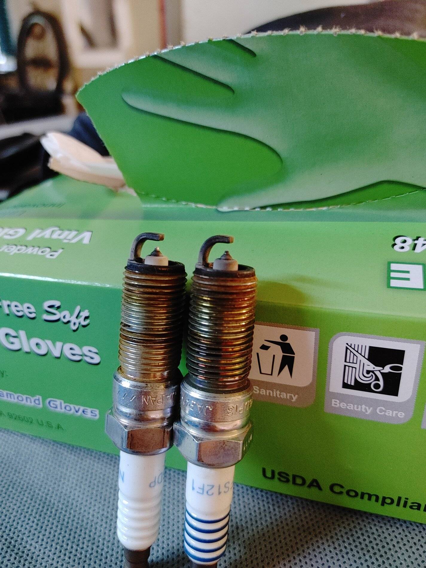

Little guessing game. One is the stock tune. The other is tuned. Same cylinder picked at random. Which is which, and thoughts on both.

What are your LTFTs at when your STFT are 12-14%
LONGFT1
4.688%
LONGFT2
5.469%
Then the log 2 mins later
LONGFT1
1.563%
LONGFT2
1.562%

Why's that ?
any 'evidence' gets erased/contaminated as soon as you roll out of the gas, idle, drive. You suddenly stop the spark firing, coast to a stop and pull the plugs right then and there.
Ok well, the tuned plug is the left, stock tune left.

that's a neat trick. :)
oh haha. Plug on the left is with the custom tune, plug on the right is with the stock tune. Sorry for not being specific.
That's why you see people stopped at the end of a drag strip with their hood up. reading plugs.
Looking at your plugs the one on the left looks to be leaner than the right.
I’m going into the deep end of the pool here so hold tight.
Fine wire electrode plugs are most accurately read by closely examining the silver color transition into black.
The General rule is only 1/3 of the fine wire electrode should be silver towards the tip while the last 2/3rd’s is blackish.
I know the old school way of reading the color of the insulator and surrounding area but unleaded oxygenated pump fuels have changed that game.
Thats me, old school.
Blowing that pic up looking at the electrode the left is good right is rich?

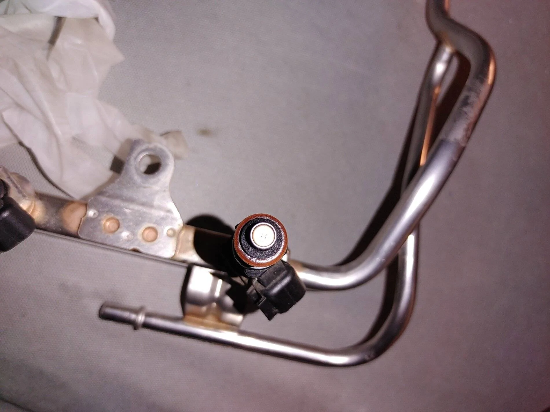

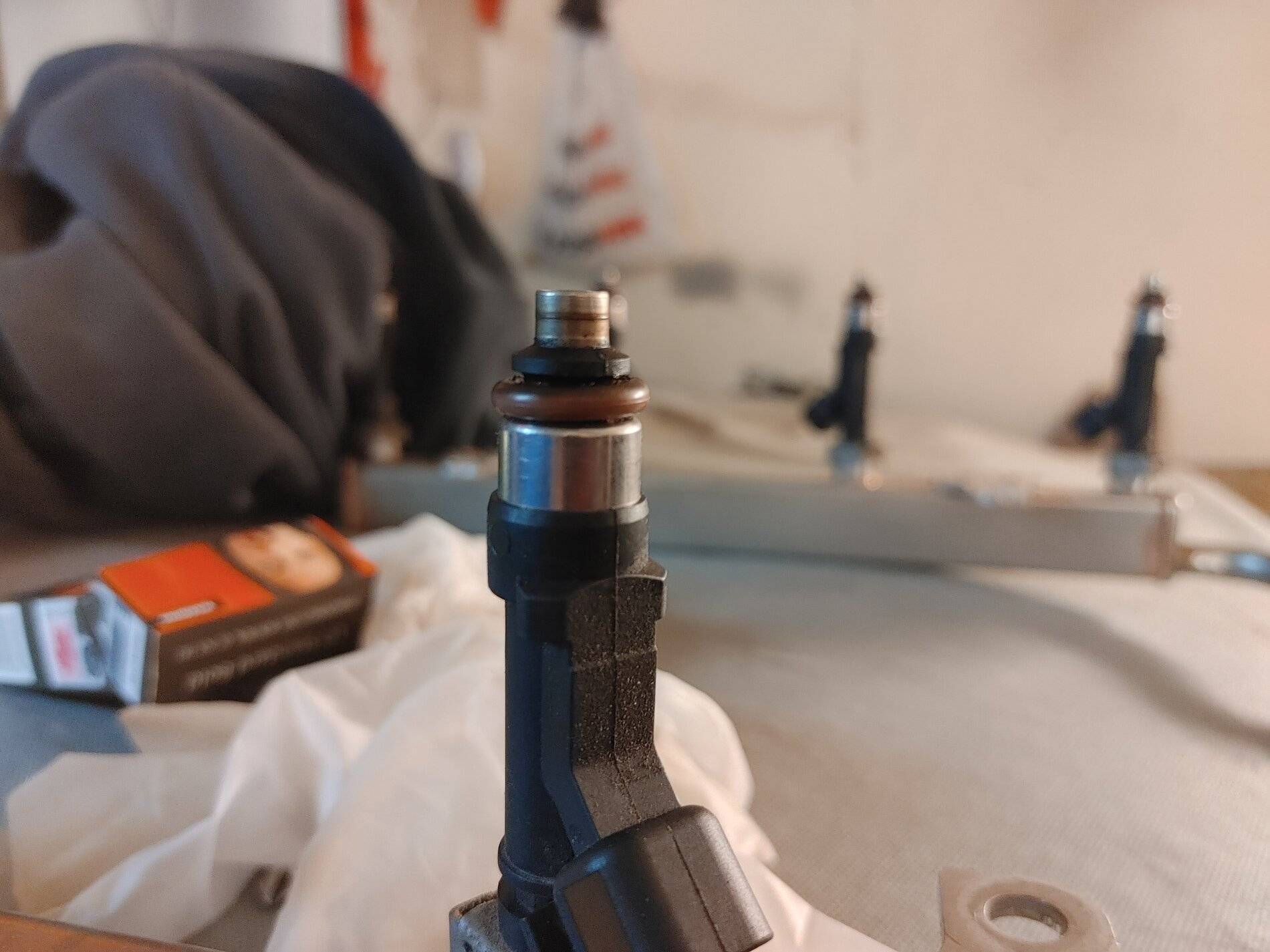

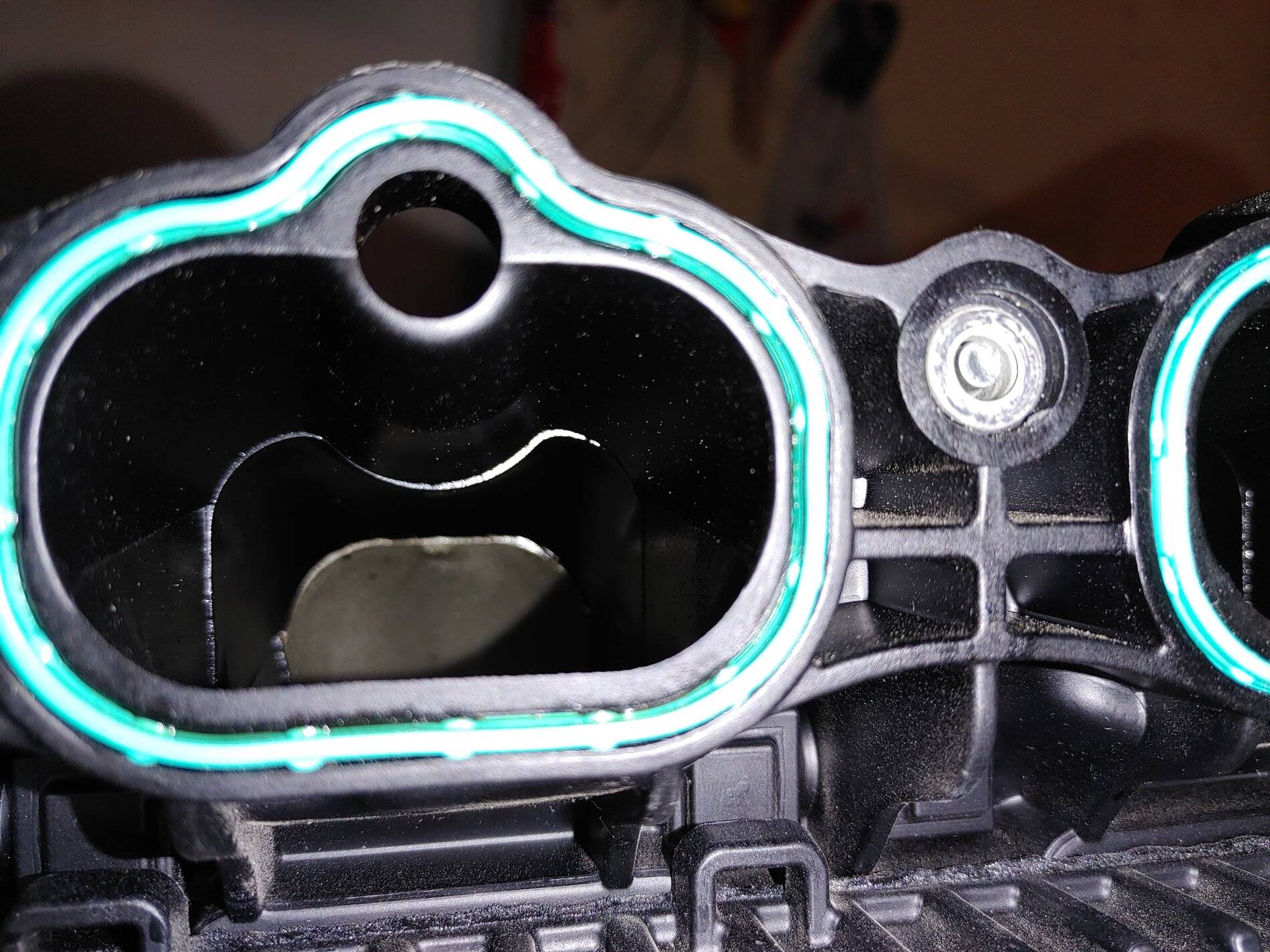

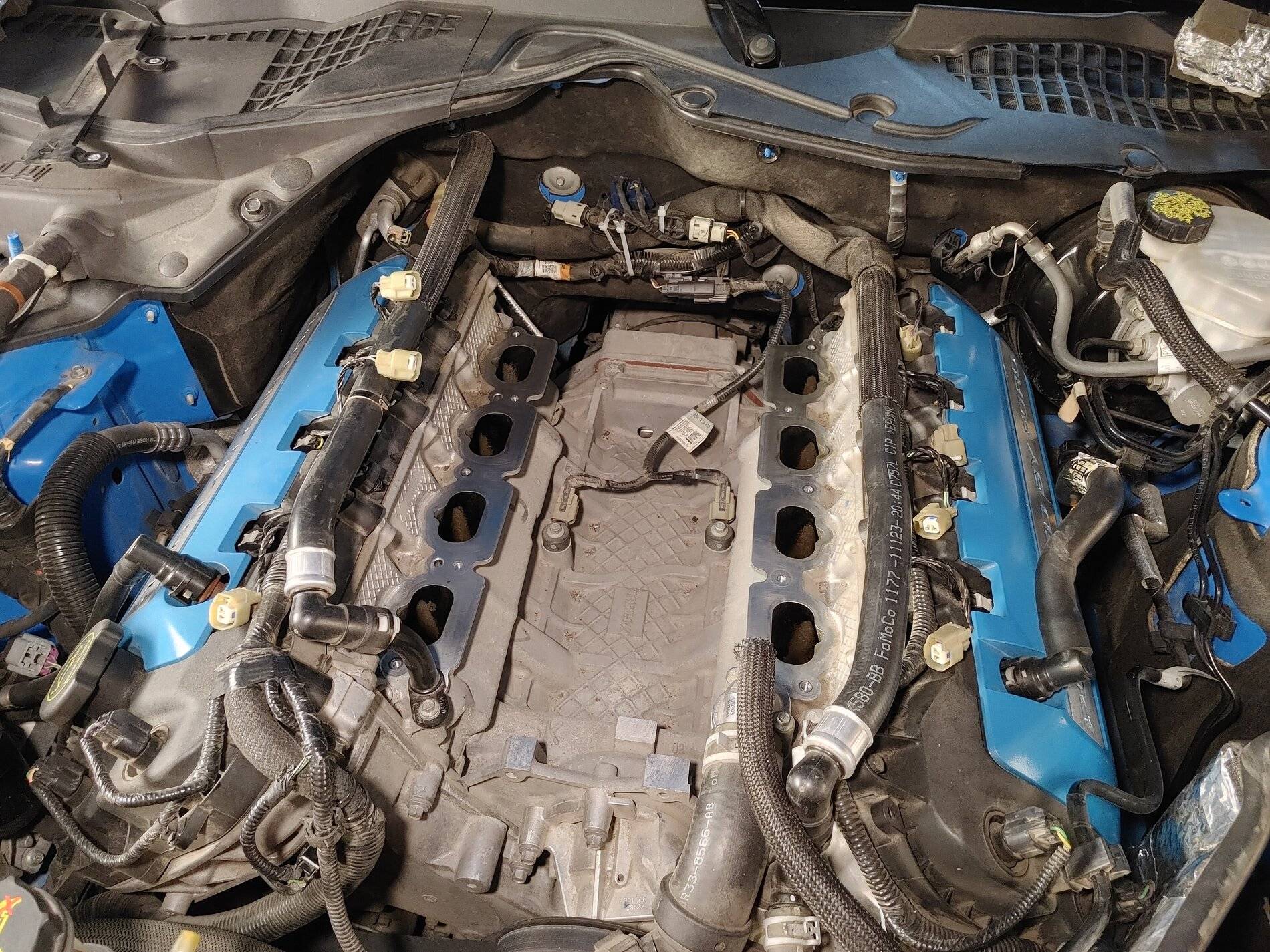

My tuner has me chasing a vacuum leaks. Told him there is none. I suggested high STFT cause I changed the intake manifold. Even the injectors look great.
WildHorse
WildHorse
N/A or GO HOME
Jun 28, 2017
270
10,297
8,350
Home World: CLASSIFIED
Puddintane
'17 S550
Everything back together. Smoked tested. Same as before. No leaks. Anybody have STFT comparison between the stock 15-17 and 18 manifold while still using the stock 15-17 injectors ?
K4fxd
Apr 2, 2020
121
13,455
12,262
NKY
Dan
2017 gt, 2002 FXDWG, 2008 C6,
I've got a comparison of the stock 17 manifold and a gt350 manifold.
No change using the stock 17 CAI and 17 TB.
