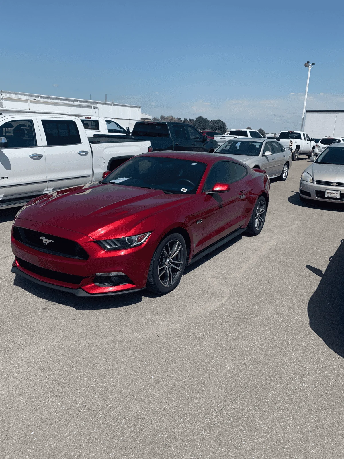

Finally picked up my new to me car today - 2017 GT base manual ruby red, 35K miles, still have 1,000 miles left of factory bumper to bumper warranty. I'm a little disappointed with the cosmetics - it needs some serious paint correction and touchup, much more so than I could tell from pictures. And some Kansas county cop gave me a $140 ticket for 6 over in a 65 (wtf). Otherwise I had a 9 hour drive home to feel things out and I have some questions:

Congrats on picking up a beautiful car!
Unfortunately, it sounds like you have to give this thing a once-over.

I am getting the sense that someone had some mods on this car and hastily put it back to stock before selling it...if so, the car will very probably be fine, you just have some work to do first. Keep us posted. Really, the car looks like it will be worth the trouble. Good luck!
