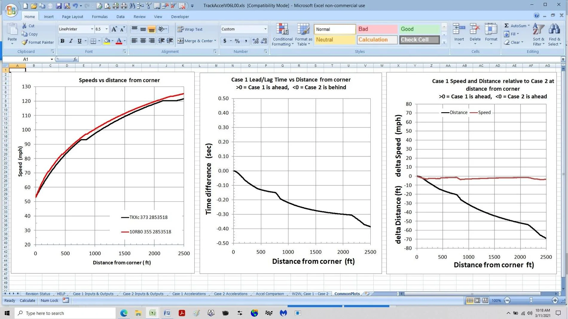

One advantage of getting a 2018 is that you don’t need a tune if you go with 4.09’s or higher gears instead of going FI. 2019+ cars need tunes for some weird reason. Great mod, I test drove a new 2020 PP2 and the first thing I noticed was that it was not as quick as my car.
I'm not convinced gears make the car actually quicker mathematically, but you definitely get more wheel torque which you feel in the butt dyno. But I have yet to see anyone do a back to back test after swapping gears on 1/4 times or something that would benefit in theory. Shifting isn't fast, so the more you shift the slower you're going.
Mathematically, gear changes apply a higher force to the road through the rear tires so it is definitely quicker. It’s the same reason the A10 is quicker than the MT 82 even though it shifts more, it’s just that the A10 mechanical advantage is in the transmission ratios rather than the differential. I saw one guy who said it didn’t help his 1/4 mile time because he had to make one more shift right before the finish line, but in real world driving it’s very noticably quicker than the 3.73’s. Some guys like them for autocross, they could probably list before and after times that show they make the car quicker in that environment.
Wheel torque doesn't equate to being faster though. A lesser wheel torque for a longer duration is the same in actual acceleration as a higher wheel torque for a lower duration. The A10 has multiple advantages, but it's shifting speed is also 800x faster than what a human can do and it sits in the power band until the ideal moment to shift to the next gear.
The A10 does not shift "800x faster" unless you have all the arm speed of a sloth. 10x an easy unhurried manual shift . . . that I can believe.
If you're going to use a math-based explanation, you need to do the full analysis, which would plot up something like this.
