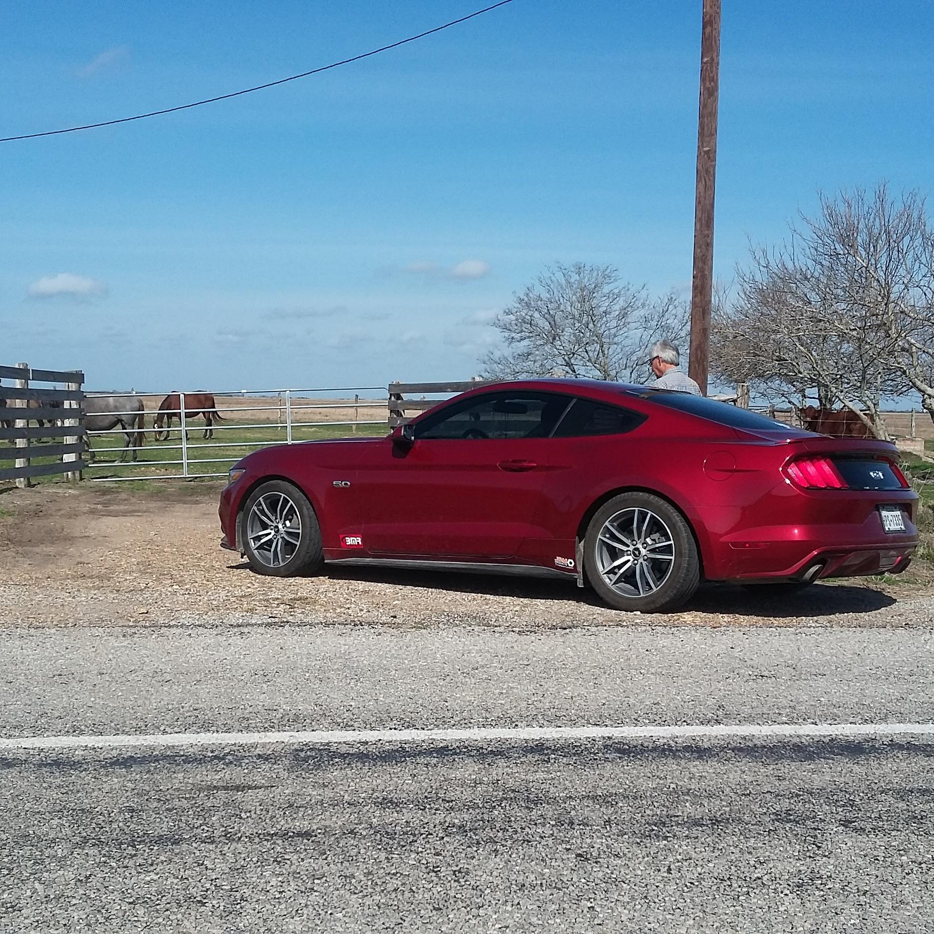

My build is coming along nicely with the help of CB005 & 06, I'll do vertical links next.
