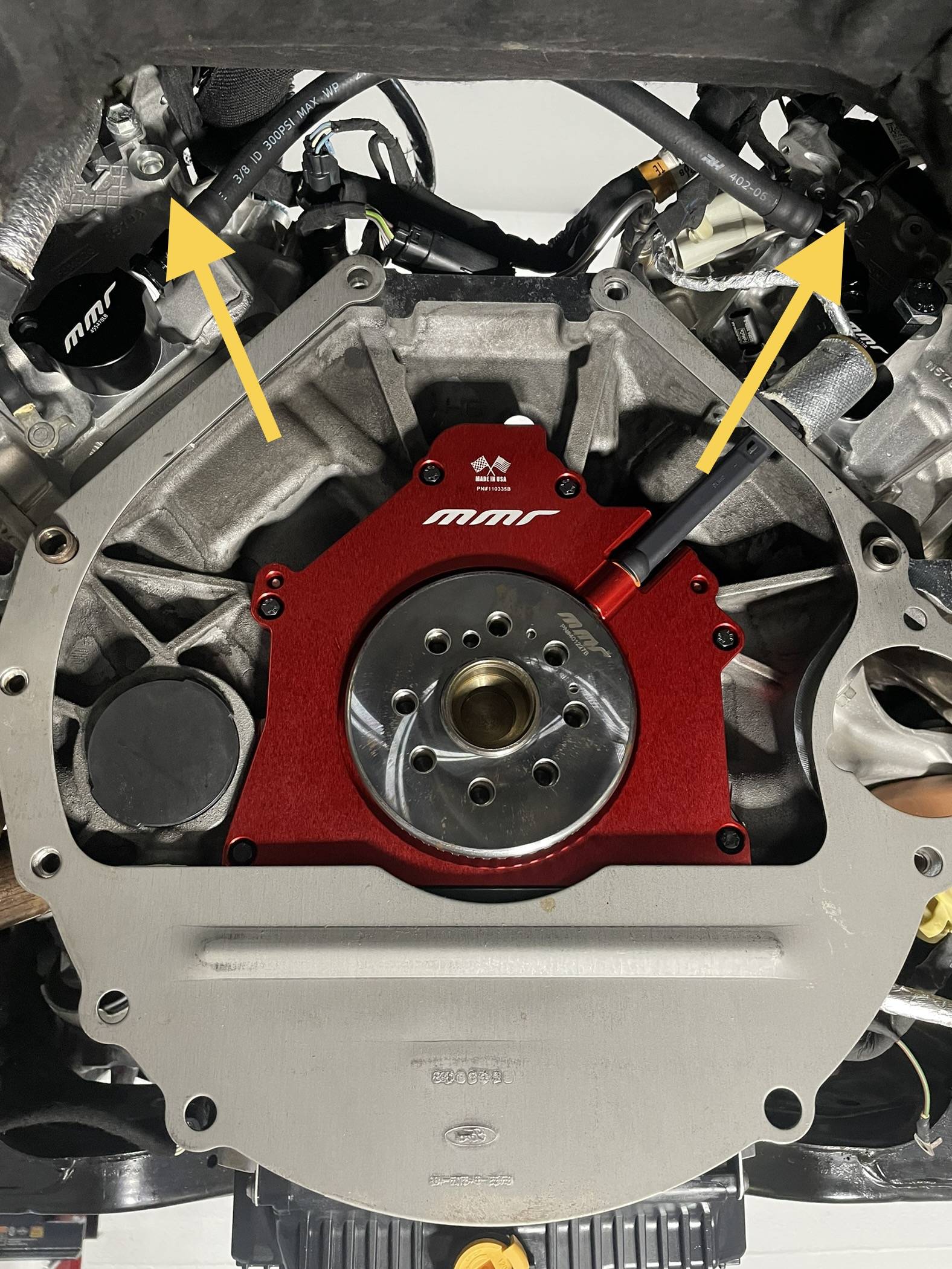

See the yellow arrows in this pic which are pointing to the locations of the mini freeze plugs for the Head Oiling Mod. As you can see, even with the tranny out it’s going to be no bueno.
I think the oil cooling mod could be done if all 4 plugs were remove at the same time. On the oil plugs you would have to use a screw and a slide hammer to do it but it’s hard to tell from the photo if that would be possible and you run the change of small metal shavings from putting the screw in the plug. Probably not worth it.
That’s sharp thinking, but unfortunately, there’s just not enough room to remove the mini plugs. The photos may give the illusion that there is enough room, but that’s just not so. A drill and slide hammer won’t even fit. It’s definitely not worth the risk of trying with the engine in the car. At the very least, the heads will need to come off in order to install it.
Man that does loom tight, but, I worked fighter jets, cargo planes for 23 years, I will at least try until I raise the white flag lol. Thanks for your help.
