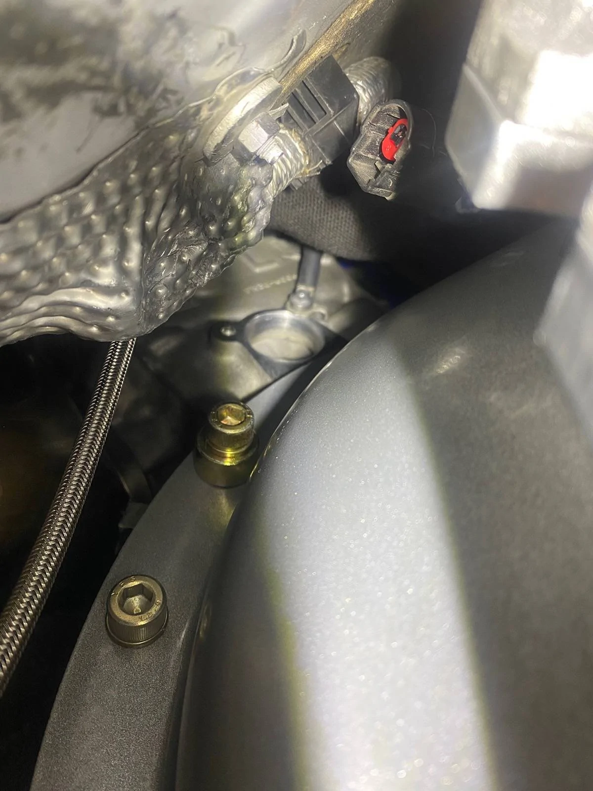

To the guys and gals running a head coolant crossover, did you relocate the engine ground? Crossover fitting on driver side head won’t sit flush unless I mill some material off them or relocate the grounding strap

Yes, I relocated the ground to an area close by.

Seems like here could be do-able just have to get a bigger ring terminal. Hmm. Don’t see anywhere else being a better option
