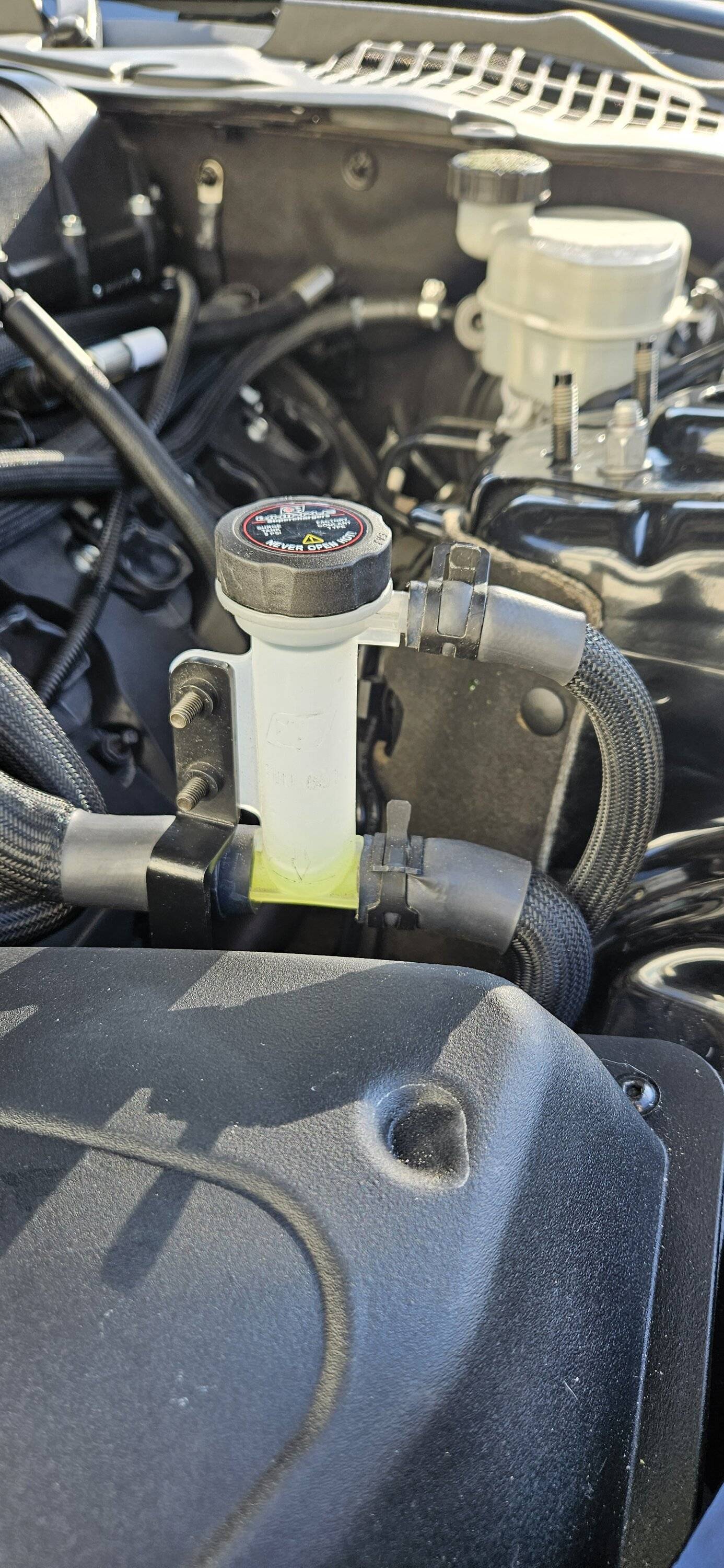

Hey guys. I just bought my whippled gt about a month ago. I can hear the intercooler pump kick on with key on after a few seconds. But no matter whether it's hot or cold it never goes above what you see in the Pic. Is this normal? I see the hot fill line but it always just hangs out down low. Running or not.

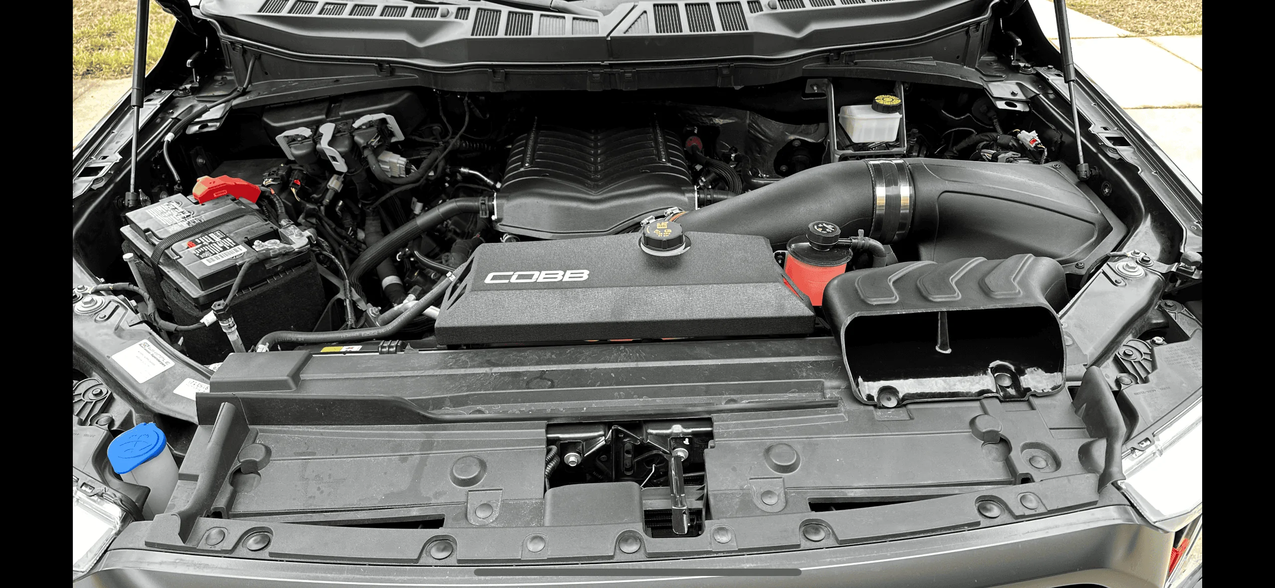

Have you added coolant? I know on my F150 the tank was bigger but even running it stayed up near the top.
‘My GT350 stayed about mid level

Have to open the cap n see where it’s at. If it drops then add more. Sometimes it come up. All depends on the pressure build up

when I open the cap it goes to the top with key on but not running. and I have to put cap on before it spills out.

Oh. My bad. Key off and not running.

The IC fluid expansion is much less than engine coolant. Because of the lower temperature range.
