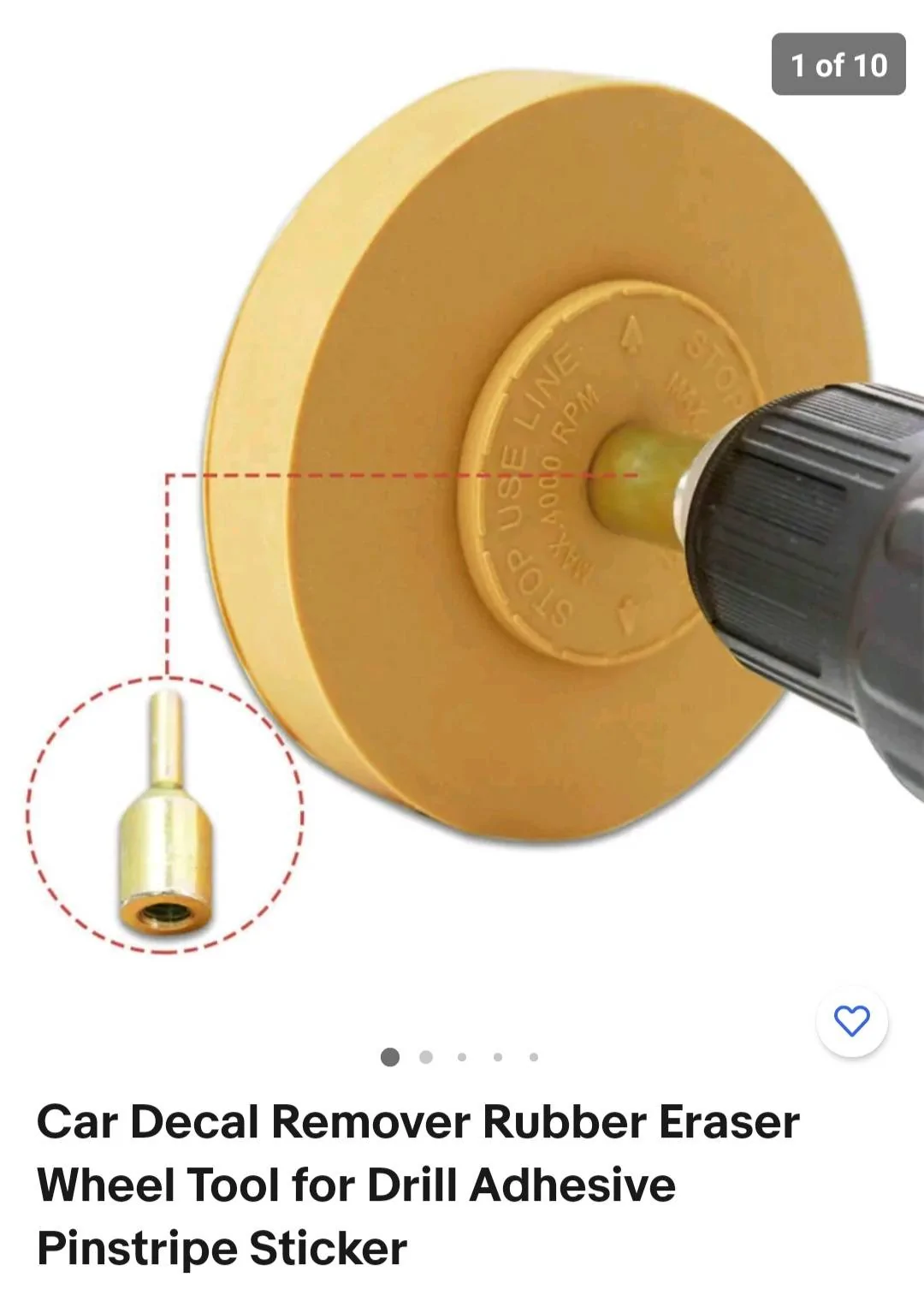

21 Rapid red metallic GT here. Just added the new GT500 spoiler w Gurney flap over weekend. While removing the old 3M tape from blade wing that came w car I ended up using this rubber eraser on my drill. Well, I got the 3m tape off, but now it seems I have the deep yellow swirl marks in paint that meguiars wax could not remove.
These round yellow marks are under the GT500 wing and cam be seen. I'm trying to figure out how to get them outta paint.
Can anyone help me? Any ideas on what to do or use?? I hope I didn't burn the clearcoat.. ughhh!!!

The factory adhesive is incredibly strong and the yellow stain you are seeing is most likely the pigment from the adhesive. Since it didn’t come out with wax and are still bothering you, I would definitely go a little further with either a polish or a compound, then rewax that area to protect it. If meguiars is your brand of choice they do have good products for polish/compound. Give it a shot.

Thanks for reply, Crew. I think the pigment is the yellow eraser. I got all the 3M tape off, nice and clean. But the yellow is still there. Aggravating me, i can see it!!!

You mentioned wax, that won't remove paint defects, or in this case residue, you will actually protect it with wax. The Meguiar's compound should deal with it though. The compound will remove any remaining residue and level the finish down to match the surrounding areas. It will also be likely that the rubber eraser wheel (I hate those things) has created some marring anyway, so using compound is probably going to be needed anyway.

Those eraser wheels are worse on the paint than washing the car every day for 5 years.
