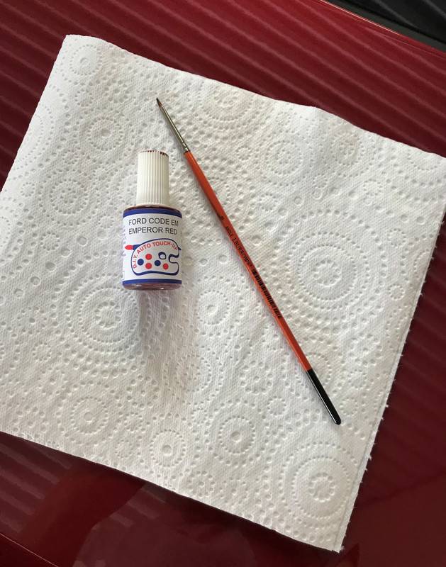

With rock chips, the aim is to "fill" them rather than "painting" them. I use a small artists brush to "drip" or dab paint into the chip. You can use a toothpick or syringe to do the same thing. The key thing to consider with paint touch ups is patience.
Have a look at this video for techniques -
