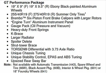

The PP also has a Torsen diff, not just 3.73 gears

I have PP & Roush blower, 3:73 gears have not been an issue for me. The Torsen diff and PP tire package allow the car to hook-up really well. 2nd gear WOT from 3K RPM, the rear wiggles a bit, squats and just hauls......very addicting.
You will lose the strut brace with a FRPP/Roush blower.....BTW.

I can save you some $, as I just put mine up for sale.
Go Performance pack, although you might eventually change gearing to the 3.55's with the SC'er. The breaks on my PP are almost every bit as good as my 350. The larger radiator is almost a must with the elevated temps of the SC'er also.

There should really be no second guessing the performance pack unless you want an auto or a strictly drag car, otherwise it's worth it in every bit. I just did my 4th mountain cruise with it yesterday since having it in June. I just hit 4000 miles and let me tell you, the car is amazing. I haven't upgraded anything other than the wheels. The car handles awesome on the curvy roads.

I want a manual for sure. I enjoy shifting. I guess I'll have to deal with the issues if they arise. Wonder why ford just doesn't use the tremec. It sounds as if I should get the track pack.
Is there other chassis stiffening items besides the strut bar?

it says unique chassis tuning... I was wondering what that was. just shocks and springs?
I'm not trying to be a dick but there are probably at least 4 20+ post threads on this subject in the past few months that have TONS of info on the package and what it is. PP has bushing upgrades, you have different shocks and struts and the word "tuned" is probably in relation to those things.

A f*cktard's (me, not you) guide for whether or not to buy the PP:
1. Do you intend to replace most of the components listed in the PP with better aftermarket pieces?
If yes, don't buy the PP. If no, continue:
2. Are you a cheap ass who wants the lowest purchase price possible and can live with the base model parts?
3. Do you intend to build a drag car, and specifically want the gear ratios and lighter weight of the base model for this purpose?
If yes, don't buy the PP. If no, buy the PP.
