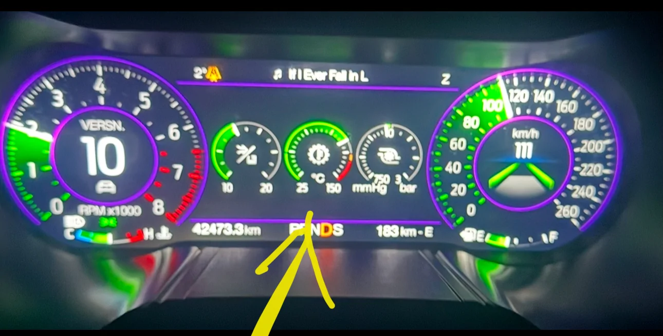

Here a pic about a Mustang Ecoboost, 10 speed transmission was replaced under warranty, way to high temperature .
