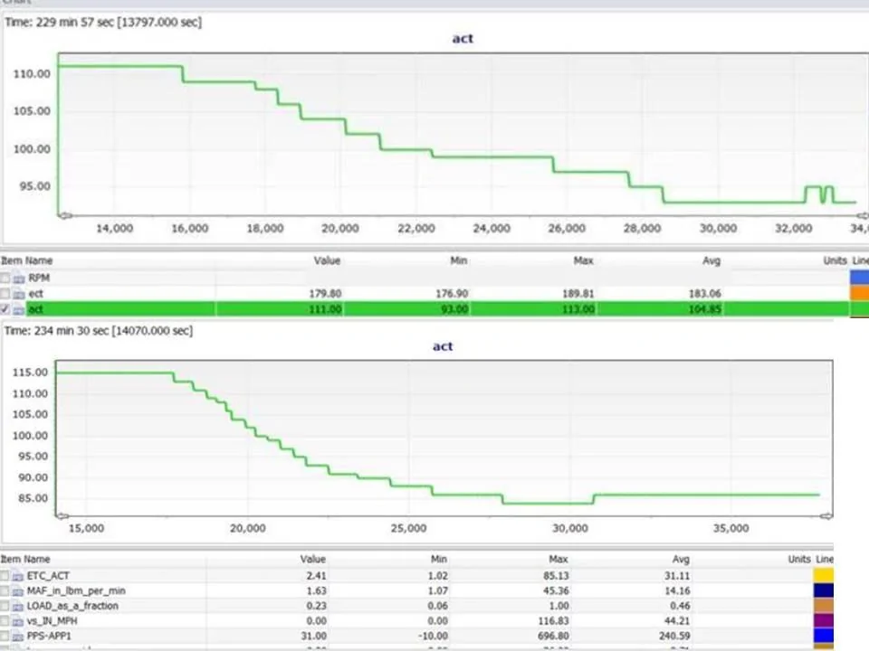

I datalogged a quarter mile run a couple weeks ago. Ambient temps were 55. IAT was showing 115 in staging lanes. After my burnout, 95. After my quarter mile pass, 58. This was with my Roush CAI. Just goes to show how fast an open CAI can heat up, but cool right back down.
rite on. im thinkin if my car pulls a little timing in first gear not a big deal by the the time im hooking in second the temps will be good.
