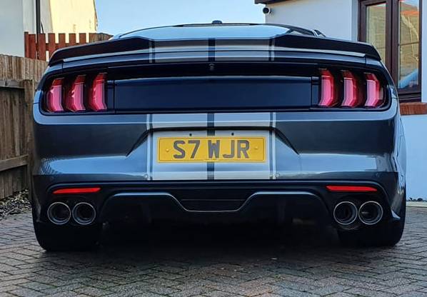

Hi, i changed my Roush axle backs (single exits) to 4 inch quads. I trimmed the valance as careful as poss, really pleased with the look.
