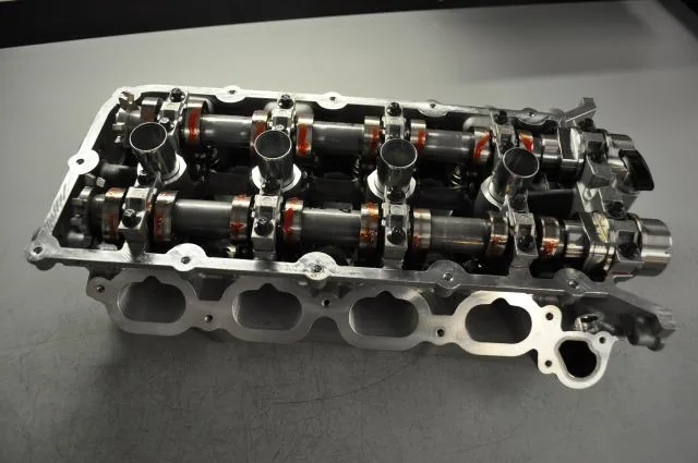

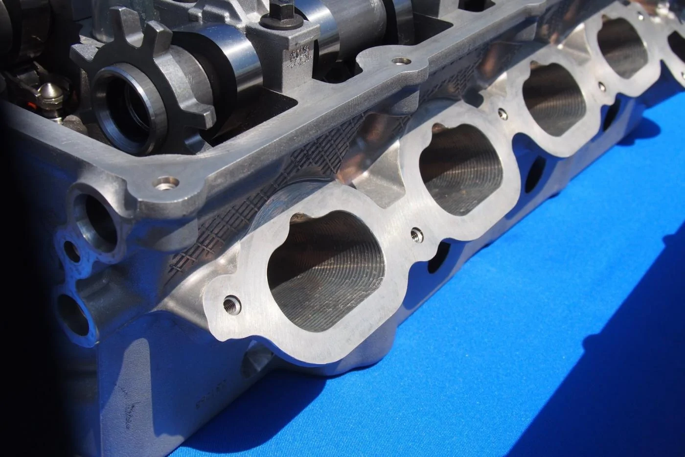

I know the boss and cj intake bolt up but they are not ideal for the 15. The 15+ will no doubt have its own FRPP intake developed utilizing the control paltes, Id say give it time as this is the first MY. The boss and cobra jet intakes didnt release until ~2 years after the 2011 came out
The 5.2L is still coyote based, as it has the same bore spacing and deck height. The cylinder head intake ports are the same shape as the coyote, I havent seen anything that seems like it wont work as of yet. The only question is if there is spacing difference between the 5.2 and 5.0 intake ports but they look damn close to me. Looks like a direct bolt up
5.2L heads
5.0 heads

Once people get their hands on some 350's I assume we'll find out what's what. I don't know anybody that's seen the motor up close and compared it to our coyote.
