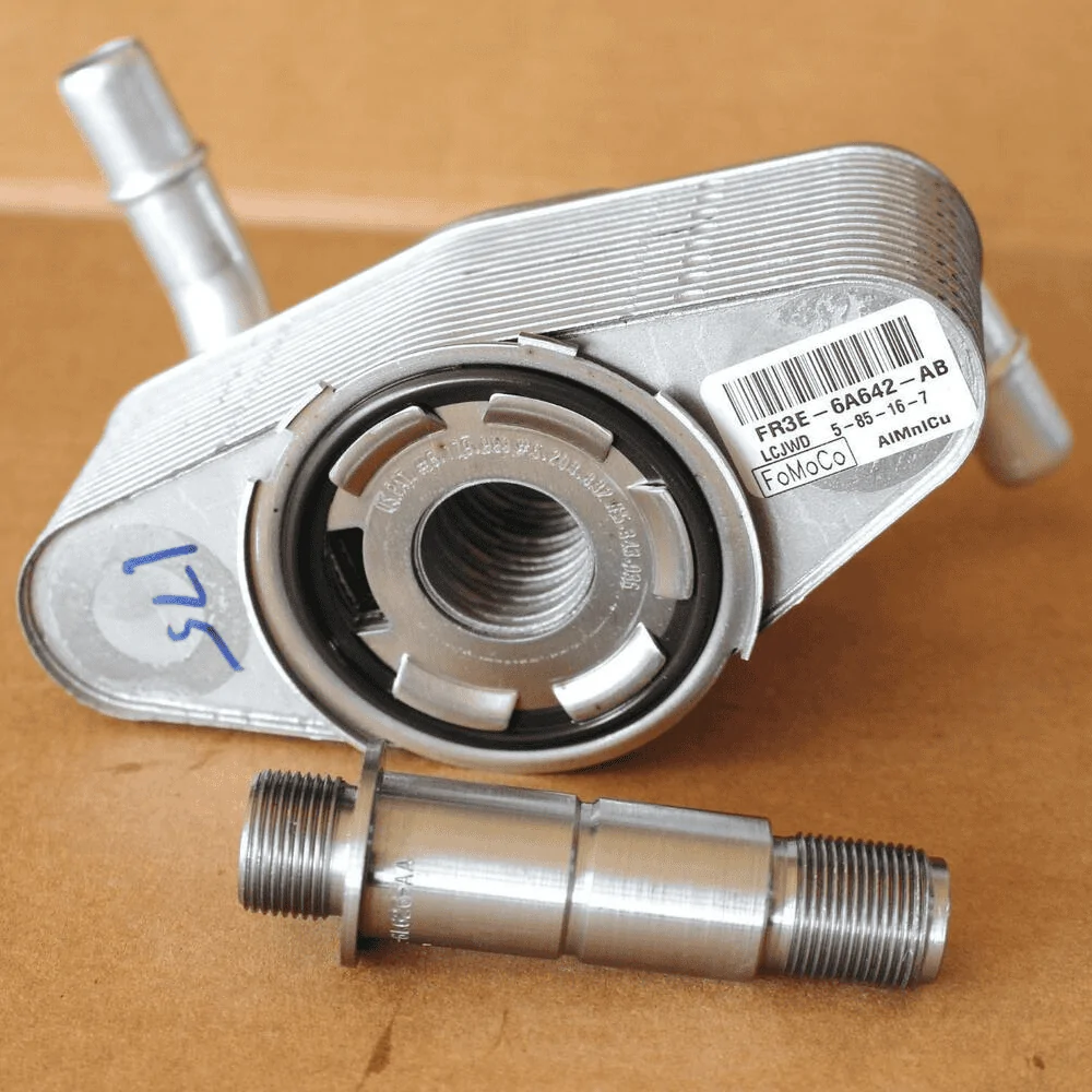

Good morning folks. I wanted to run car up to temp before i left for work (in storage for winter). Oil started dripping/puking out from driver side near oil filter. Lost 2 quarts in like 2 minutes before i noticed.
I had to leave for work before being able to get it jacked up or on ramps. did the oil filter gasket maybe blow out because it was cold/high pressure? what would cause this. is there an oil cooler or something else located near there?
stops leaking when not running, or leaks more slowly

There is an oil cooler there by the filter. A filter gasket is the easy button fix, so it's probably not that.

Oil filter, oil cooler, oil sender, or housing to block gasket

all gravy, there was a dent and hole in oil filter (facing up)
im thinking when they did the headers they hit it with something without knowing. 800 miles it was fine. sitting cold and then starting with high pressure popped the weakened part.
swapped filter and topped off with oil. good to go.
