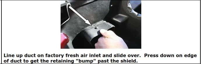

Just a PSA, when I was changing my oil this past week I was doing a once over and noticed my snorkel to the JLT intake was pushed in. Apparently I was a :headbonk: and did not ensure it was pushed all the way forward till the stubbed point was on the outside of the box to keep it in place. The snorkel was pushed back about halfway into the box. After re-positioning the results were pretty dramatic:

I'd be interested in seeing these one's that have warped.
They shouldn't be able to change shape if they were fully installed over the factory duct from the grill, they are just a slip fit but do require some wiggling to get over it completely.

We added some retaining "bumps" to the tops and bottom of the ducts in June of 2015, I imagine you guys have the earlier ones. Either way good to see some folks being proactive :)
