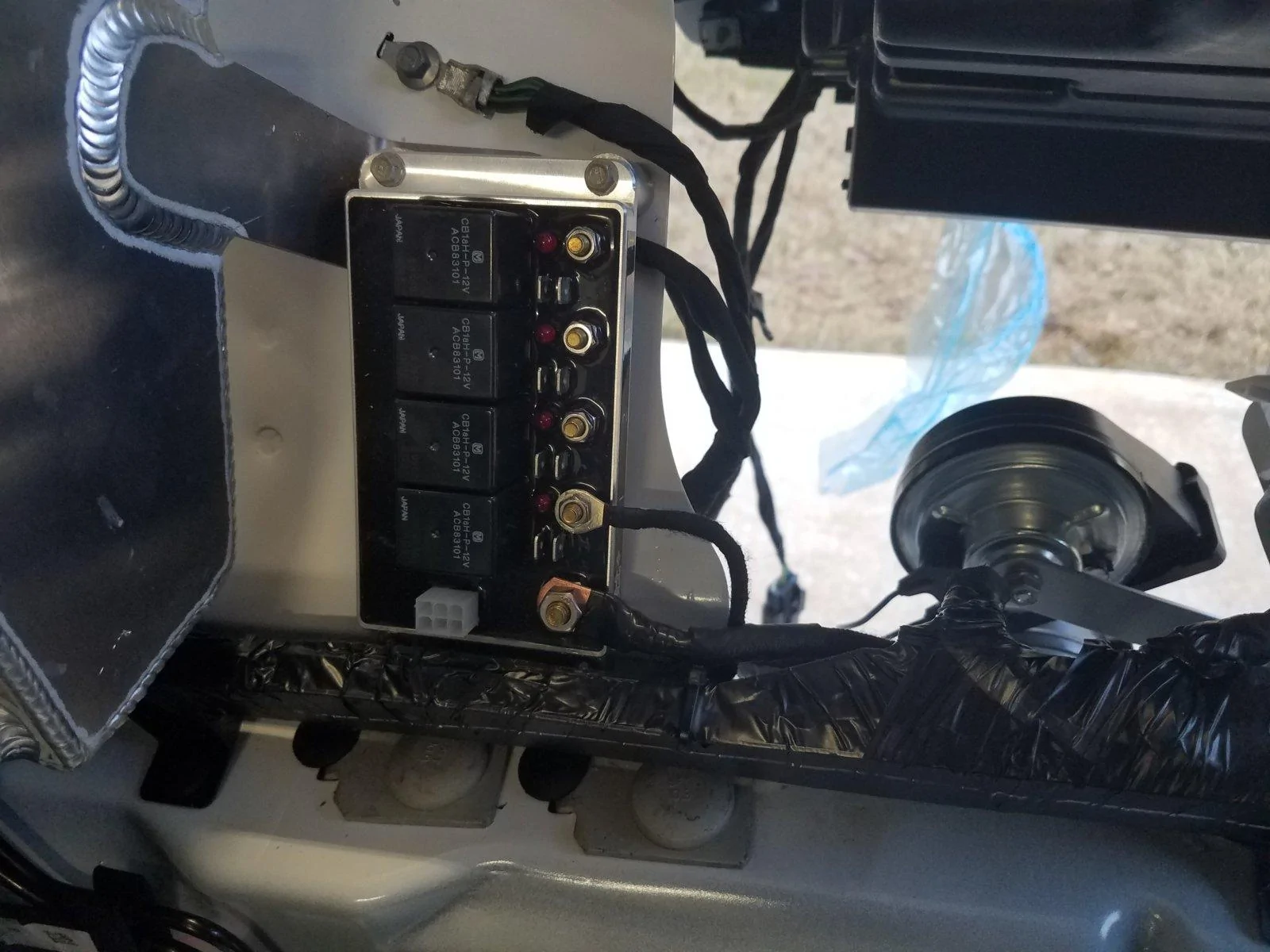

Damn man, that's an awesome build you have going. So your using those relay boxes instead of the fore relay setup?

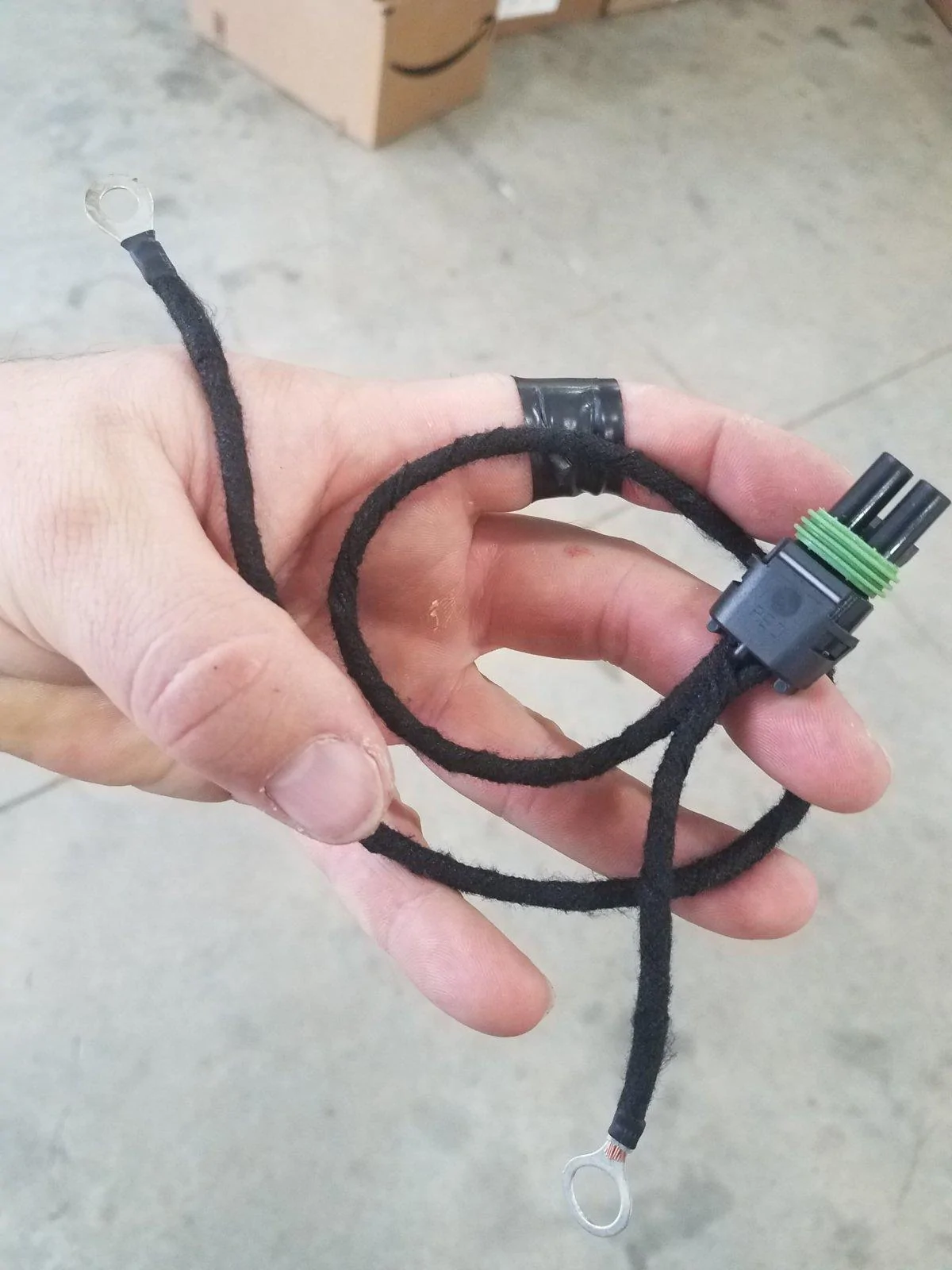

Sorry for the delay. Yep the one main pump that will run constantly is factory wired still since it does not exceed the amperage draw of the stock system. The other two pumps are wired into the panel and tied into a boost switch. For the front i have my electric water pump, oil cooler fan and hobs switch power wired up to the board. I have extra space on both for additional stuff I may run at a later date

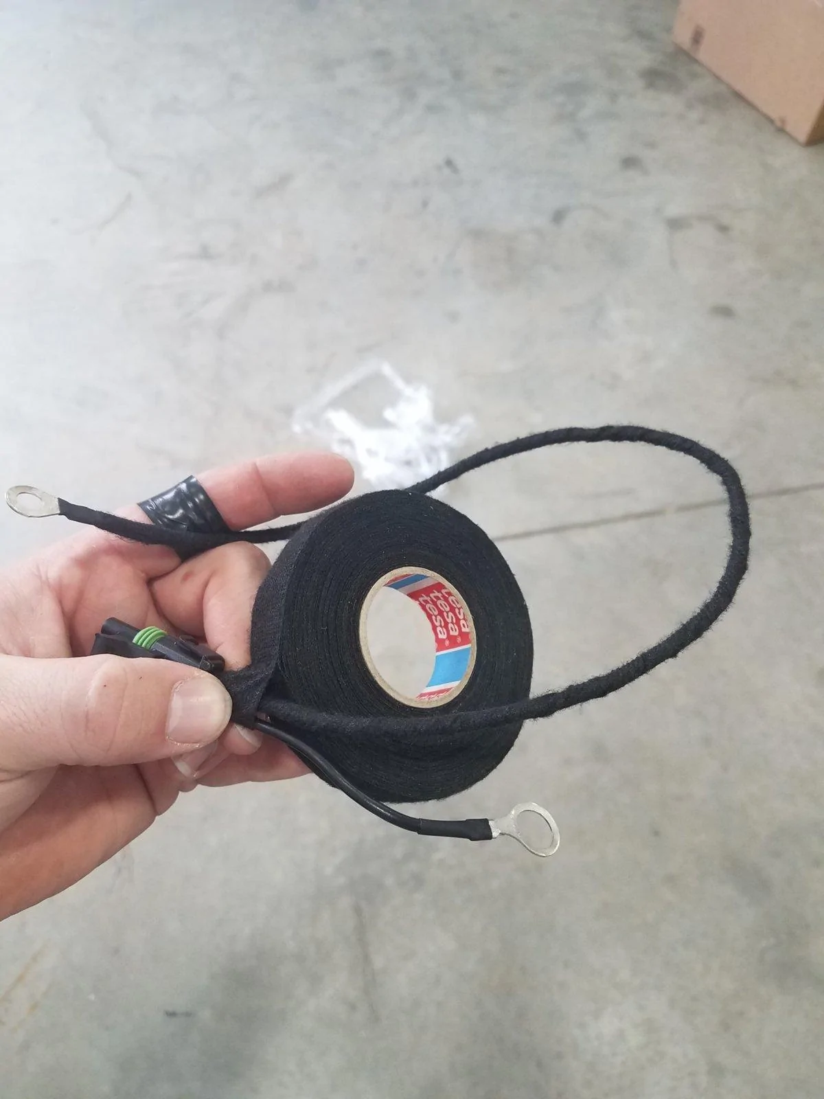

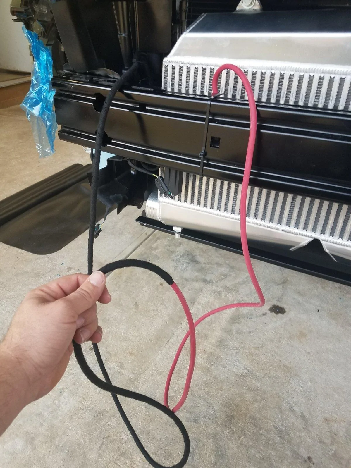

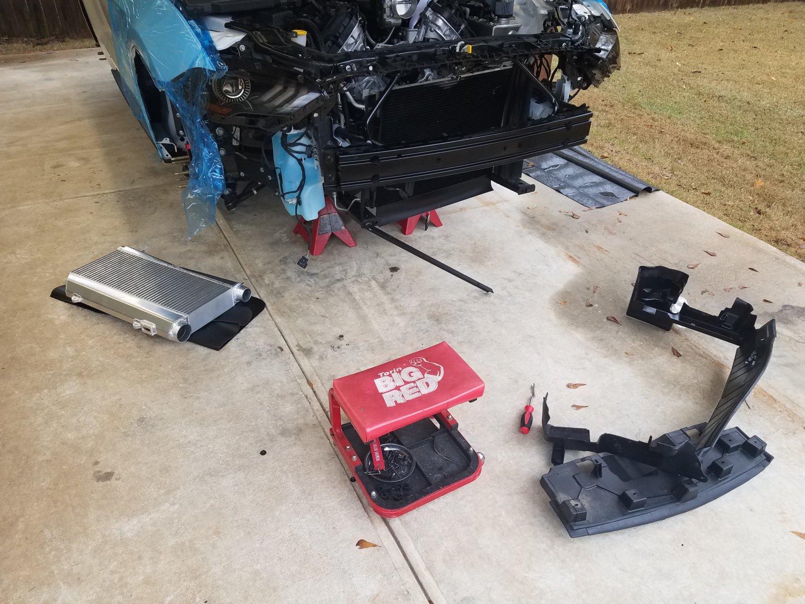

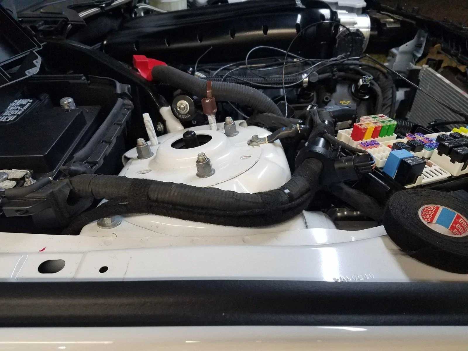

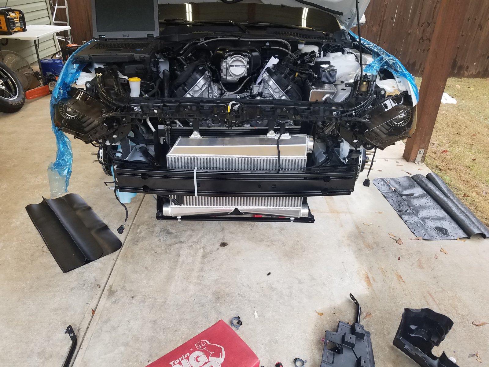

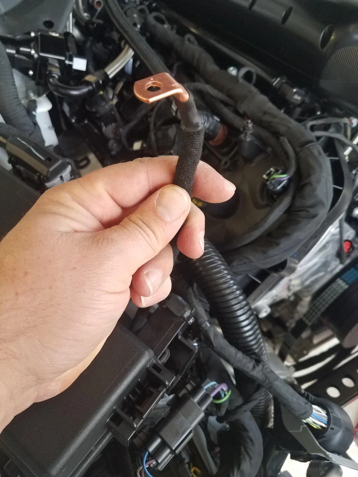

Did some additional wiring for a power supply for my front mounted relay panel as well as mounting the front intercooler. Also took the time to wrap everything in cloth tape to give it the factory look.

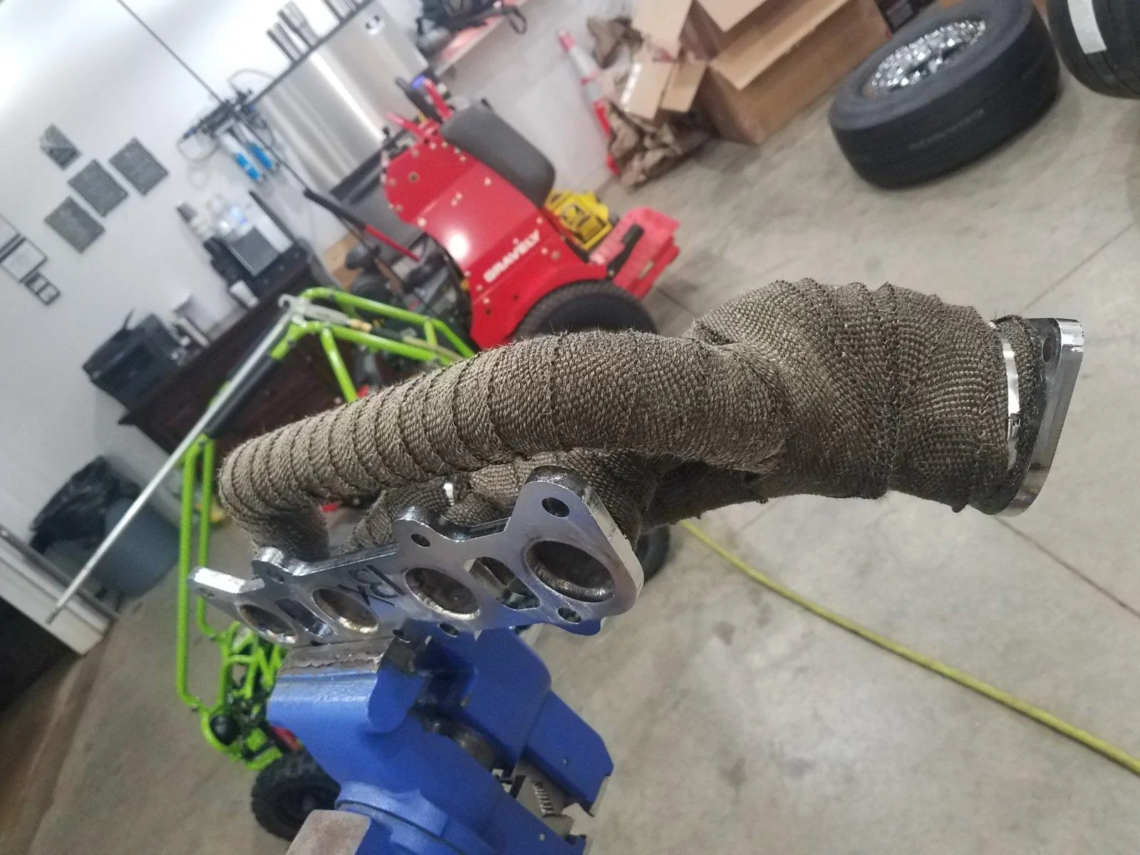

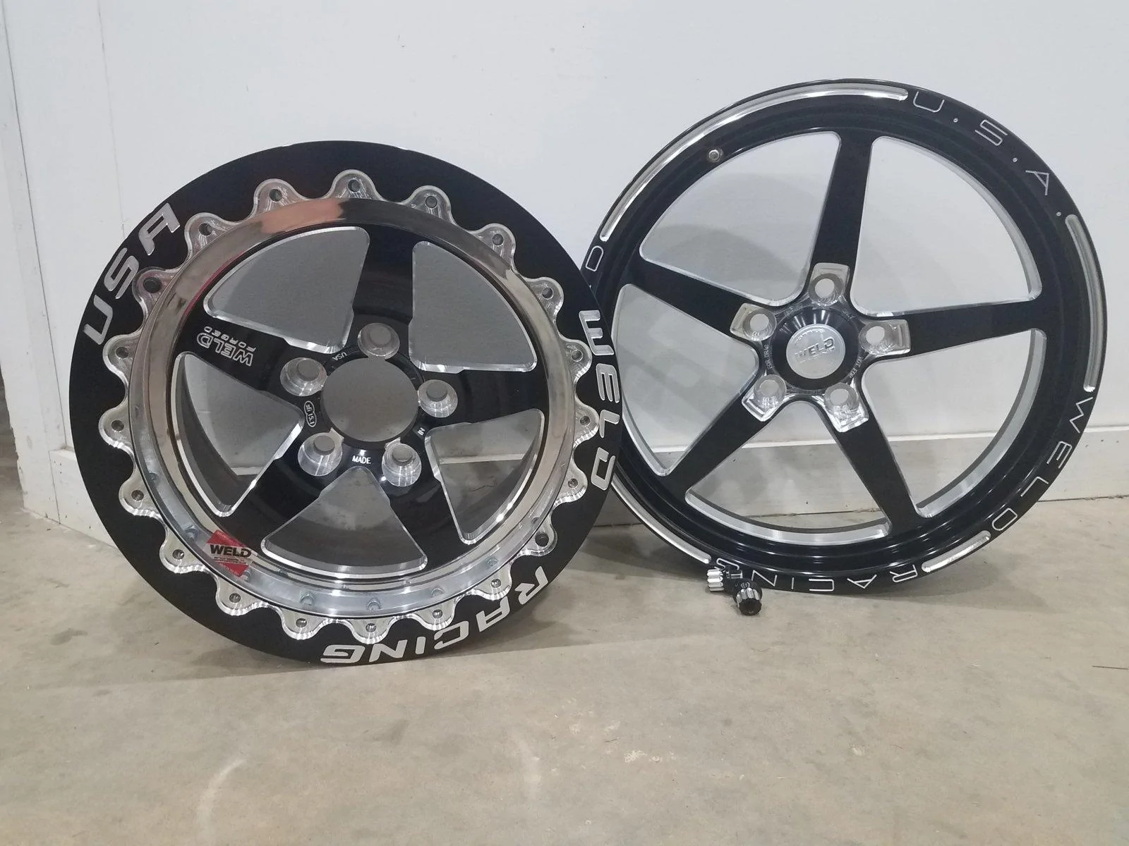

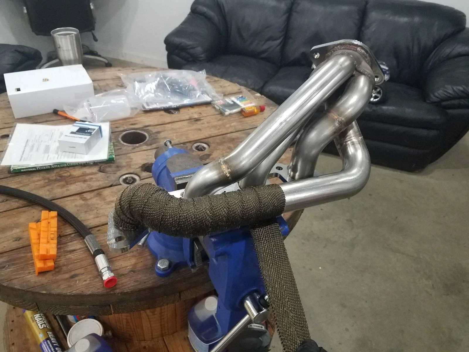

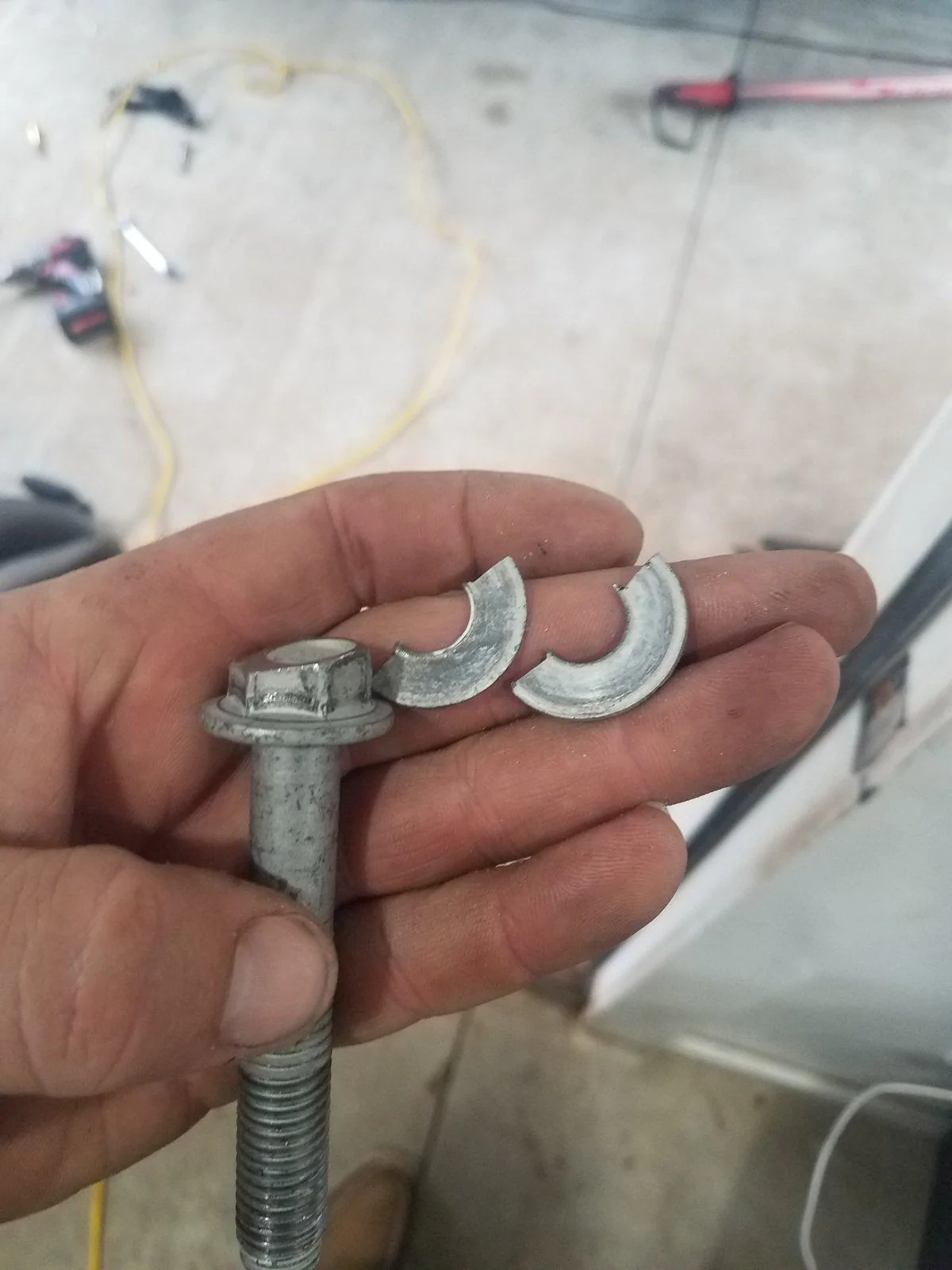

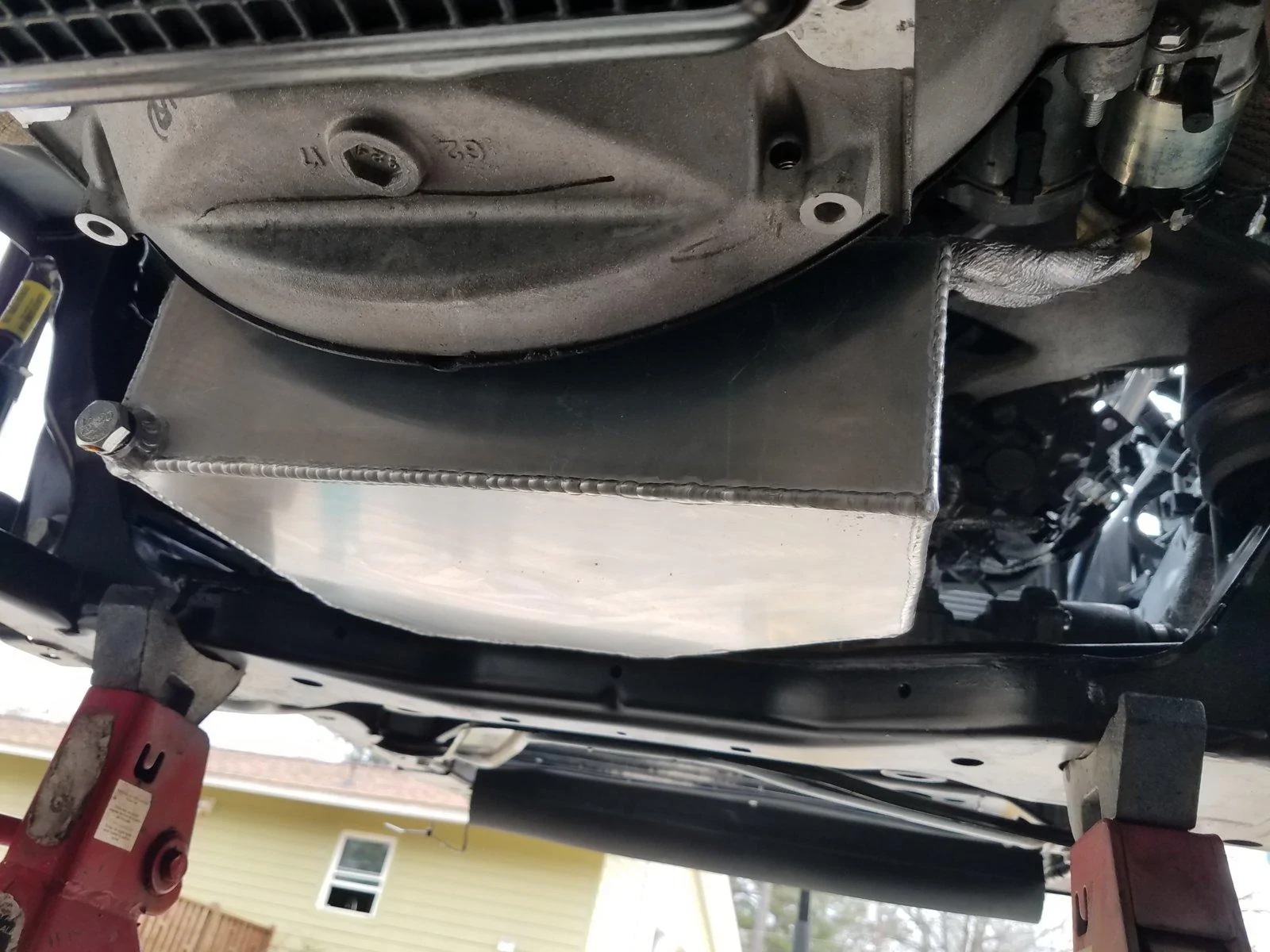

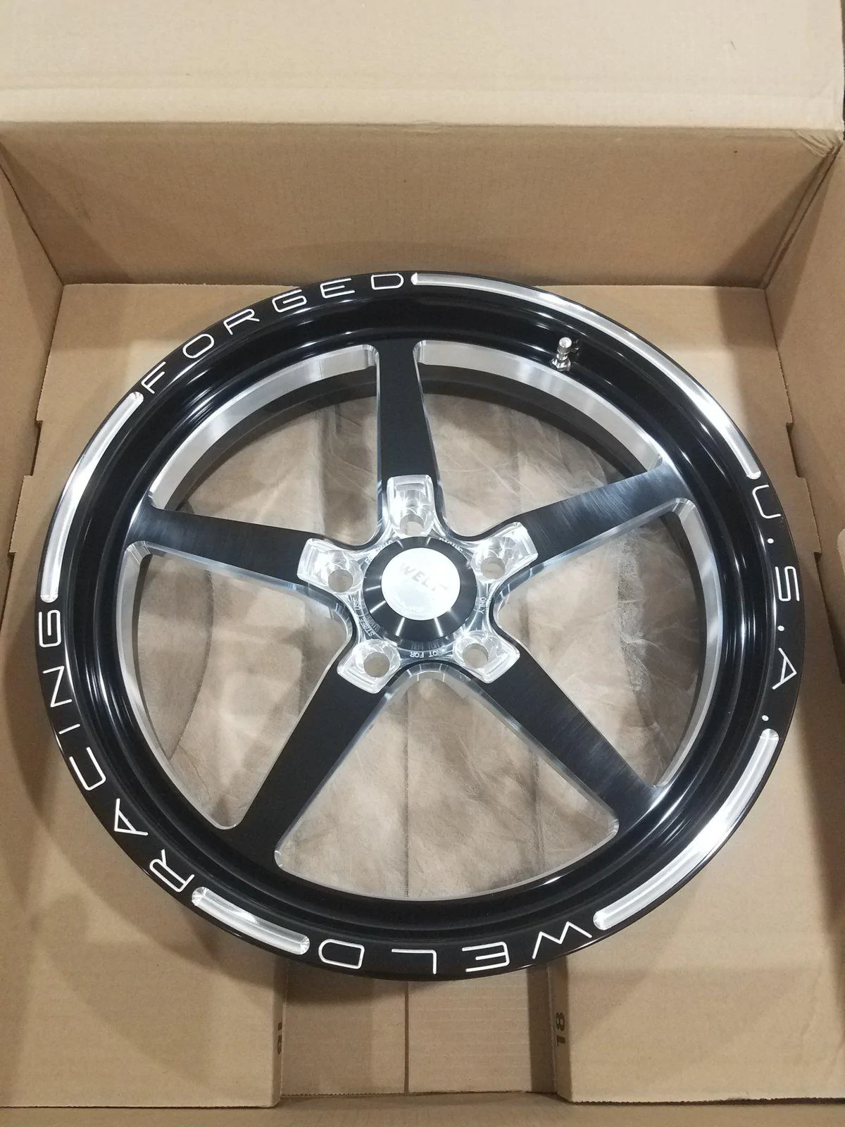

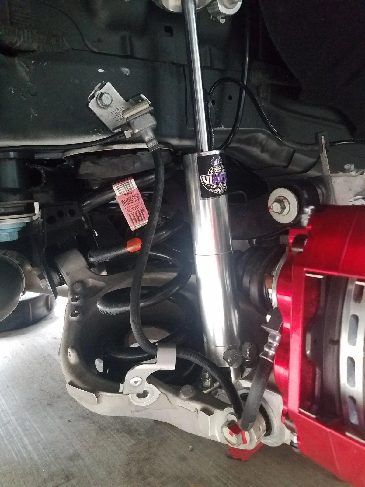

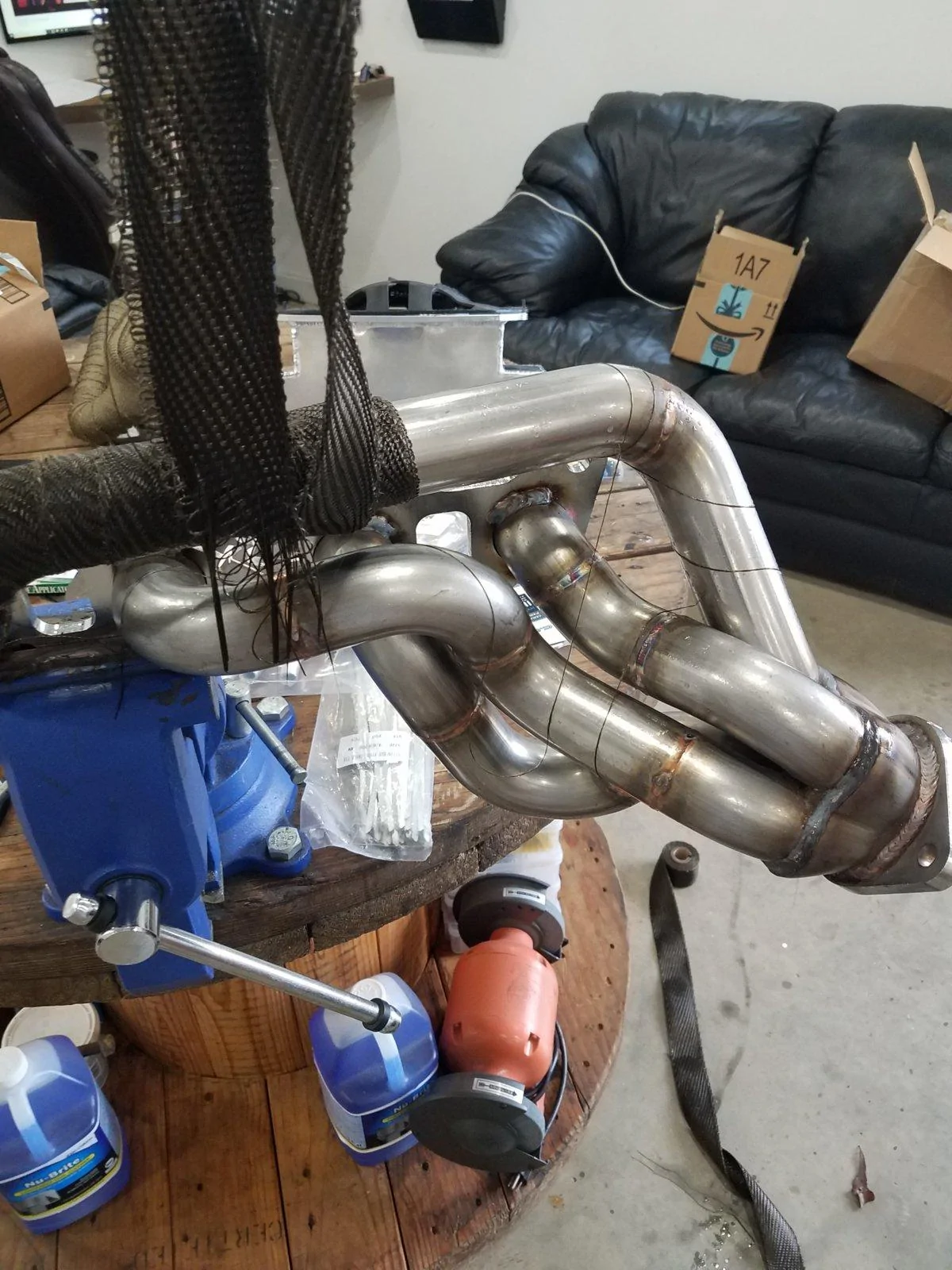

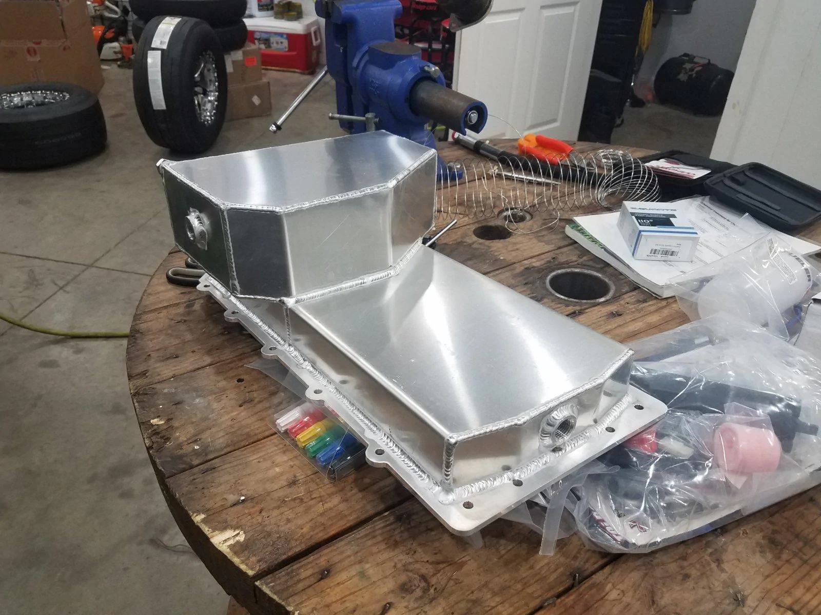

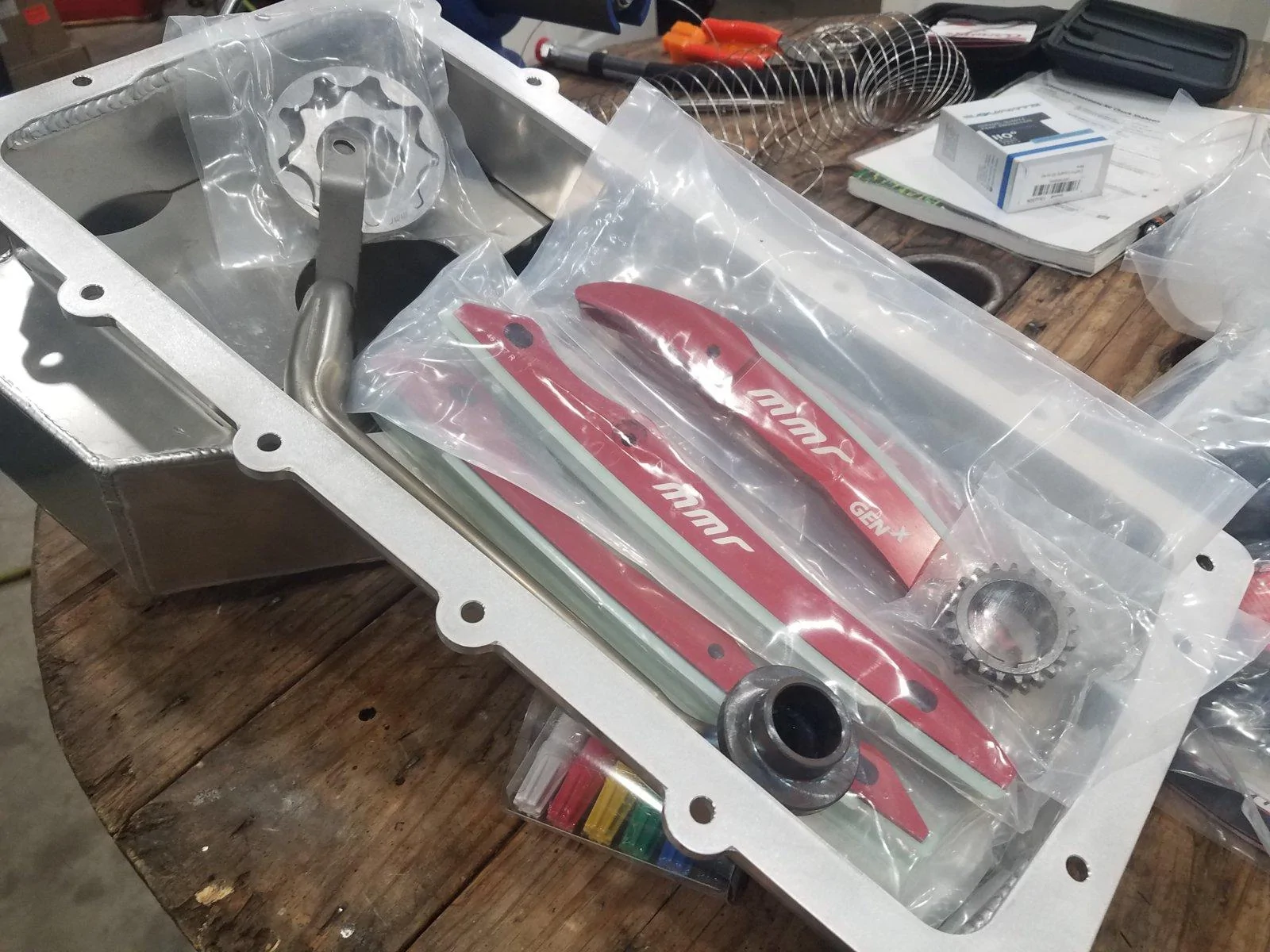

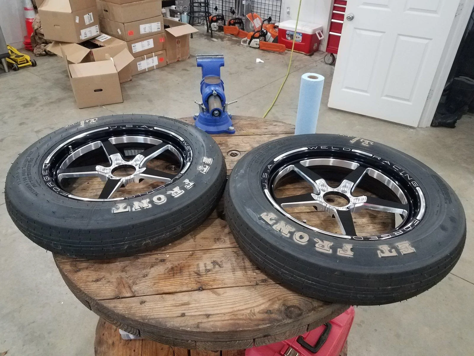

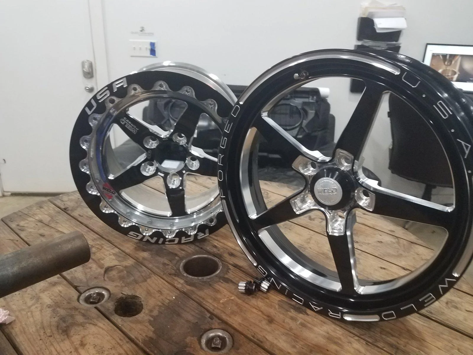

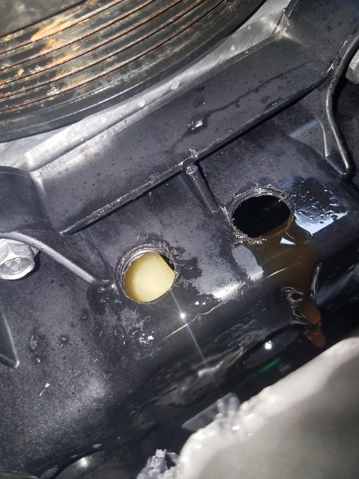

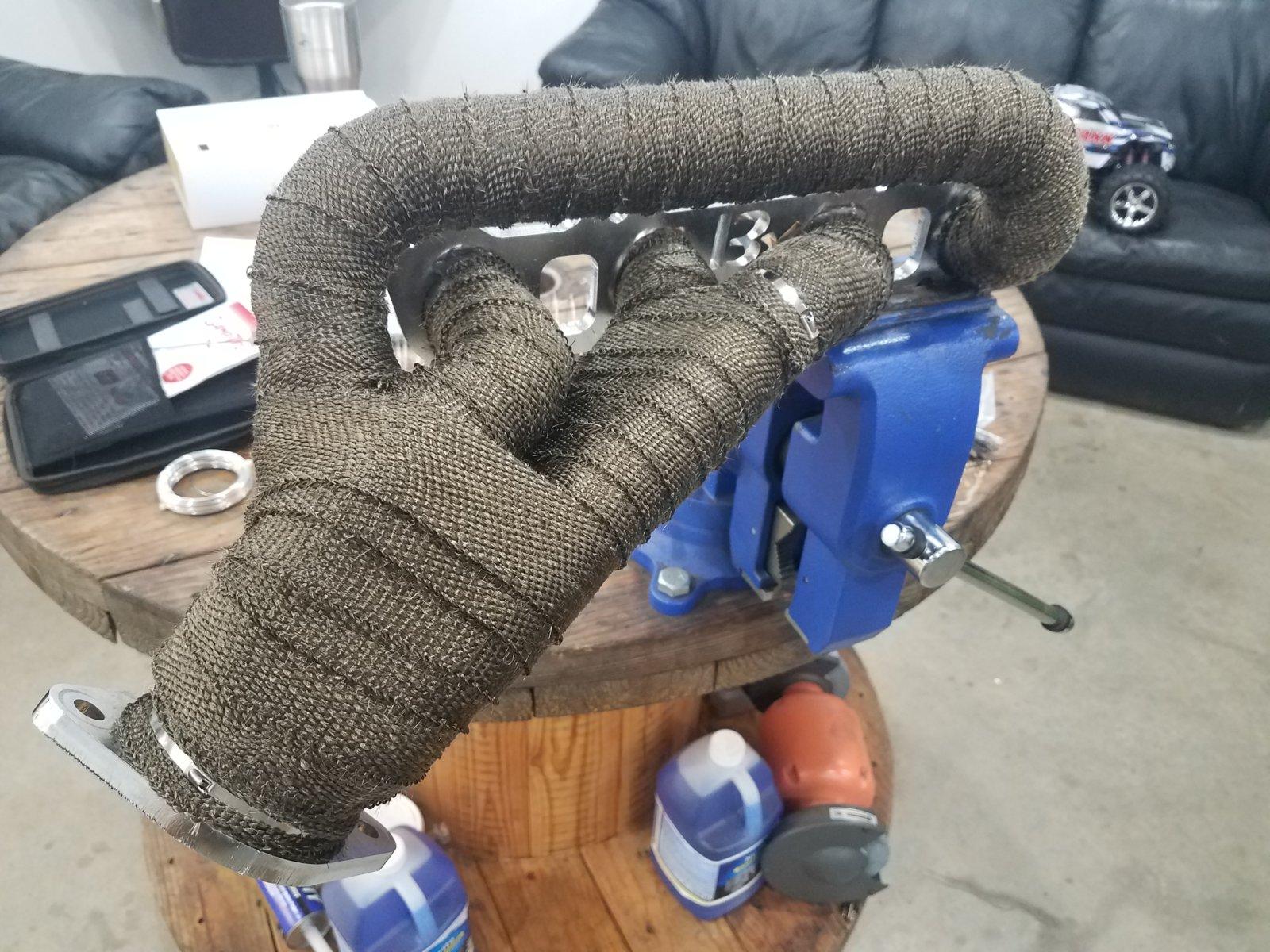

So when i first bought the top mount setup from hellion, i had no idea they utilized a sump pump. Thats why i went with the top mount over the street sleeper kit. Of coarse hellion did not give any details on their kit so i had to find out by buying it. Anyway i am not going to run a sump pump. Totally against it. More shit to go wrong. More complicated. I tried drilling the front of the pan for two 1/2 npt oil drains for each turbo. I was not comfortable with the amount of material for tapping after I did so I ordered an aluminum pan and went ahead and did the opg's and guides. Also went ahead and ordered the new headers from hellion and got them wrapped. Also had to clearance a bolt for the new rims and got the shocks on. Btw, the exhaust wrap helluon supplies is fucking garbage. Just falls apart. So i order the normal kind i use off of ebay and got it done.

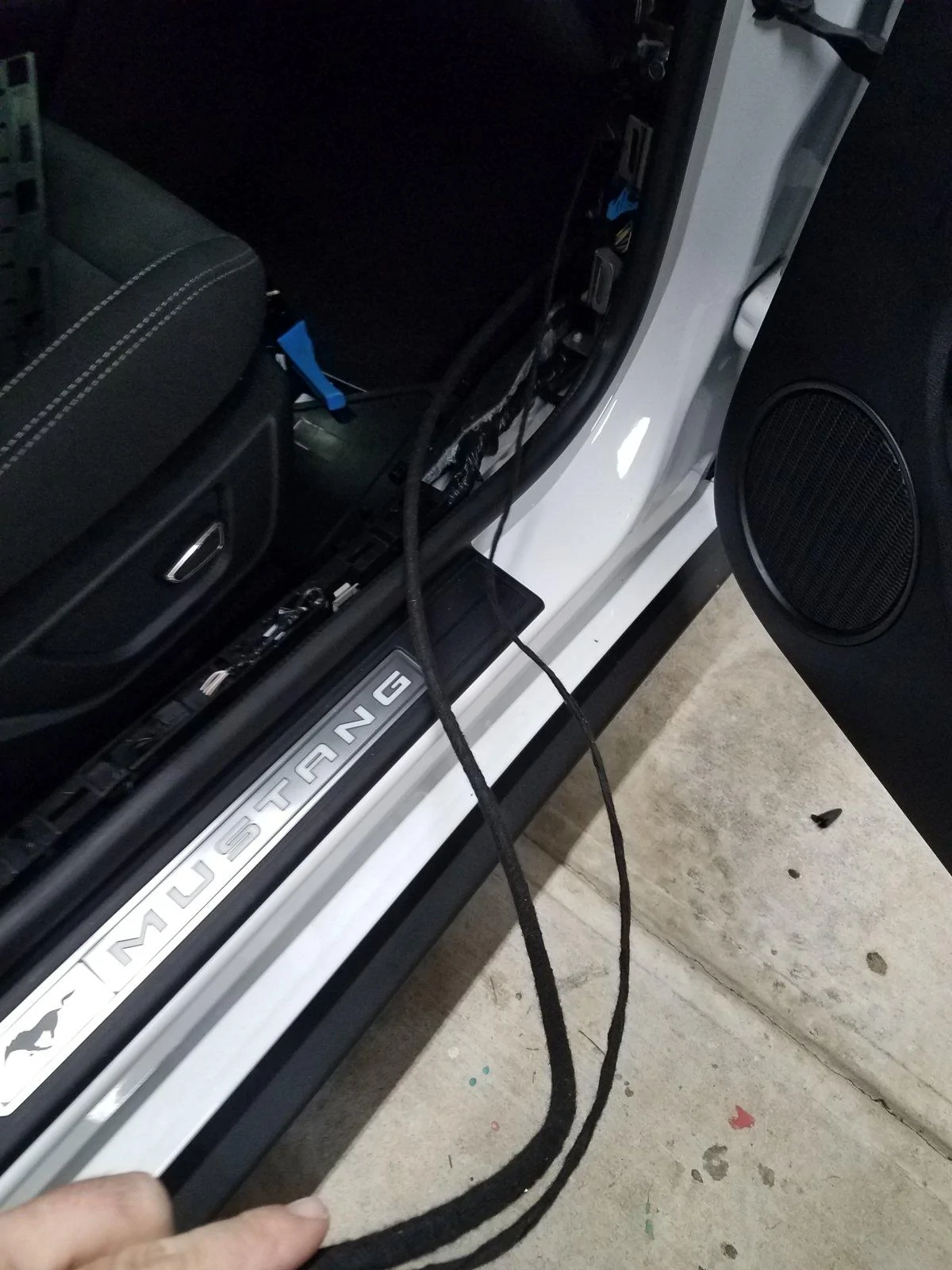

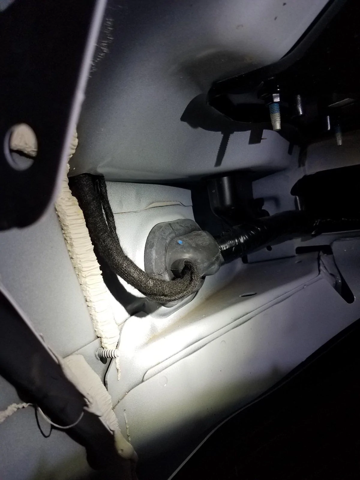

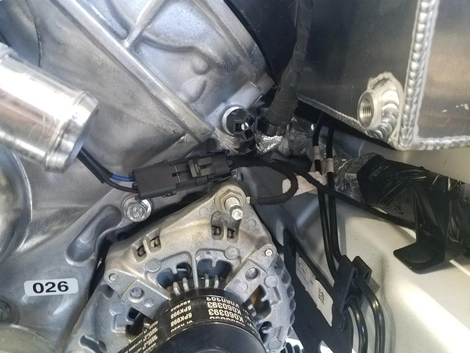

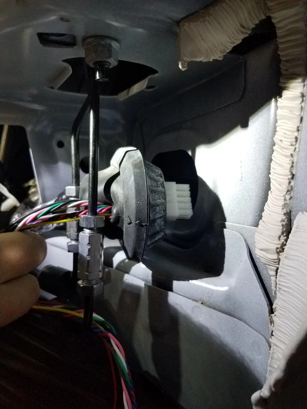

Oil pan is installed and went ahead and ran power to the back of the car for my relay panel. They had a nice spot to enter through the fender/firewall on the passenger side. Turned out real clean.
