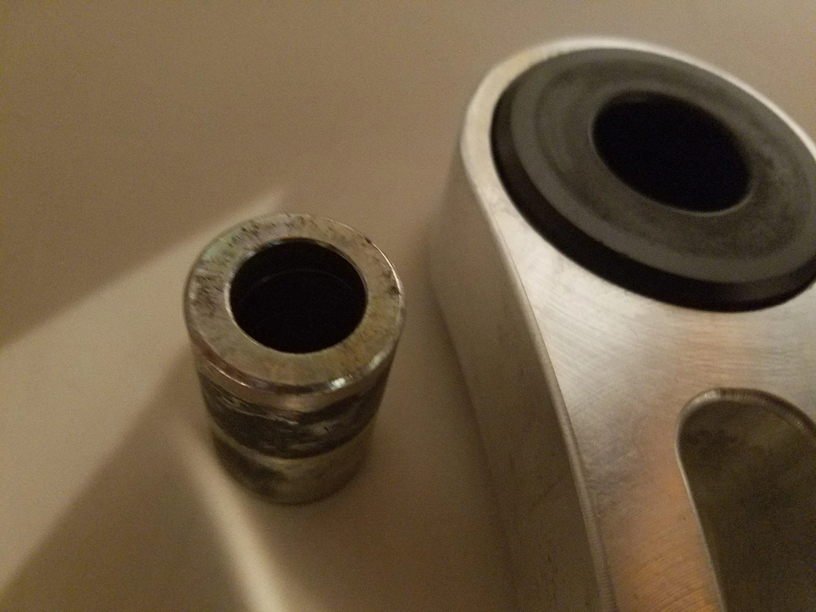

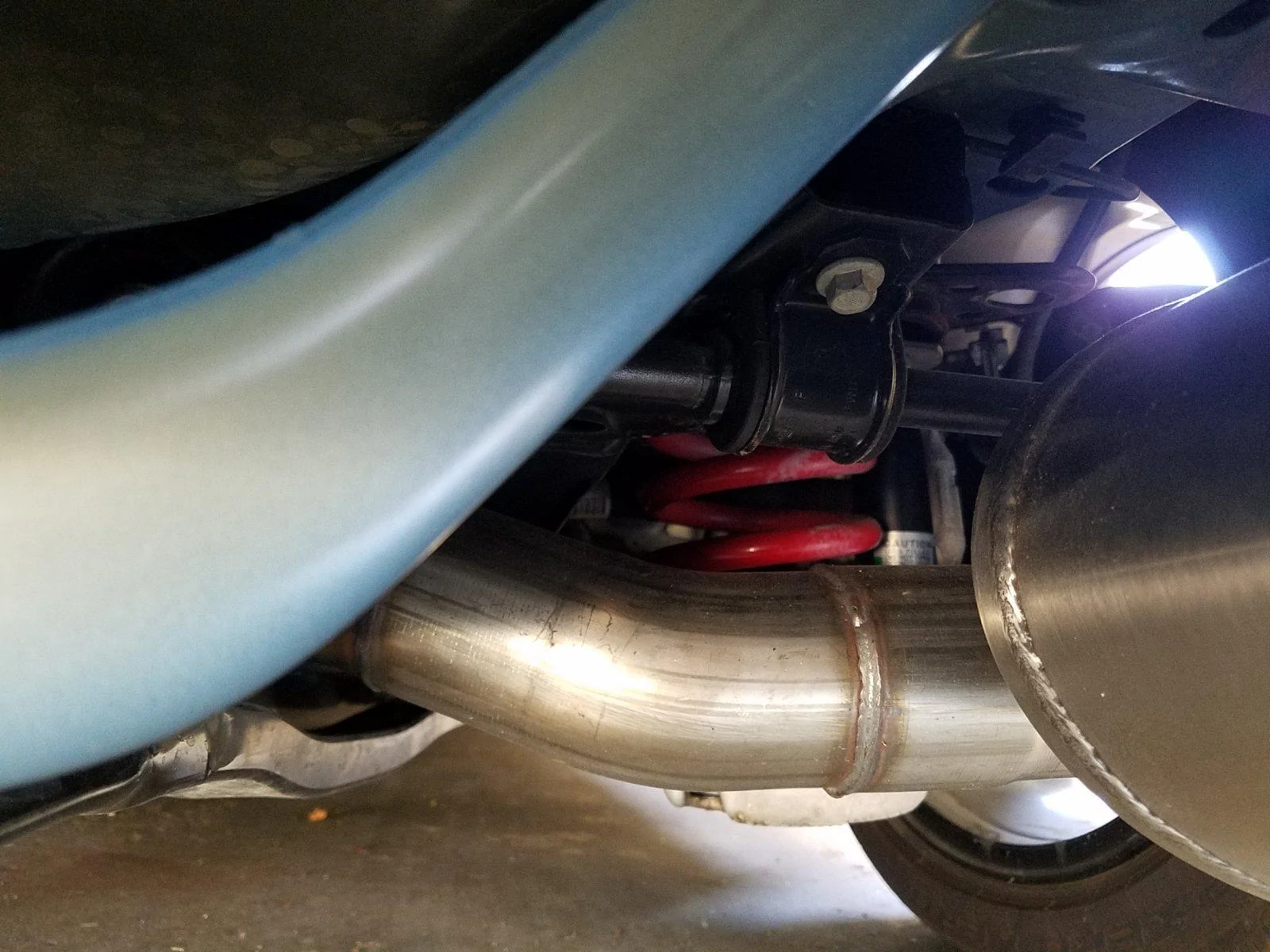

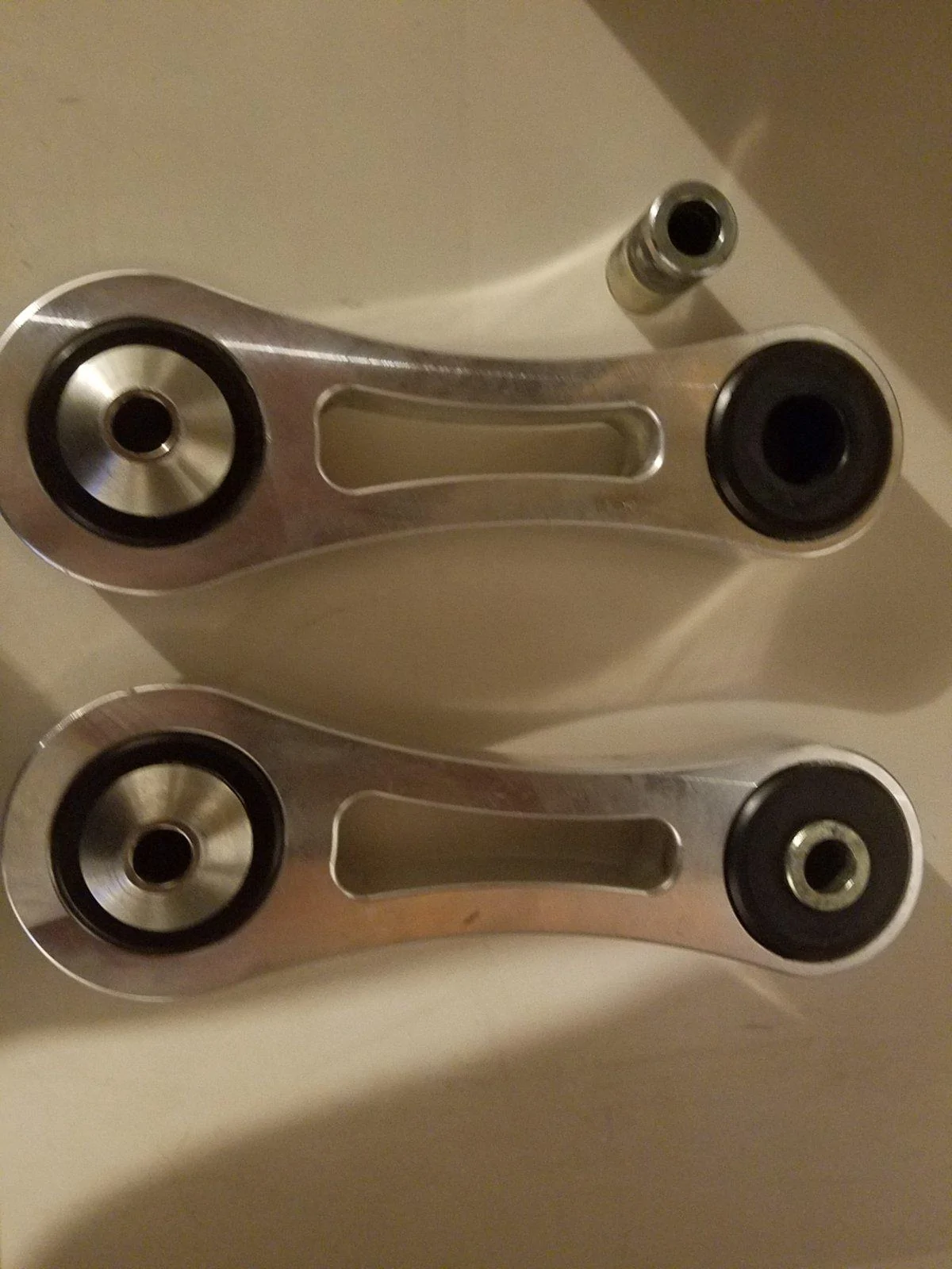

Update on the Squeaking Noise as it relates to the Vertical links. I just wasn't having any peace about the old links from my coupe so I ended up calling Steeda and speaking with one of their techs. He asked what set I had ordered and I told him it was the Delrin bushings. He asked if I was planning on doing a lot of drag racing or hard launching and I told him that I mostly was looking for better performance on twisty roads and spirited driving. He suggested that I switch to polyurethane bushings instead of the delrin. They were half the price of the delrin and he gave me an additional discount on the order. I had the alignment shop remove the old vertical links and install the new set. Noise is gone and it drives like a dream! I've included a picture of the old vertical links below. One of the inside channels actually separated and dropped out of the inner bushing. Not sure if the bushing was damaged when removing from the coupe or installing on the vert- or maybe they were just a defective set; not sure. A note about my experience at the Performance shop..... I did not realize that this shop did NOT have a drive on lift, they were able to install the springs on a lift, but had to use a trans jack to set the suspension and torque one wheel at a time. I would highly recommend to anyone getting suspension work done that they take it to a shop with a drive on lift and have them relax the suspension with weight on all 4 tires and then re-torque to spec. Once the noise started the original shop could not diagnose the issue, they just loosened each side and re-torqued, but the noise was still there. The alignment shop I took it to had it diagnosed in less than 30 minutes and did a great job installing the new vertical links and also resetting the suspension on a proper lift. Another lesson learned....

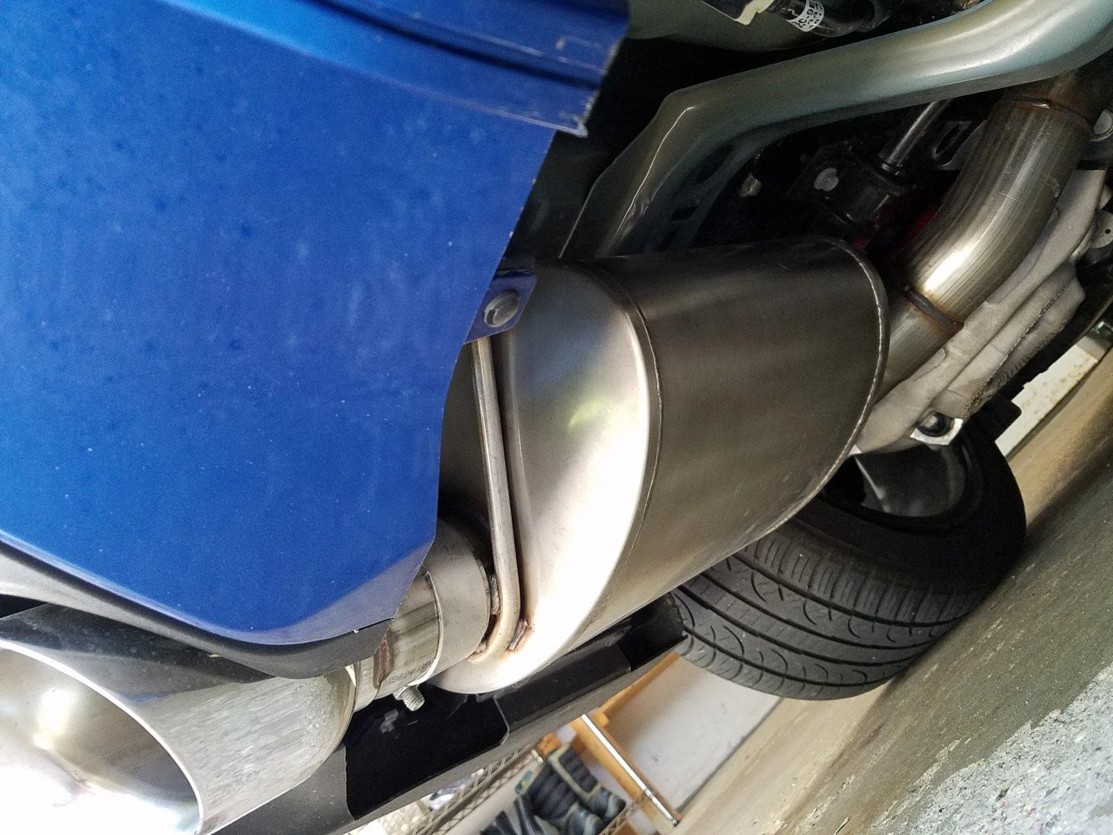

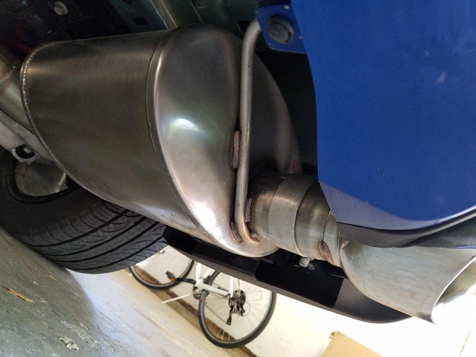

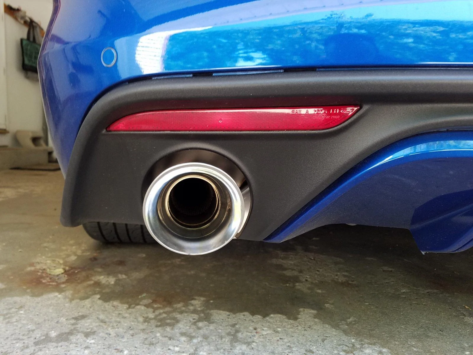

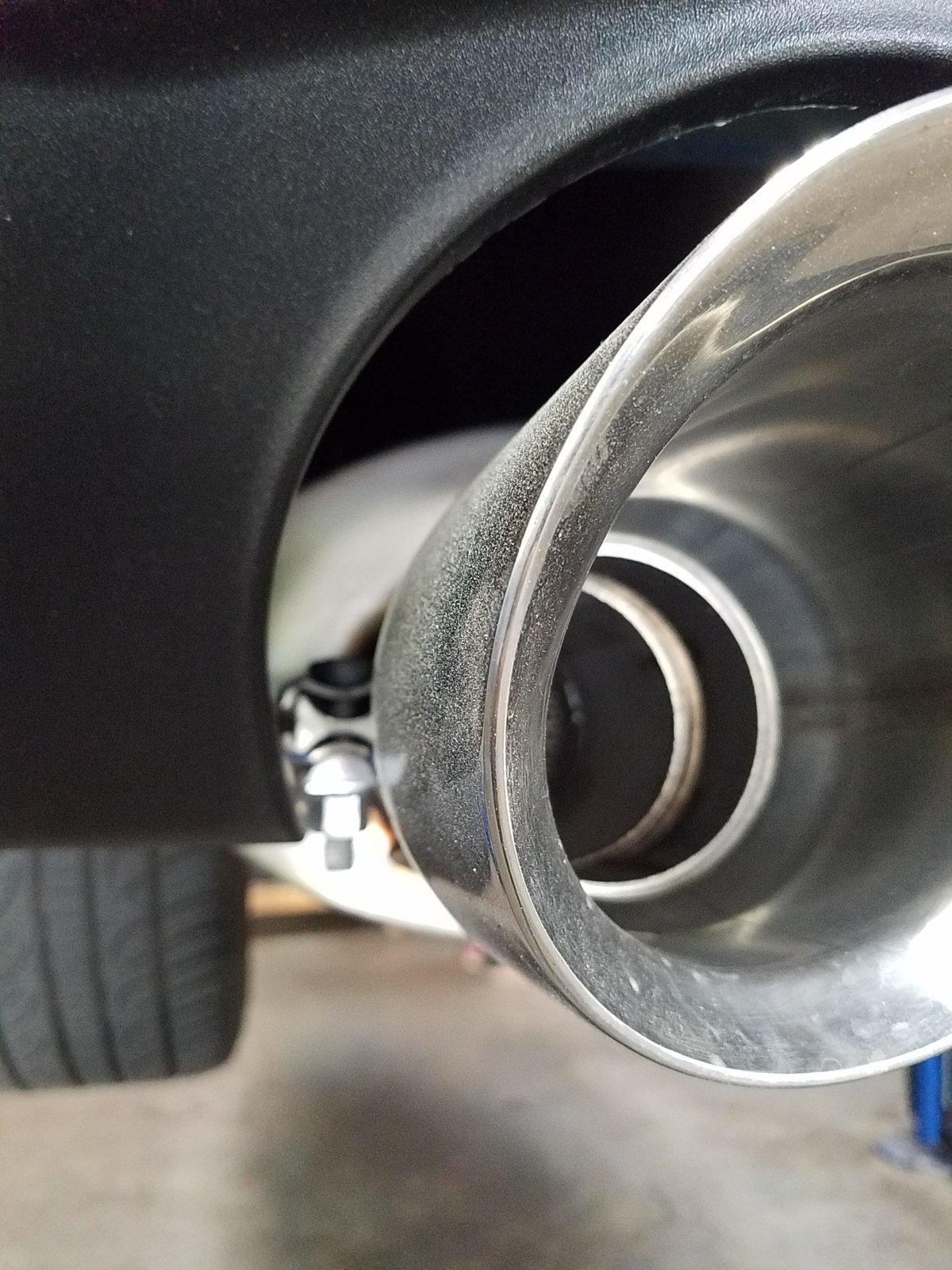

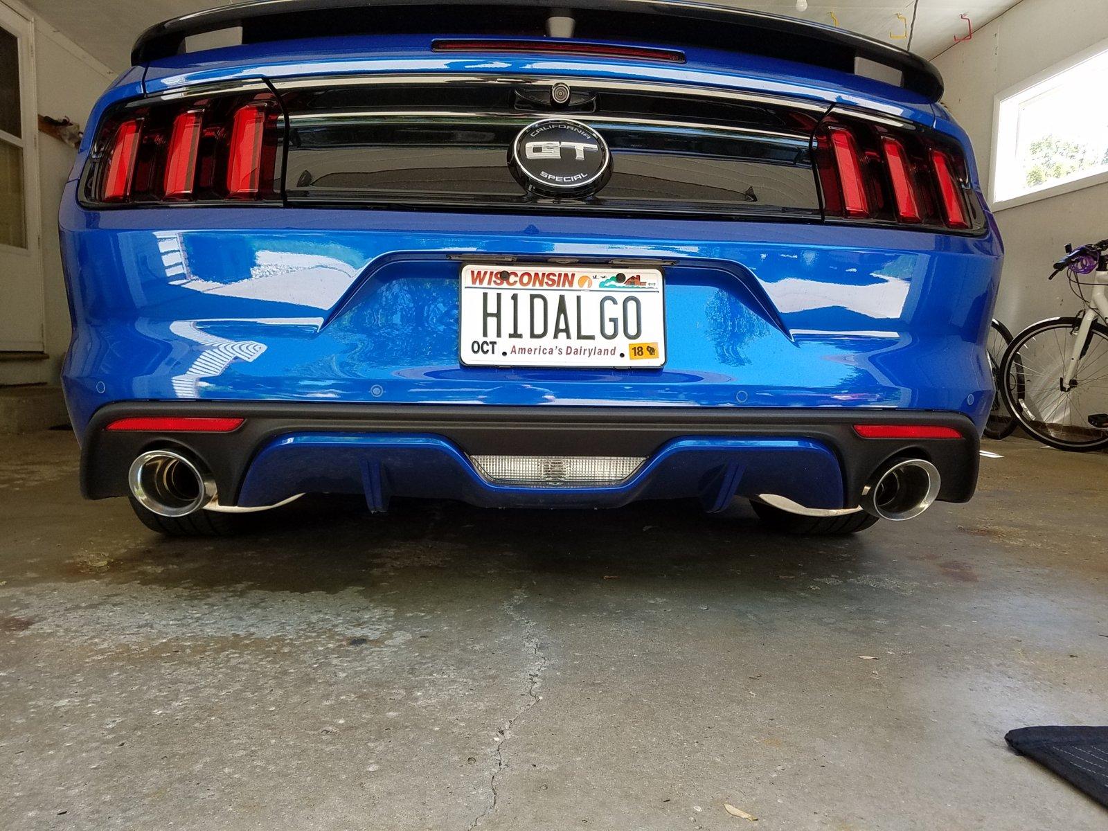

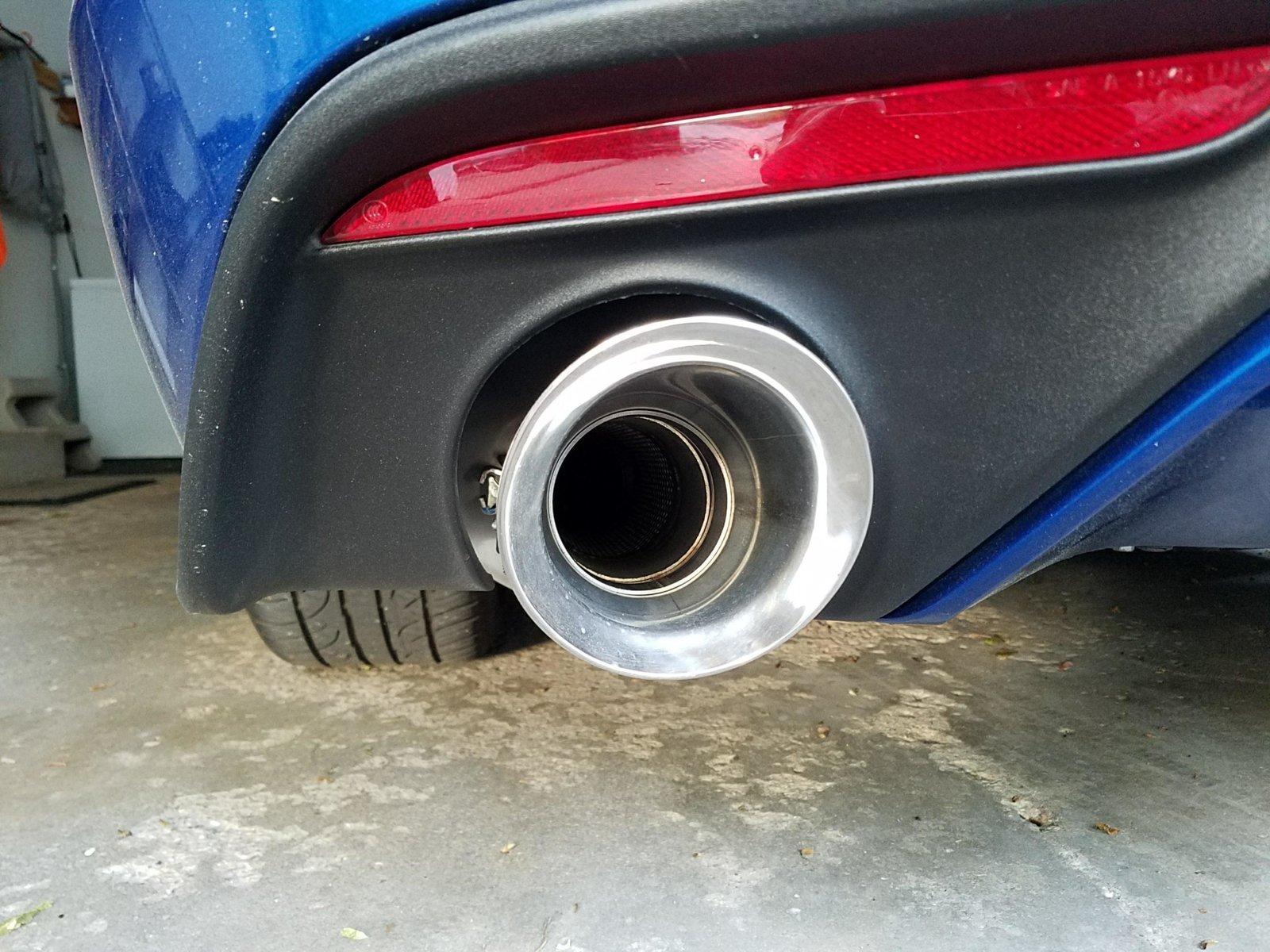

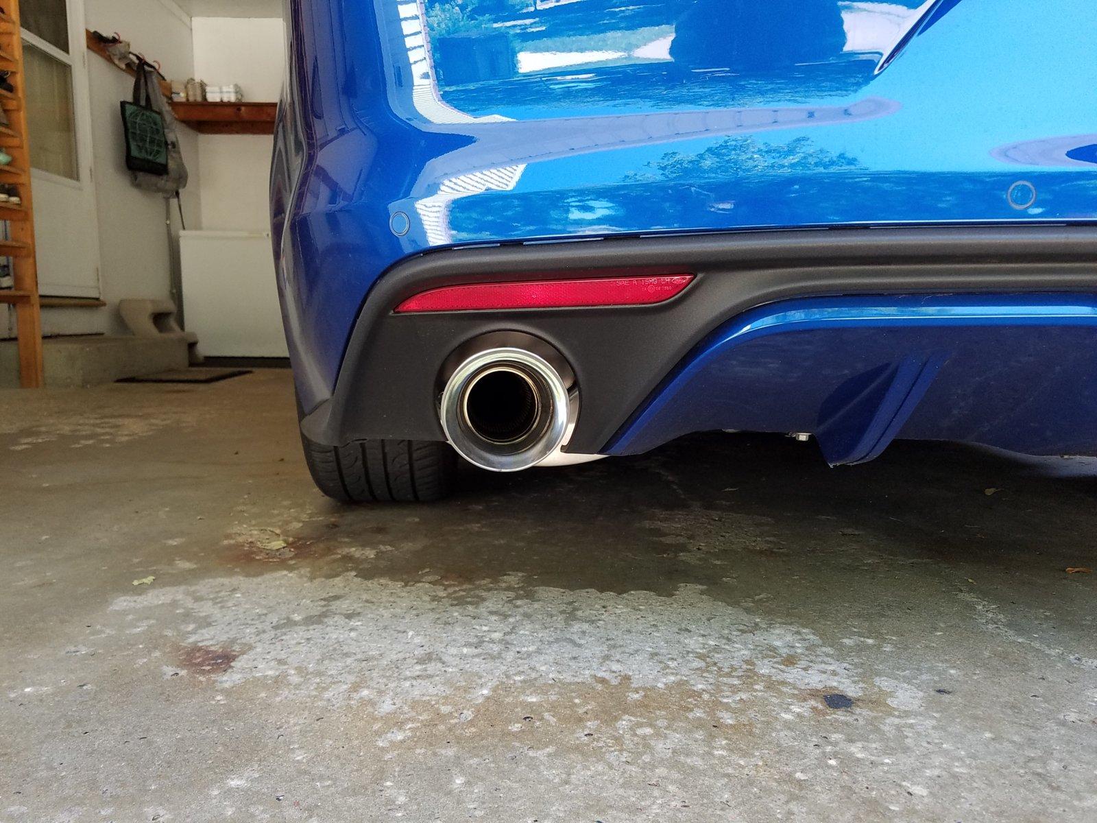

Had my Corsa Sport exhaust installed the same time I had the BMR springs and vertical links done. After I got it home I noticed that the tips were out of alignment. I decided to overlook it at first, but the more I looked at it the more dissatisfied I became. The left tip was actually touching the right side of the valance cutout. I took it to the original performance shop to have it re-aligned and they could not get it any closer. I contacted Corsa support and they suggested loosening the entire exhaust and attempt to reposition. No luck. Finally I ended up taking the stang to my local every day mechanic. I had originally approached my normal auto shop about doing a bunch of the Mod work but he seemed hesitant and did not get back to me with a quote in a timely manner. So I decided to take it to the Performance shop that had done some work on my coupe. I was not overly impressed with this shop but they seemed like the only place in town that wanted to do custom mods and were responsive in getting back to me. Long story short, my local mechanic Tony assessed the situation and suggested warming up the hanger on the rear muffler/tip section and adjusting the bend. 15 minutes later I was driving away with perfect tip alignment. He said he would have never let the car leave his shop with that poor of a tip alignment. Another strike against the original performance shop. I am officially done with them. I asked Tony, my local mechanic why he was hesitant to do "mod" work. He said he can do anything, but really makes his living on day to day basic repairs... he would have to pull one of his better mechanics off to do the specialized work and often things don't go as planned and need adjusting. He said any shop can install parts, it's the troubleshooting and adjusting after the fact that separates the good shops from the amateurs. Before I left he pointed to a 2017 Camaro sitting outside and said the guy who owns it literally pestered/begged him for weeks to fix his supercharger which was in bad shape due to one Performance shop screwing some things up and a Ford Dealership service dept breaking a bolt on one of the mounts. He knew the quality of Tony's work and wouldn't take no for an answer. Don't know why it's so hard to find good quality mechanics these days. Below is a few pics of the misaligned tips and then after the adjustment...Another lesson learned.

Thanks Bill, I agree with you. They were very helpful. I just wish I had done more research the first time on the vertical links. It does make me hesitant to transfer mods from one vehicle to another; at least the suspension mods that take a lot wear. When I sold the old exhaust on my coupe the guy i worked with offered to assist me in swapping the Steeda links off the coupe and putting the stock Ford units back on. It wasn't too difficult but it was a bit of a tight fit getting them off. Keep wondering if they were somehow molded over time while on the coupe with the Eibach lowering springs..then putting them on the vert with different lowering springs caused them to sit differently? I have it on my to do list to call Steeda and discuss what might have happened.
Thanks Bill. I wish I could do more of the work myself, but my back/neck just won't allow me to be crawling under vehicles on jack stands. In this case I believe I would have had to take it to a shop anyway as the hanger was just bent slightly crooked from the factory and needed some fabrication. The original performance shop I took it to is run by a bunch of young guys.... nice group of guys and I see them on Facebook doing some pretty advanced work such as replacing engines, complete rebuilds, superchargers, etc...Don't understand how they can do those things but they cannot adjust the tips on an exhaust or diagnose a noise in a suspension :question::facepalm:

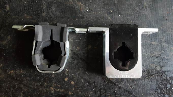

Time to focus on the manual MT82 transmission. I had installed the Barton Hybrid 3 on my 2016 coupe and although it did eliminate a lot of the slop and provided a firm shift feel it was a bit over the top for me. When i purchased the Vert I realized that I wanted something in between stock and a total shifter replacement. I decided to go with the Steeda replacement bushing bracket along with the BG Synchroshift II Transmission Fluid. All I can say is WOW... what a difference; shifts are smooth, gates are well defined without a lot of thought or effort.

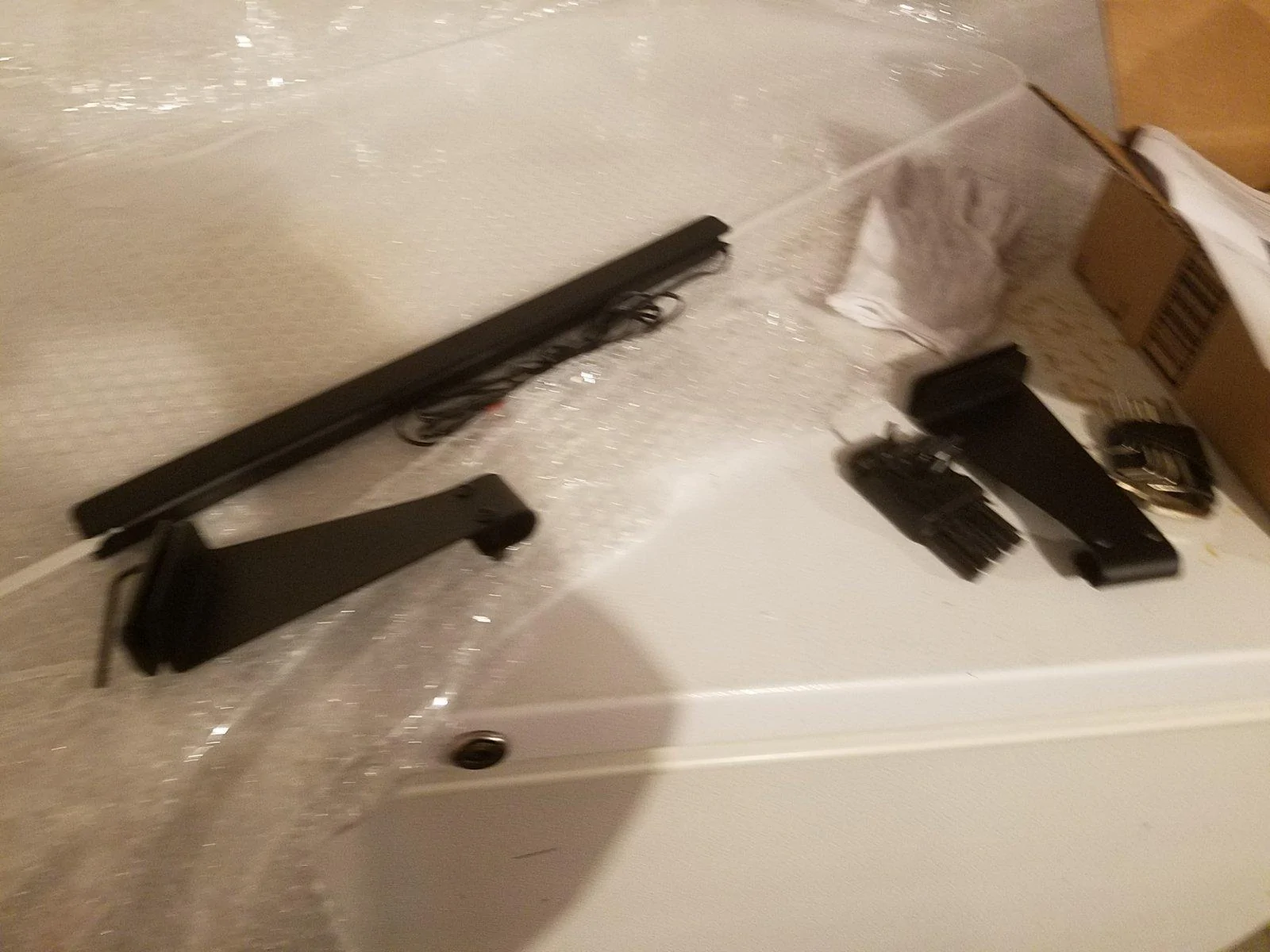

WInd Restrictor Review: After much research I had narrowed my search down to two products. The Wind Restrictor Brand and the Love The Drive.
I decided to purchase the "Wind Restrictor" brand first as the idea of keeping the back seats accessible and the light up feature intrigued me. The WindRestrictor® brand wind deflector attaches to the head rest posts of the front seats using a bracket and small hex nuts/bolts. I found the mounting system to be very cumbersome and not easy to take on and off. You are pretty much committed to leaving it on most of the time. When I first received the unit it did not ship with the correct bolts so I had to contact the company and get a new set shipped out to me. To make matters worse the new set did not ship with adequate postage so I had to pay the difference in order to take possession of the package :facepalm:. Once the unit was installed the first thing I noticed was the rear view was dramatically obstructed by the laser etched graphics. I didn't really think about this at first when purchasing it, but with the top down I still had a hard time seeing through the glass to quickly and easily process what was behind me. The day I installed it we were actually on our way to PA for the American Muscle Car show. I knew within 5 minutes that this was not going to work and removed it for the rest of the trip. I cannot imagine trying to see out the back with this installed and the top up. It's hard enough with the tiny rear window on the convertibles. As far as wind restriction goes it did an adequate job when the windows were rolled up, but there was still a significant draft of wind flowing between the center console which could be problematic in colder climates. I was also disappointed by the fact that it only came with a 15 day money back guarantee. This was not clearly spelled out on the website or in the documentation. I had assumed that I could easily return it if not happy, but the company would not budge..... I was even prepared to pay for shipping and a restocking fee. At this point I am not sure if I will keep it for occasional car shows or resell it on ebay. This company also produces a model for corvette's which I think is where this product really works well.. on a 2-seater sports couple with no rear seats this product looks great. I did not take any pictures while the unit was installed as I was in a hurry to get our road trip going. I have a few pictures below during the install process, along with a link to a demo video in case anyone wants to see how it mounts and looks when fully installed.
My next purchase will be the Love The Drive and will have a full review of that unit.....

1. Corsa Sport Exhaust- The convertible requires a specific model of the Corsa due to the under bracing. I was a bit concerned at first that the exhaust was too loud with the top down vs the coupe. I even considered going back to stock or replacing the X pipe with a resonator, but those concerns were eventually dispelled once the exhaust settled in. It is the perfect balance between the low rumble and exotic sounds. It's made this car so much fun to drive and really adds to the experience.
2. BMR Lowering Springs- I went with the minimum drop linear springs vs a progressive. I wanted to ensure ride comfort and because of the extra weight of the vert did not want to drop it too dramatically. Once I figured out the vertical link issue/noise these springs really settled in. They are the perfect balance between stance, performance and comfort.
3. Steeda Subframe Alignment Kit- straightened up the rear end and a recommended mod when dropping the subframe to install the springs.
4. Steeda Vertical Links (Polyurethane)- recommended for road course and spirited driving, replaced the delrin bushings that were installed previously.

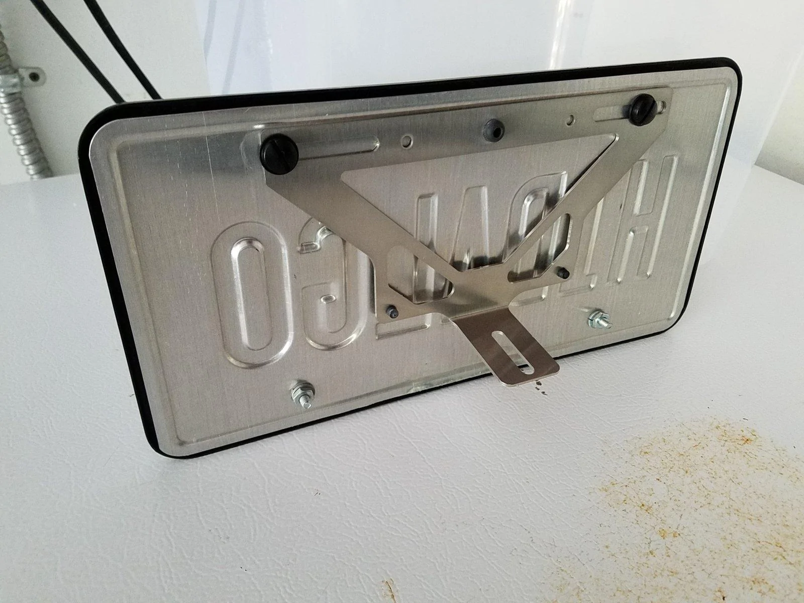

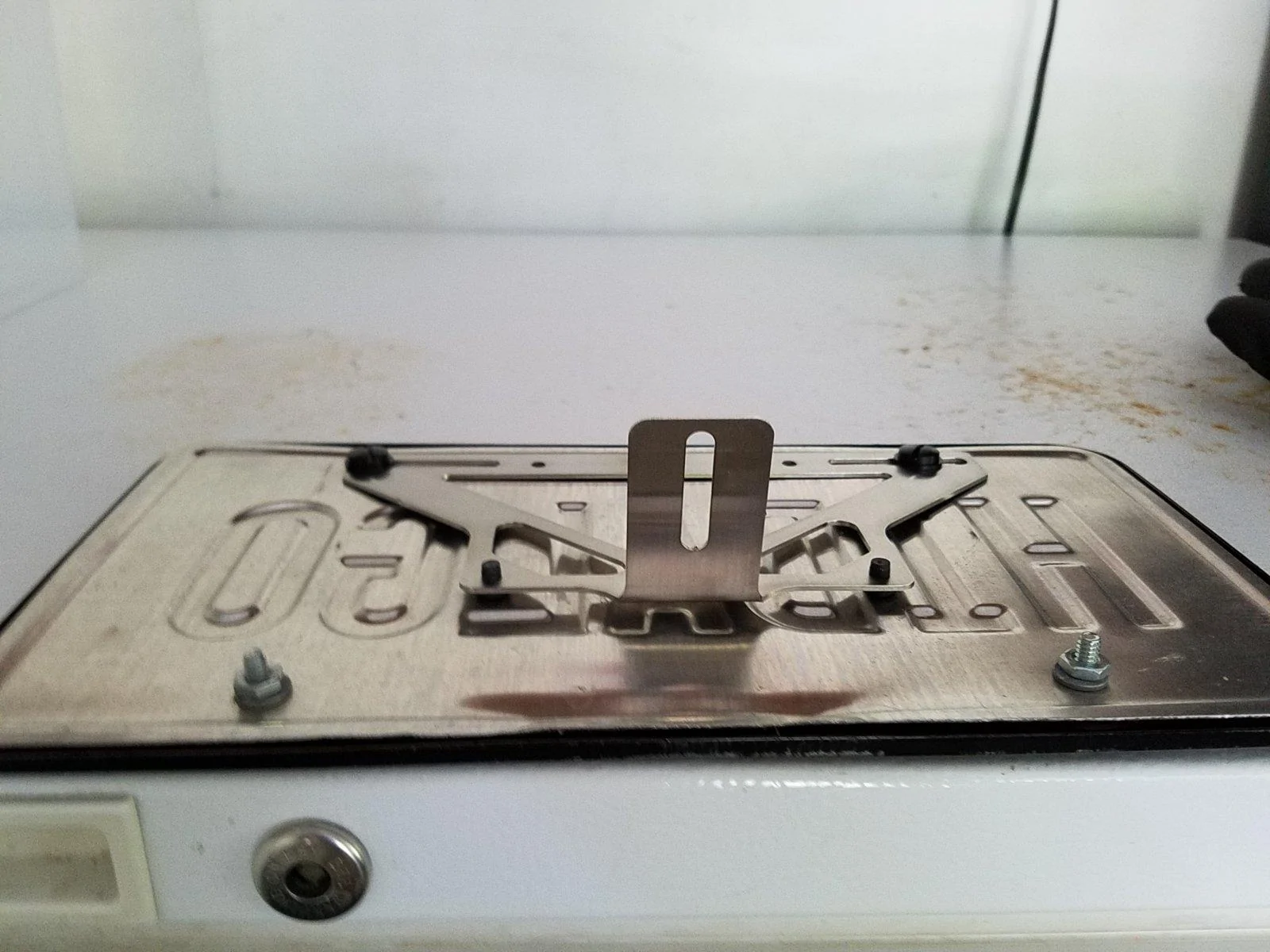

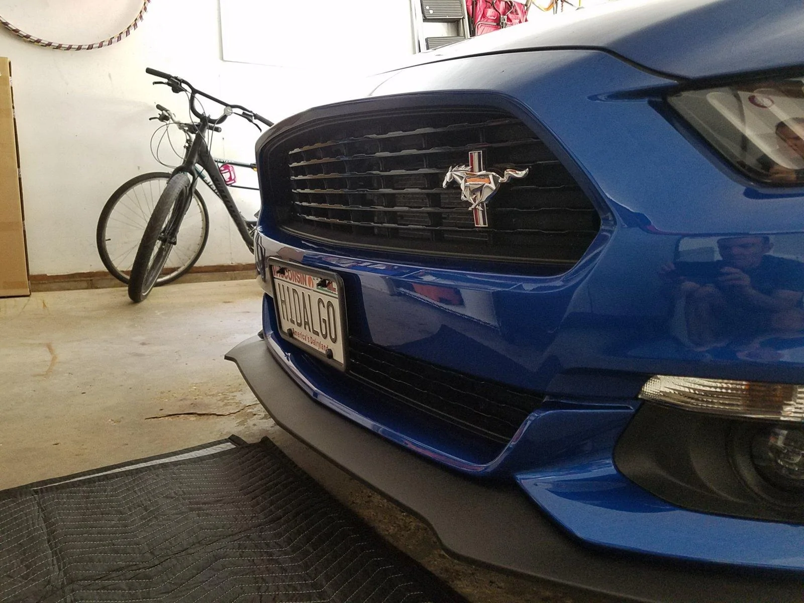

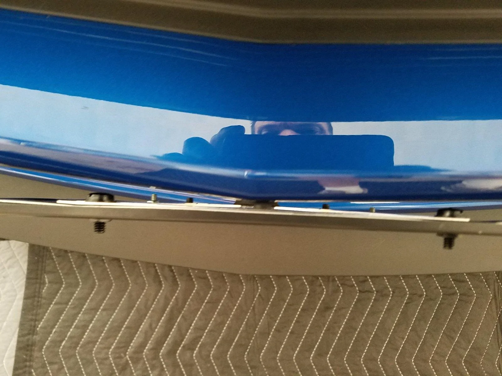

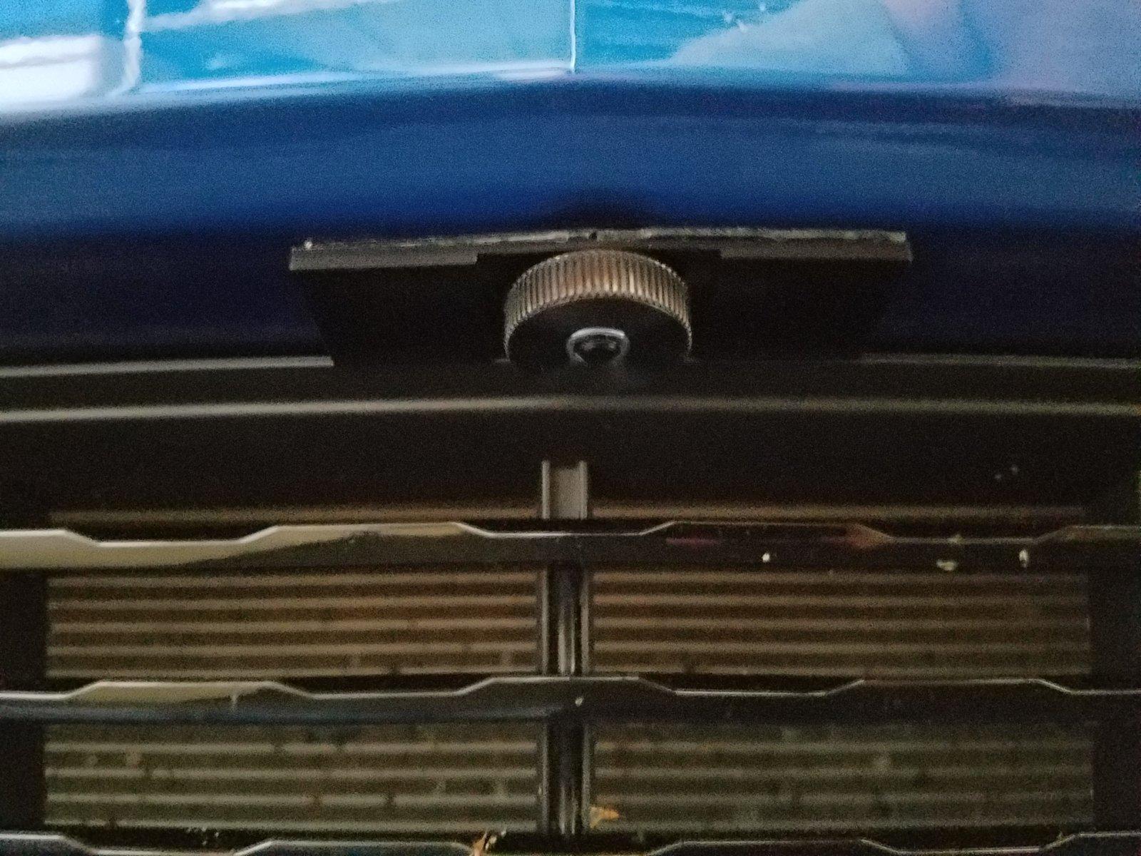

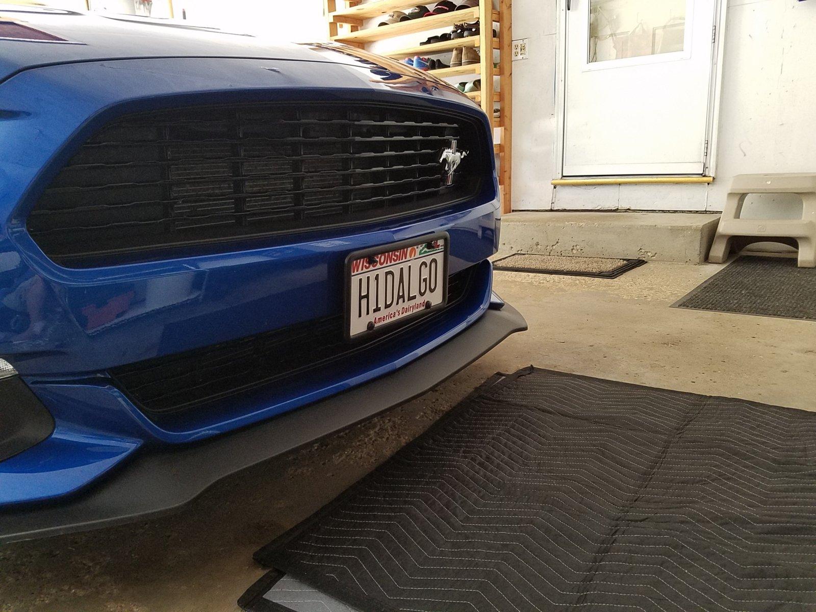

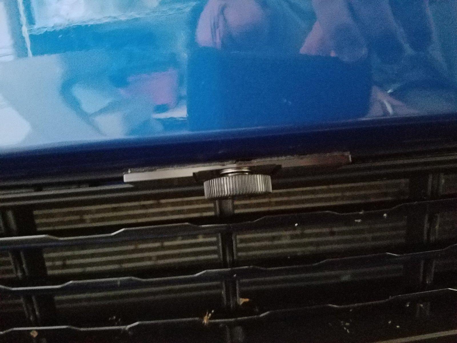

I had a bit of a challenge deciding upon a front license plate bracket. Wisconsin requires a front plate and I had previously used the Sto N Sho license plate bracket on my 2016 coupe. Although it was an easy solution it did have some drawbacks. The biggest being that it mounted underneath the front splitter. The GT is not as low as say the GT350, but i found the bracket would scrape as well as the license plate frame itself due to the lower mount position. I discovered when I purchased my 2017 Vert that my original Sto N Show would not work due to the aggressive front splitter of the CS. I did some more research and eventually decided upon Craigs Custom Mustang Bracket http://ccmustangbrackets.com/ The bracket plate mounts to the underside of the front bumper with incredibly strong 3m tape that has been tested extensively. I love the placement of the plate and it is very easy to take off if needed. No more scraping my license plate when pulling up to a parking stall.
