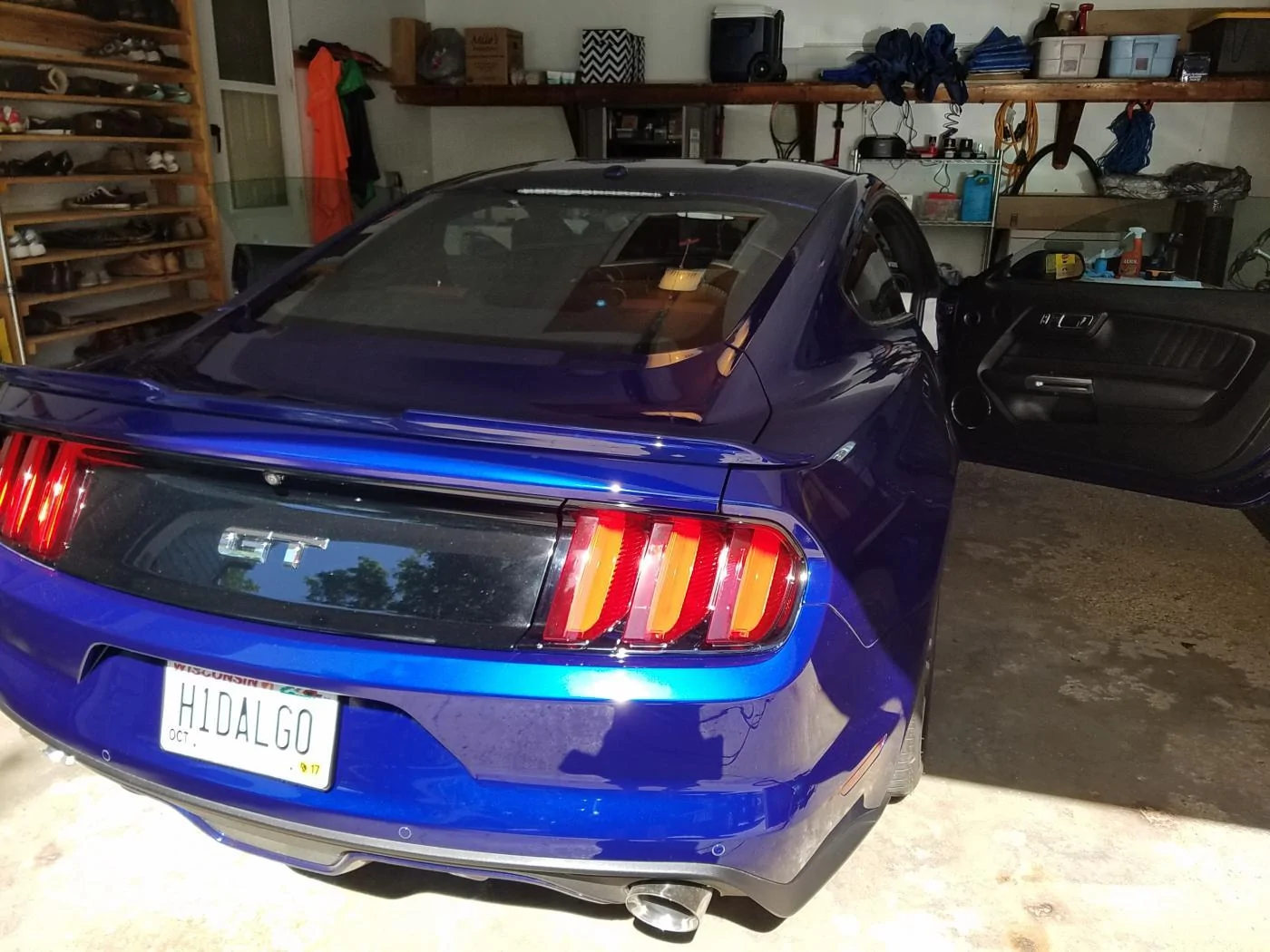

Installed this today in my garage... my wife has been gracious about me parking the Stang in the garage as we have an older home with not quite enough space for 2 cars.......:first:

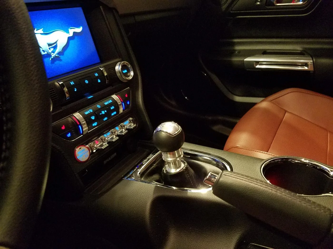

Stinger roadkill expert works just as good as dynamat and is a bit cheaper, if you decide to add more. I have a background in car audio and have tested many products. Second skin makes amazing products as well. I've been very happy with their products but they do come at a premium. Any MLV (mass loaded vinyl) on top of the sound deadener will certainly help. You can also double up on the dynamat if you are so inclined, but the second layer won't provide as much of a difference as the first. You can also pull the rear seats and install some under there. The transmission tunnel carries a lot of noise. I installed some deadner in that area when I installed my hybrid 3 shifter and it definitely helped.
Last but not least, spray foam (great stuff brand) also works for killing noise but it is extremely messy. I've done many trunk lids and trunk areas and had great results. That's for both sound systems and making a more quiet vehicle.
If you continue on with suspension mods, you'll pick up more and more NVM.
Build looks great so far. Makes me want to start one.

Thanks...i am going to add some to the trans tunnel as I realized that when I installed the Barton hybrid3 shifter I did not install the provided foam insulation...i also need to remove a set of the springs as it feels too stiff for me...will add some dynamat to the trans tunnel along with the sound deadening foam

I added some to the base of the shifter as well. You definitely need to have that foam in there haha.

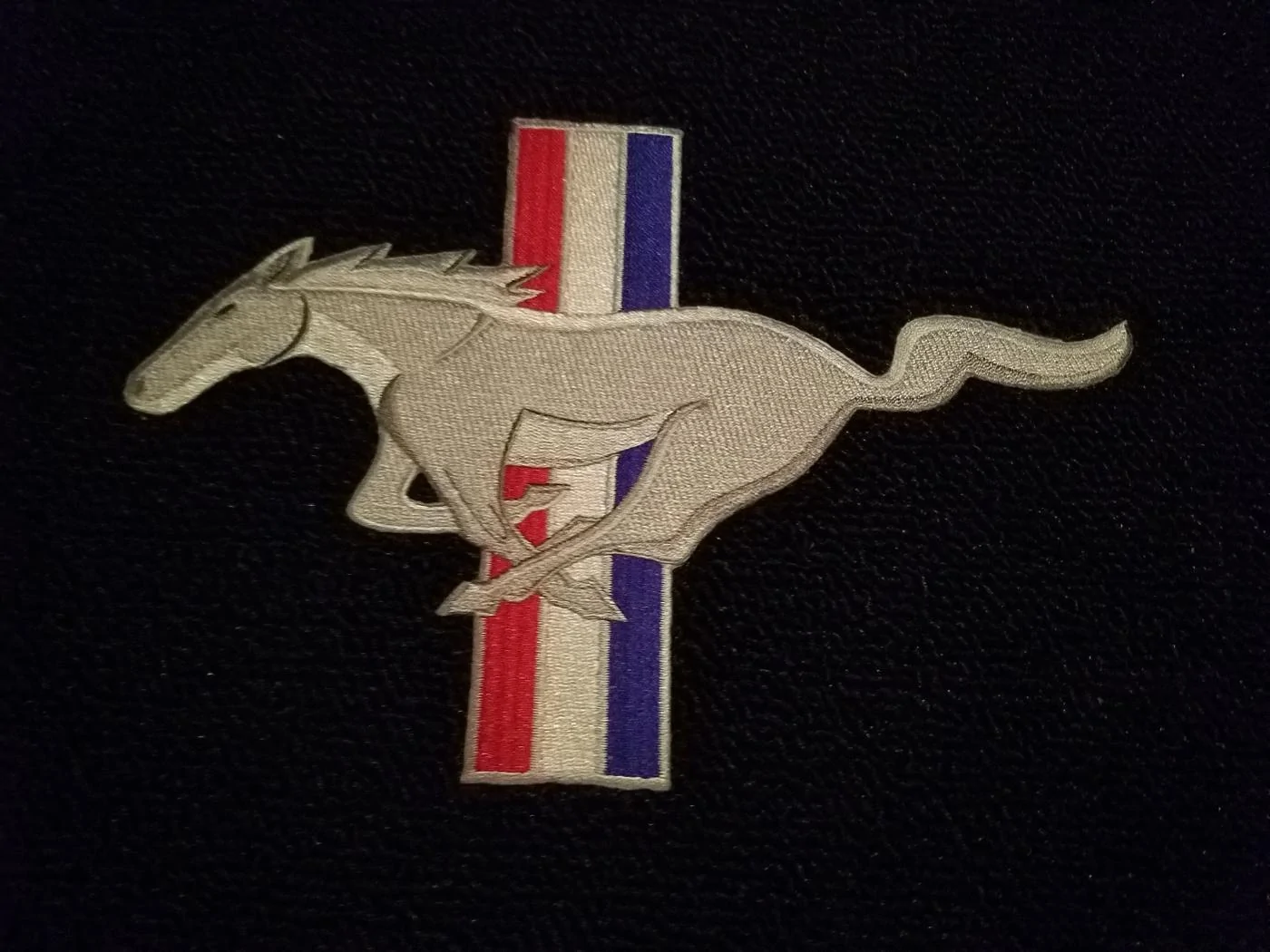

Installed Lloyds Trunk Mat with Tri-Bar Pony Logo. Really nice/high quality mat. Dresses up the trunk and gives it a solid feel vs the thin felt type lining that comes stock. I love the retro full color Tri-bar pony logo and this adds a bit of class to the back. I smile every time I open the Trunk...:D:headbang:

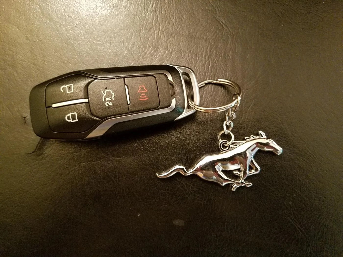

My Daughter bought me this cool Running Pony key chain for the Fob... it has some depth and thickness to it... Love how it looks and feels..... another great little add on to enhance the Mustang Experience.

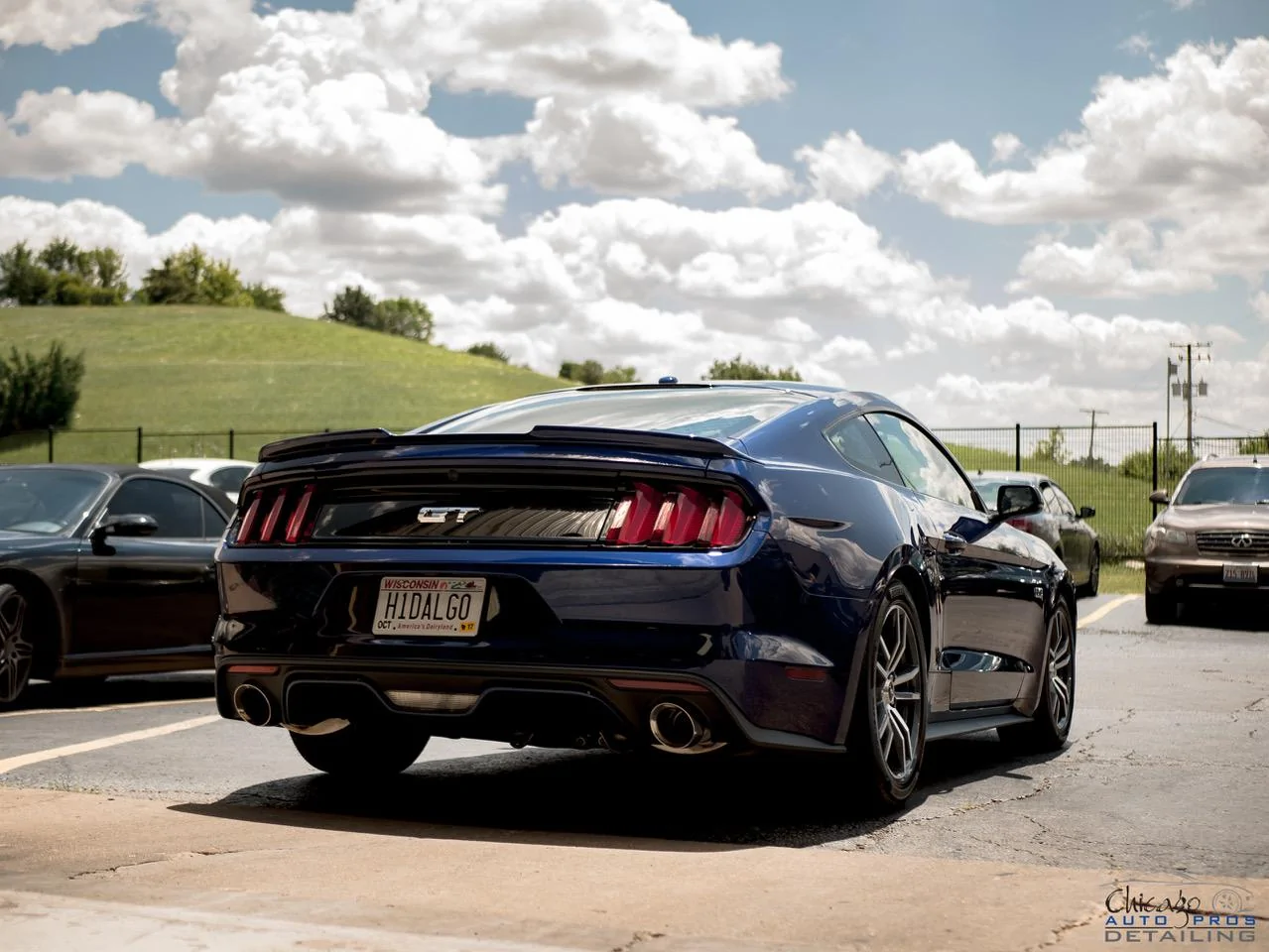

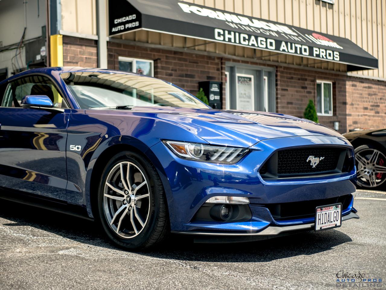

Finally got some photos back from Chicago Auto Pros in Glenview Illinois. I had the front bumper fascia wrapped in XPel paint protection film, then had the entire car coated with Modesta Ceramic. I am really happy with the end result. The car has been really easy to clean as I am limited on time and did not want to spend hours washing and waxing. The Modesta provides a deep, rich color depth and shine. I love looking out the rear view mirrors and seeing that glossy finish on the haunches of the back end.
