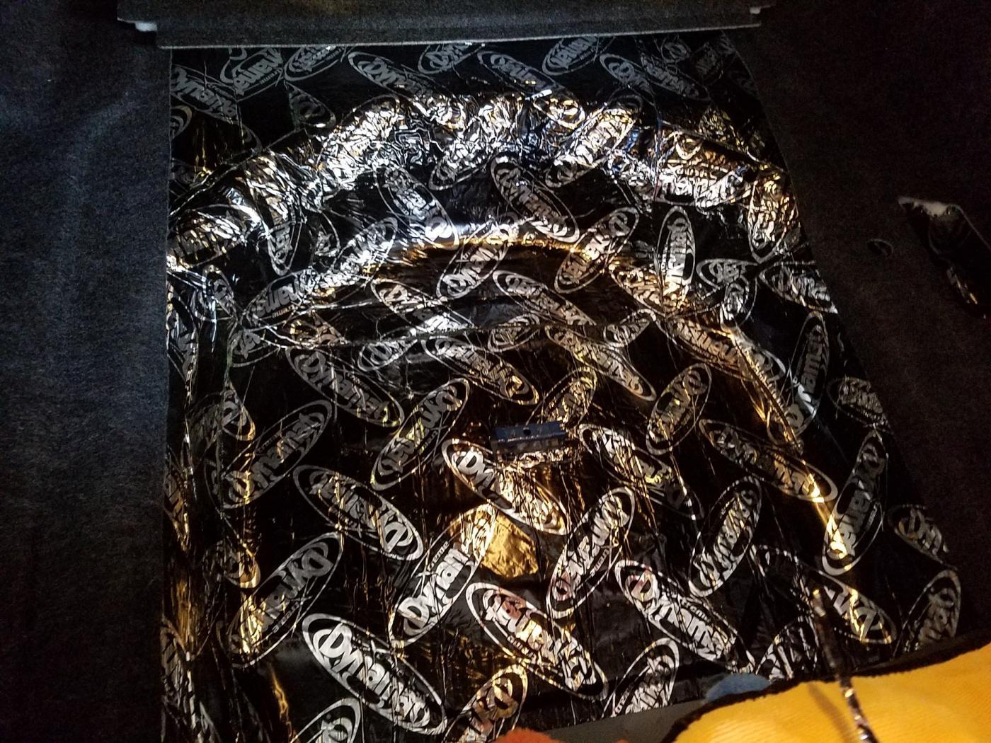

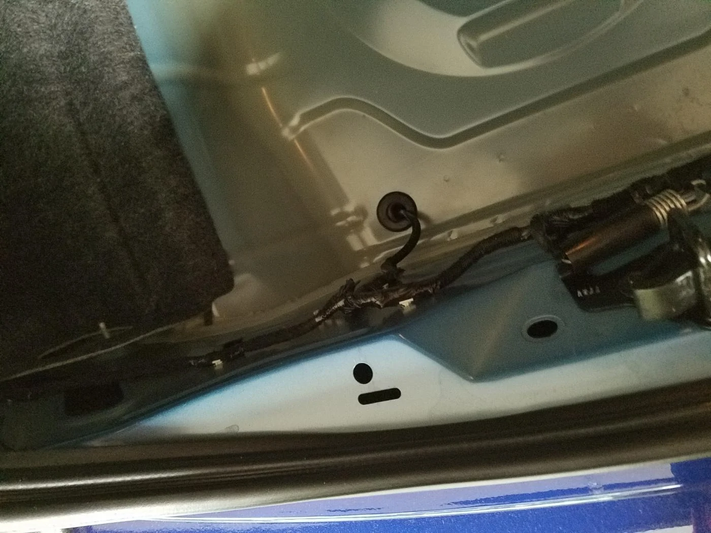

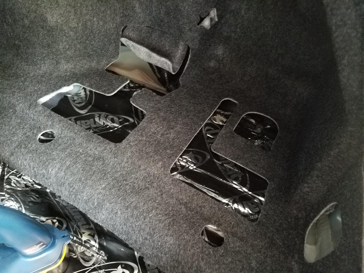

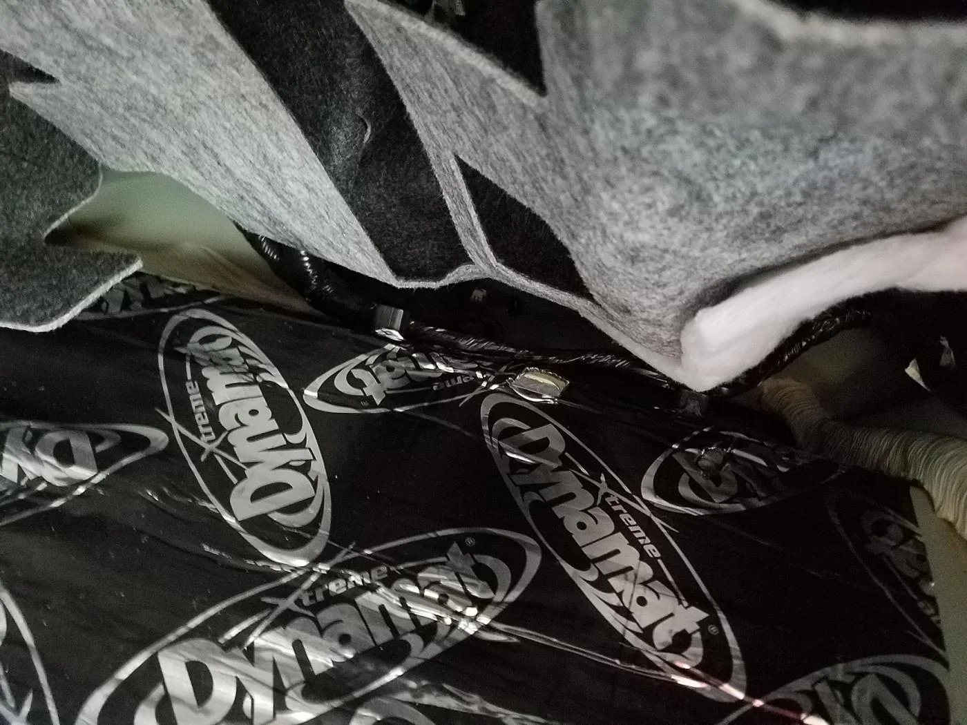

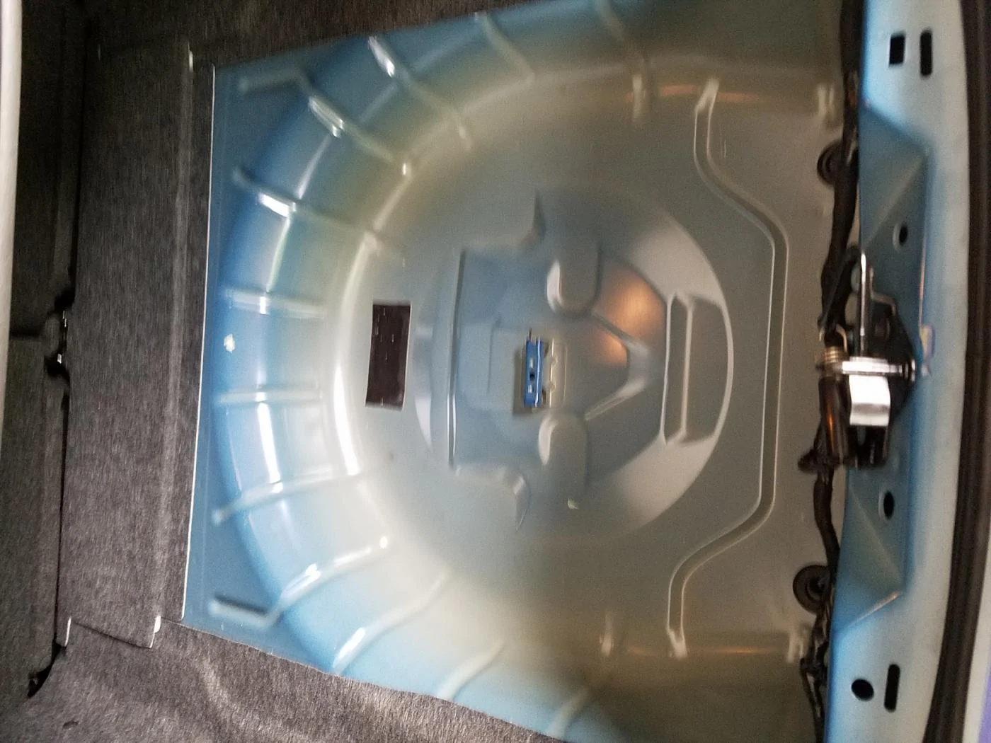

I did some research and decided to install dynamat in the trunk in an attempt to "take the edge off" The spare tire well is just bare metal with the only sound dampening being the lightly carpeted cover with a small amount of white foam on the underneath...The results of the dynamat were limited. I noticed a small amount of reduction in the upper band, but the lower frequencies from the borla exhaust were now more noticeable. After speaking the a technician with Dyanamat Corp they suggested I combine the dynamat with their dynapad product thinking it would take care of some of the low frequency sounds.... I decided to purchase some dynapad for the trunk area and am trying to figure out how to install it effectively. You can't really lay it underneath the cover due to the thickness, as the cover will not lay flat. I even thought about adhering it to the underside of the cover panel, but they do not recommend it hanging....The best option appears to be putting the dynapad over the top of the cover and then installing a Llyods trunk mat over the top of it.....
I am also considering going to the Corsa Sport Catback which from everything I hear is quiet on the highway with no drone and would achieve the results I am looking for.. my hesitation intially was that the Corsa was not the "classic muscle car sound" but at this point I am over that and just want a better interior cabin experience. I still want to hear the exhaust, but the ability to tone it down when driving 6 hours on a long distance road trip really appeals to me. I actually met up with another 6g forum member down near Milwaukee (thanks Kyle!) and got to ride in his Black S550 with the Corsa Sport Exhaust. He had just switched to Corsa from the Magnaflow.

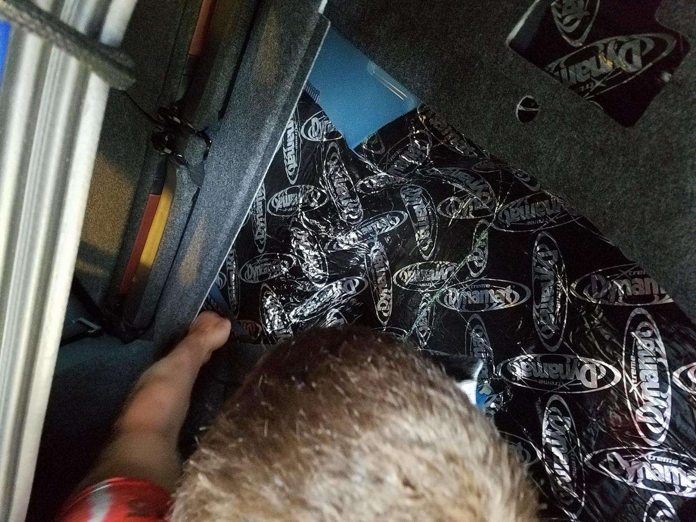

Here are some picutures of the dyanamat project. I decided to remove all the insulated covering in the trunk and do the spare tire well, the side wheel wells, under the subwoofer, and the small shelf up to the back seats....My son came over on my birthday to help with the install.

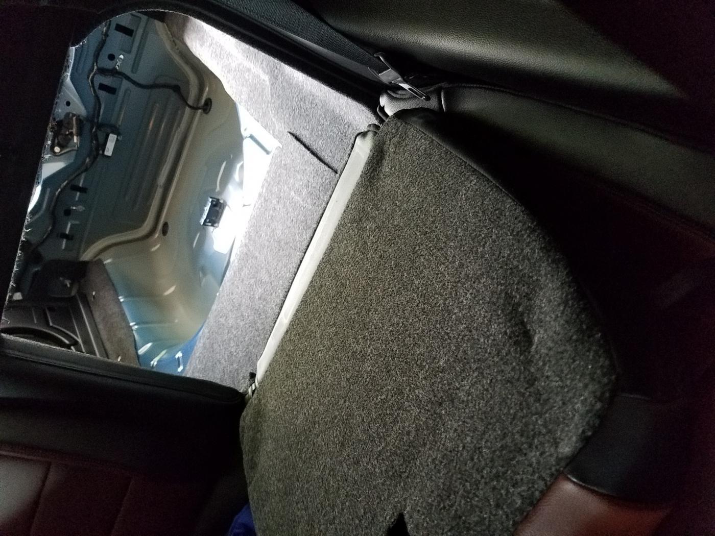

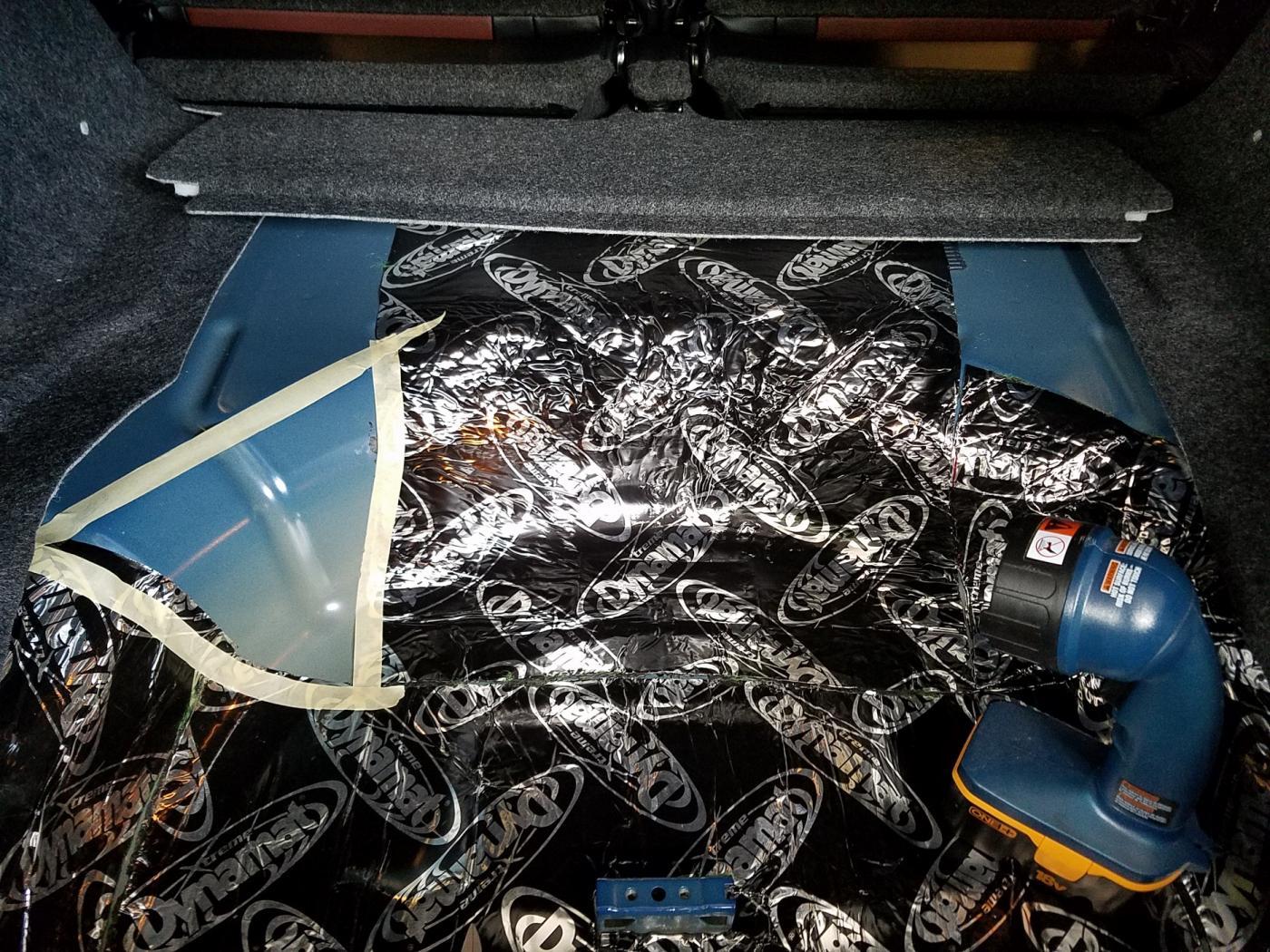

More Dynamat pics and a photo of me with my son after the project is completed.... An extra set of hands is really helpful....It was a good birthday!....I look awfully small next him.. hope I am not shrinking as I age......:confused:
