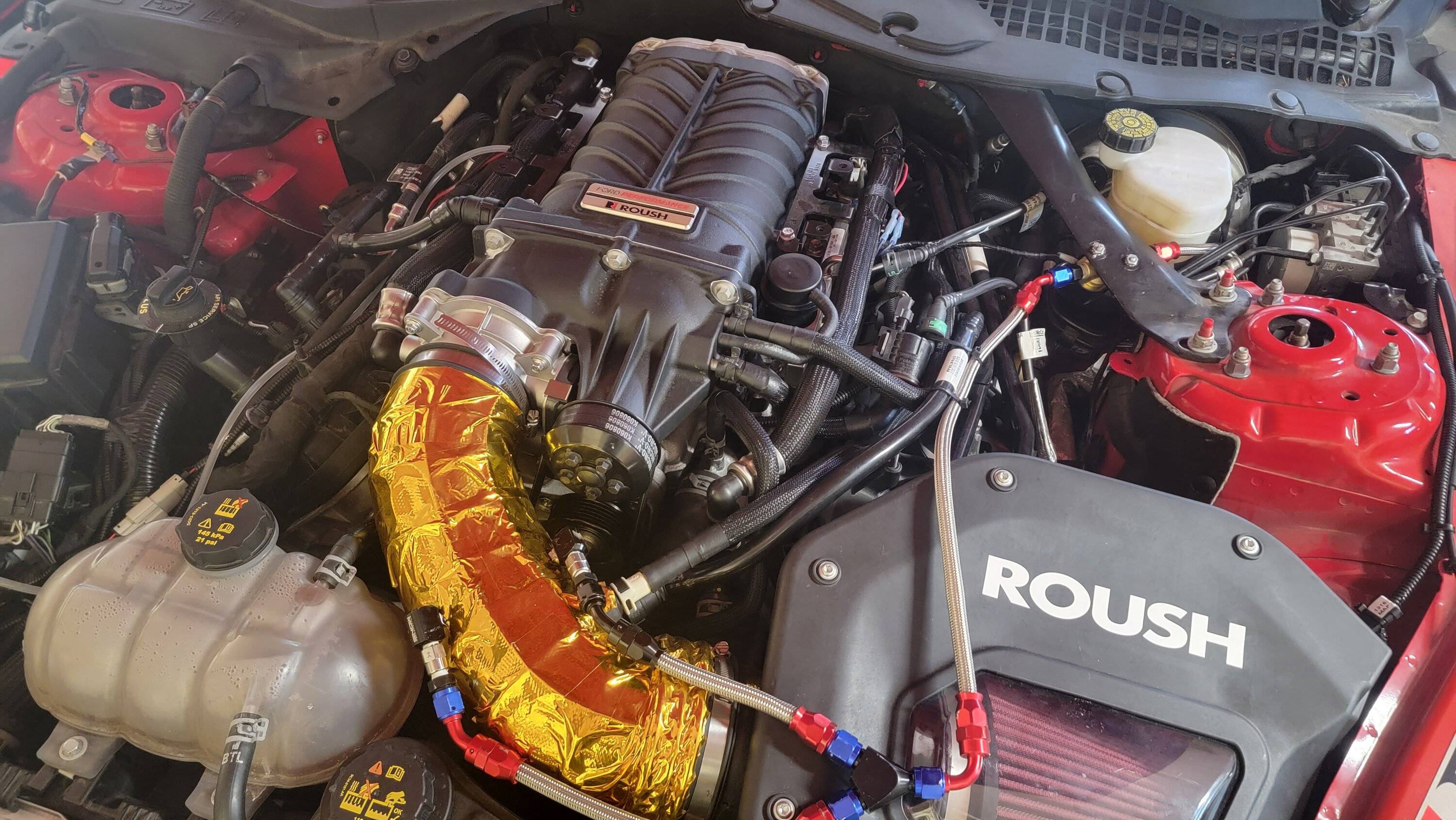

The engine is equipped with a Roush Phase 2 supercharger kit. Car is now tuned by PBD and incorporates methanol injection. I installed DEI gold heat tape on the intake tube and header side of the intake box which did lower non-methanol IAT2 temps by about 10* after extensive hard driving.
