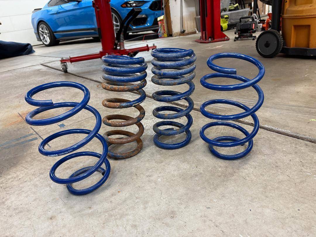

Suspension tuning is complicated but you could maintain a reasonabley comfortable ride by matching spring rates to your OEM specs and choose whatever ride height you prefer by the "lowering" spec advertised by the aftermarket springs. If you just want improved cornering, larger diameter anti-sway bars will give the best bang for the buck. I just removed this set of "progressive" Steeda springs from my son't GT and the lowered stance was just right for his liking. My Mach 1 HP springs are slightly lower than the GT and the higher spring rate is still comfortable. Just understand that cold wound suspension springs are made from chrome silicon/vanadium wire and there is high residule stress that needs corrosion protection for OEM level fatigue life. I've had many years experience in the spring industry and I couldn't let my son continue to daily his lowered GT on Steeda's springs with such severe corrosion on the rear springs. (Steeda doesn't warranty corrosion.) If you decide to replace springs, stick with OEM or and actual manufacturer, like Eibach, that understands how critical coatings are and will stand behing their quality. (Ford even addresses this concern in their shop manual buy instructing technicians not to damage the spring coatings when they compress them or service them.) Good luck with your project.

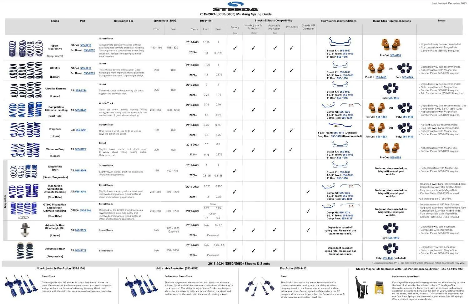

Steeda Progressives and the Pro Active Dampers work well together.
But I don't see those for the 24/25s, so may still be developing.
But the Pro Actions at available for the 24/25s.
The front springs drop the front stance 1 & 1/8 inch - so it makes the stance front to rear more even.
The rears are 1 inch drop.
If the height is too low Steeda sells a front spacer kit which brings the front up in 1/8 increments with a total height adjustment of 1/2 inch with all 4 spacers installed.
And they a set special for use with the camber plates.
The rear spacer is just a metal ring that sits on top of the spring mounts and they have 1/8, 1/4, and 3/8 sizes.
The rear spacers will change the stance by double the spacer size - so a 1/8 spacer will increase the height 1/4 inch; the 1/4 will increase 1/2 inch; and the 3/8 will increase 3/4 inch.

Hi. The bottom line is I want a smoother ride. I became accustom to the ride quality of the magnaride on my 21 EcoBoost hpp. I don't expect to replicate that ride, but a little less jarring over bad roads would be great. Steeda didn't recommend changing the shocks, only the springs.
It is not necessary to change the shocks & struts - it will give you an even better ride quality over stock but the Progressive Springs are our best-selling springs for what you are describing - ride quality. As the other poster mentioned - the minimum drop springs are solid too.
Our springs are custom-designed to our specifications by one of the leading spring manufacturers in the industry.
Living in Michigan, I understand firsthand how the salt and other materials used on the roads can damage car parts, not just the spring coating. I’ve lived south of you and have had to deal with the frustration of replacing parts and dealing with rusty underbodies. Unless you're storing your vehicle for the winter or washing it regularly, it's almost impossible to prevent the effects of road salt in Michigan.
