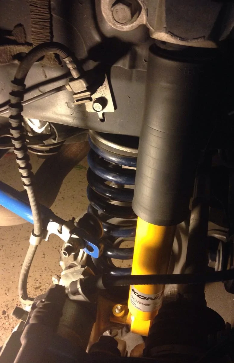

I couldn't tell but are you using the steeda urethane differential bushings? I installed just half of the kit(black inserts) on the rear half of the differential and noticed a dramatic decrease in rear bounce with Steeda progressives. I'm using koni rear shocks but there is still like 5% bounce there.
I skipped the differential bushings because I don't want to hear any gear whine.
The bounce has definately been reduced with my current setup, just not enough for my liking.
