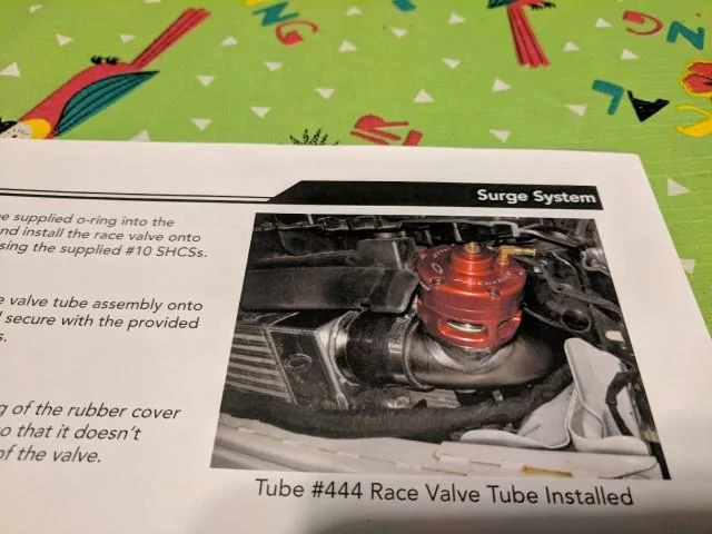

Hate to revive an old thread. But with pipe 444 and the Red Race BOV we can run the MAK inlet pipe without denting it?
p6cl
Dec 4, 2017
307
135
Near Cleveland OH
Ray
2016 Ford Mustang GT Convertible
First, yes the MAK 4" Tube fits very tightly due to the Metal Car Frame that is in the way. Also I scratched up the Big Red Race Blow Off Valve because it hits on the Radiator piece that is right above it. (Very Tight Fit) on my 2016 Convertible.
I bought that tube #444 to go with the Big Red Race Valve I bought on my P1X Procharger and it stalls on my AED Tune and Runs better on my LUND Tune but still does not seem right. I asked both tuners and they stated it should not affect the car. Well, I called Procharger who said to relocate the MAF from the Intercooler and buy the $350 ish GT350 Pipe and then I have to update my Tune at another cost along with the Tube cost and kit that was $180 ish and the Procharger Red Race that was $300 ish (cheap). So I just put the Procharger black Bullitt Valve back on and well, what do you know the car ran good again. Pisses me off to spend this much money and not have it work as it should. Anyone else have this issue with the Red Race Valve?
I want to see if it was having a Vacuum problem so I went to change the vacuum tube push it style piece with my regular vacuum tube fittings and the threads are different in the Big Red Race Valve then the Bullitt one.
