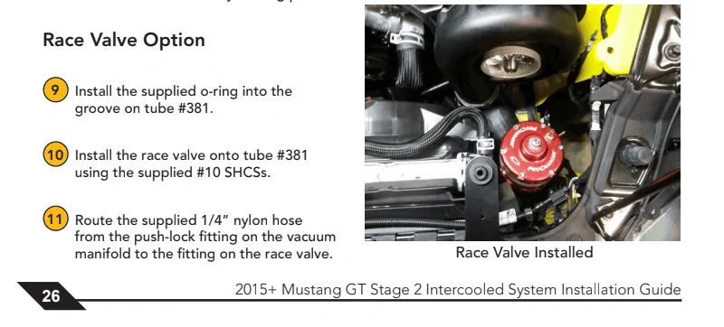

Check page #26 of the Procharger installation manual.
Tube #381 is what you need. Check the attached picture it shows where the mounting placement is also. You have to be careful with the placement if you're using the stock rubber 90* elbow as you don't want the race valve to press up against it. If you're using a MAK inlet you'll have to make a dent/dimple in it to fit the valve.
I prefer the BOV on the hot pipe behind the grille for sure. If you have a grille on the side openings you will have to trim it to fit (I did). If you have no actual grille mesh in the side openings the BOV will probably fit right though with no problem. If you get the coupler welded onto the pipe make sure to either get a new aluminum pipe made up or to paint the steel Procharger pipe otherwise it will rust once sanded down and welded on.

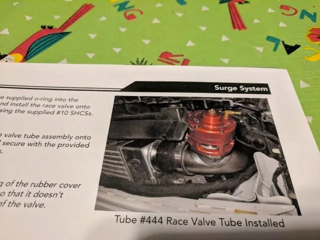

The red race valve has been moved to the same location as the pro flow. Comes with new ic pipe and red race valve.

Oh damn, I didn't know that. That placement is so much better. Thanks :cheers: :thumbsup:
Correct #444 on its way.

So tube 444 puts the red valve in front of the radiator support? How much for that part Doug?
