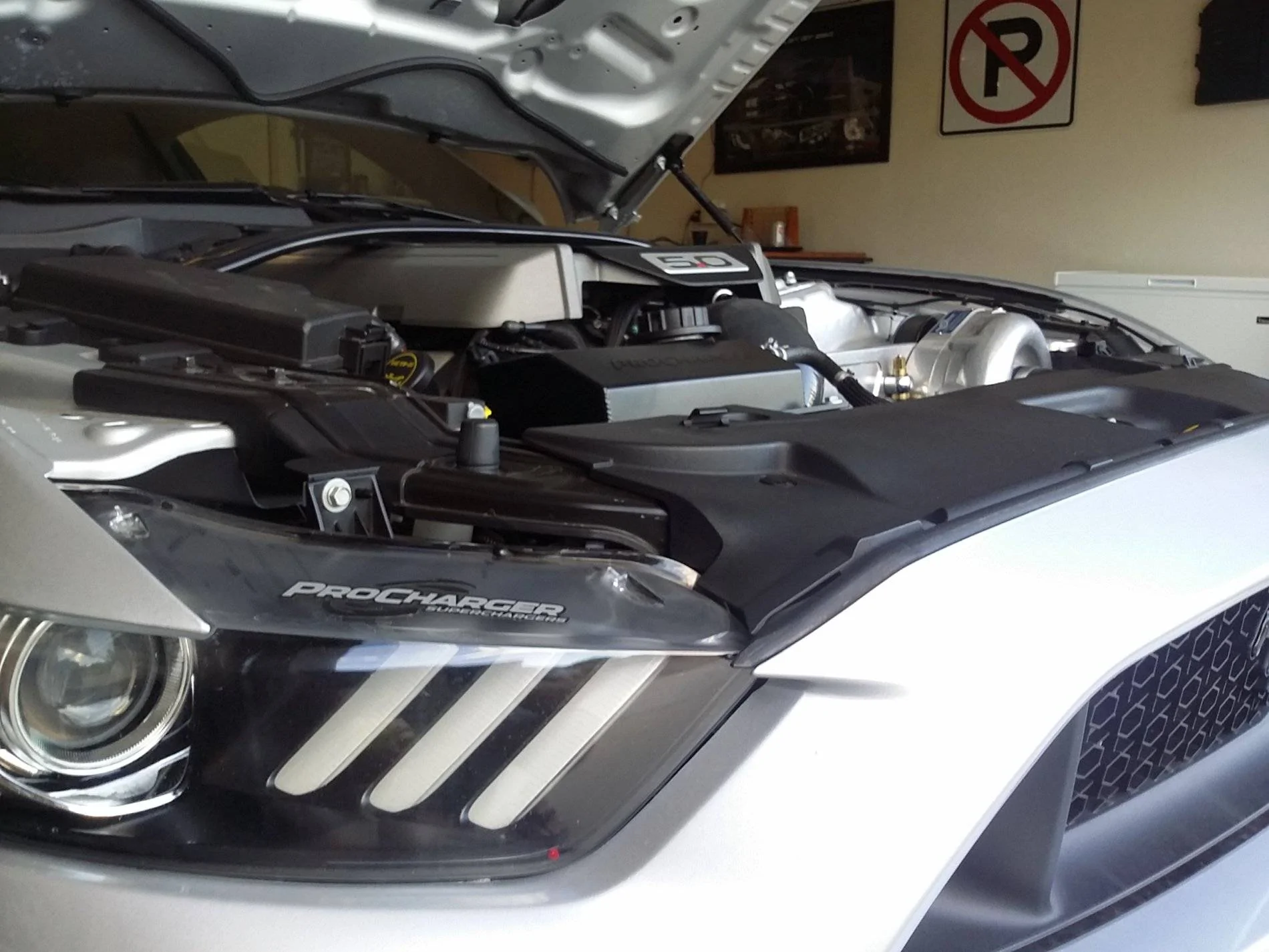

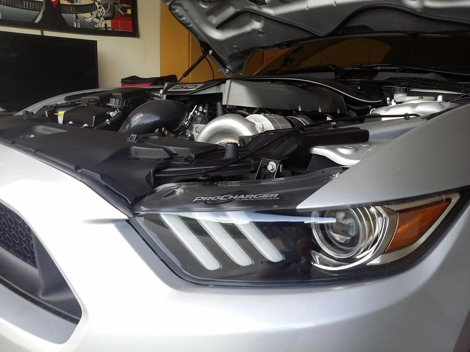

Happy new year all.
I have a 2016 with a Procharger DX-1 on it with the stock manifold on it. I understand that there are problems with trying to replace the stock inlet manifold with a 2018 manifold. Does anyone know what the problems are and how they can be overcome?
Cheers, Pete.

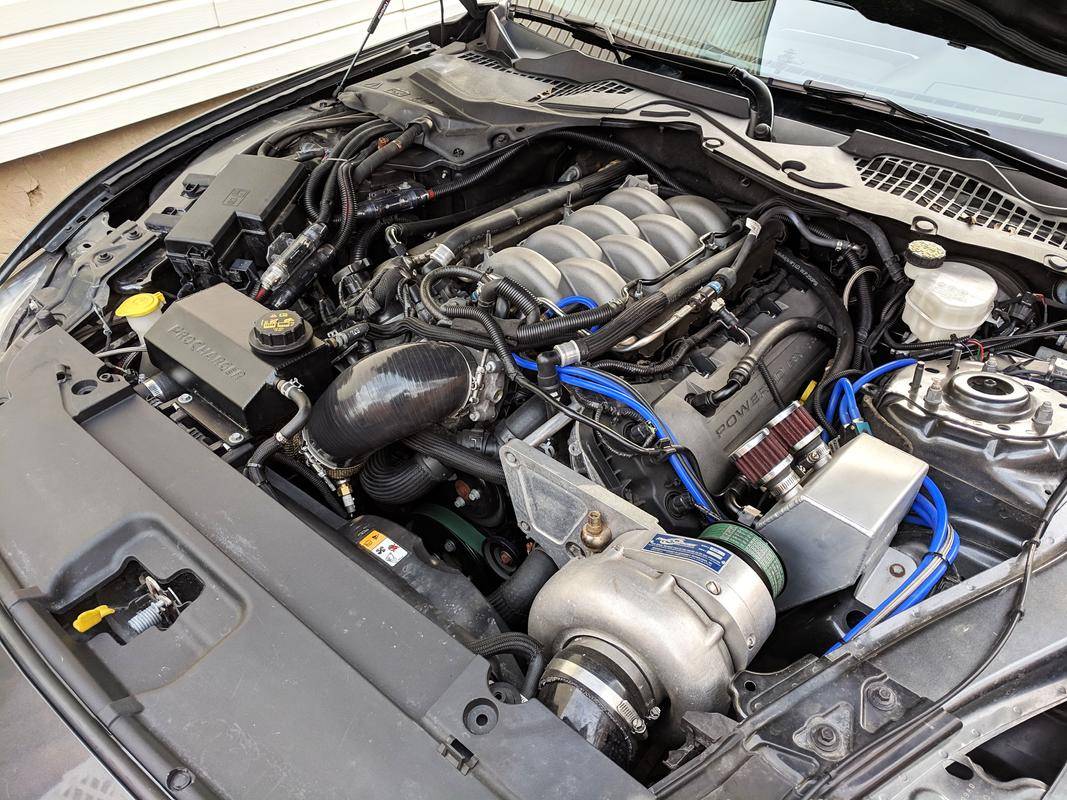

The hard pipe between intercooler and TB will need to be cut, rotated and rewelded. This is because the 2018 intake points the TB up towards the hood. Many just run it, but it won't fit well at all.

I bolted an 18 intake on my 17 procharger setup. Just adjust the silicone elbow and it fits without issue. Not sure what the previous poster is talking about cutting pipe, etc.

As I said, it fits but the 90 deg silicone coupling that attaches to TB doesn't fit great. I'm just picky how my stuff fits. So I cut and welded maf pipe.
