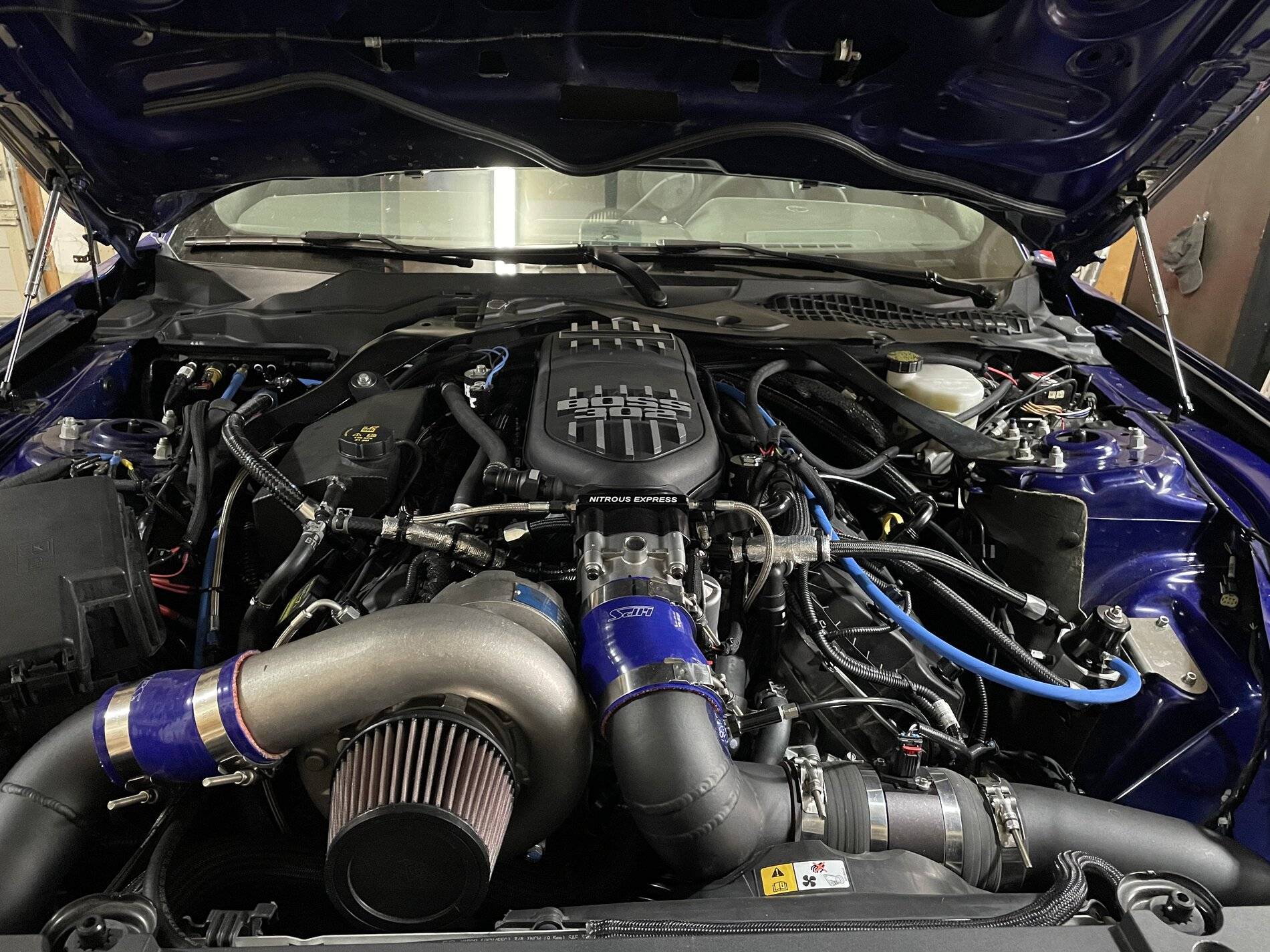

Vortech V-7 JT-b which I think is F1 equivalent? I have it pulley’d for 20psi and car is full weight. Still a centri so I was just trying to share my experience with OP with adding Nitrous to a Centri combo which works great and also lowers IAT’s significantly.That’s a sick ass pass @rainmaker . Which Procharger blower are you running?
Sweet setup. For some reason I thought it was a Procharger. I think so yes, JTB should flow similar to F1A. Sweet setupVortech V-7 JT-b which I think is F1 equivalent? I have it pulley’d for 20psi and car is full weight. Still a centri so I was just trying to share my experience with OP with adding Nitrous to a Centri combo which works great and also lowers IAT’s significantly.![]()
thank you this is what i wanted to see,8 second pass and not max effort as you stated. On your build can you pulley down any more "safely?" While adding a bigger shot or are you limited to something? Fuel, engine, suspension, or transission?Vortech V-7 JT-b which I think is F1 equivalent? I have it pulley’d for 20psi and car is full weight. Still a centri so I was just trying to share my experience with OP with adding Nitrous to a Centri combo which works great and also lowers IAT’s significantly.![]()
Yes on my build I can run more boost and/or a bigger shot of Nitrous. I believe the car will run low 8s if I spray on the hit and shorten the ramp. The only real limitation is with the Nitrous, I run a plate setup so anything north of a 200 shot would be sketchy due to potential distribution issues with the Nitrous. Same track with a 100 shot, long ramp:thank you this is what i wanted to see,8 second pass and not max effort as you stated. On your build can you pulley down any more "safely?" While adding a bigger shot or are you limited to something? Fuel, engine, suspension, or transission?
