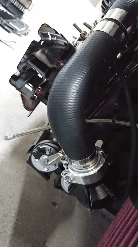

Looking to upgrade to this. Are those the hoses from the factory Procharger setup?
Jdotrizzle
Nov 6, 2020
New york
Jesse
2016 Mustang GT
I think so. Obviously we have less flexibility because with the stage 2 2” flange, you have the option of the race valve but with the 1.5” we basically need to go to outside sources or settle for the bullet valve

Perfect. I will order it today then and hopefully have it installed soon. I look forward to my car hopefully sounding like a jet plane

You can run a tial 50mm and any bov that the stage2 can run. Just get a weld on flange or a coupler with the flange already installed
