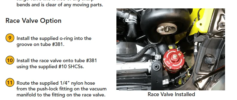

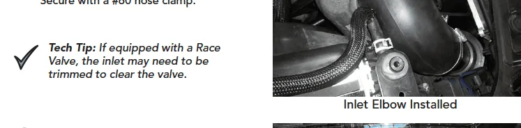

Ok back to the intake tube , I can see NO place were the intake tube has sucked in or touched the impeller.. That makes be very happy to see that after seeing this post .. I'm running more boost than the OP was but I'm also running a smaller PS-1 head unit .. I think just for peace of mind I will get Boost works intake tube once they release them ..
No reason to worry, since other then this occurrence I have not seen another person with our current inlet have a failure.
Again, BW wants to post about incorrect facts to back up his post.
1) His thread about Coastal, was based on Coastal experience with our OLD first inlet hose. That hose hasn't shipped for well over a year, all customers were given updated parts if they wanted. (Many chose not to, and still run the old inlet with no issues. Since that old inlet hasn't shipped in over a year, and only to the first few shipments, it seems to have never come up, till BW wants to dig up old dirt (not facts)
2) His thread about his own experience previously, was again based on the OLD inlet, not the current production parts.
The ONLY, and I mean ONLY time I have seen one of these new inlets have an issue, is when they are used with a "Race" valve bypass valve. Which is NOT part of the system, and is an add on item that customers have to purchase separately. (or can upgrade to)
The instructions show how to install it. HERE ARE THE IMAGES!
These are the ONLY time its mentioned in the install.
Since its a.......race item.
Can that valve fit without pressing on the inlet tube. (YES) I have installed them myself, its a pain, but they can and will fit. Are there other places that fit it better, however require cutting the car up... yes. Again, its a race item, that 99% of the customers don't even need, since the standard valve is good up to at least 700-750rwhp.

Yes, the first inlet was a little less stiff, so even MORE prone to having an issue if the Race valve was pushing on it. I am sorry you had issues with that early unit. :(
Not that it wasn't installed correctly, but it felt soft and the Red Race Valve was pretty much pressing against it. Remember this is a D1SC with an 8 rib belt. Installer said and showed me that this is the correct position for the valve. I looked at the instruction manual and sure enough it was installed correctly based on the instruction manual from ProCharger.
If its pushing on the inlet... its not installed correctly.
I can tell by the photos of your inlet, a LOT more needed to be cut off.
To bring that bend in MUCH closer to the supercharger.
Again, I have done it myself... so I know it takes time, but it fits.
Now THAT is what I am talking about!!!! That is awesome!
