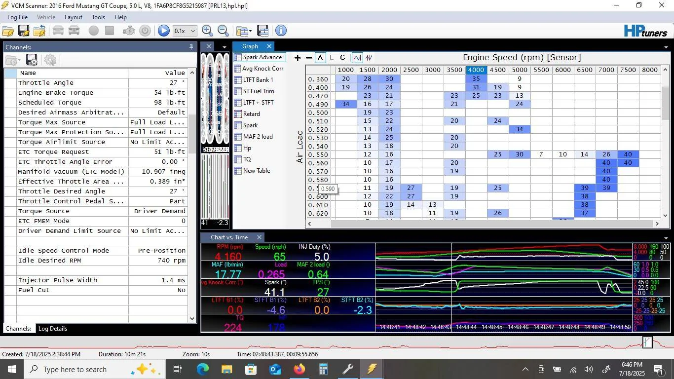

Two issues right off the bat.
It is staying in torque control throughout your pulls. Looking closer it is using driver demand.
It is commanding 40 degrees of spark advance. ( this is too much even on straight alcohol)
You didn't log knock so I don't know if it is pulling enough spark to stay
out of detonation. I would not go WOT with this tune.
My advice is to find a new tuner.
yea i had my friends tuner look it over he said the same exact thing and im now gonna be tuned tonight by joshua from 5star tuning he was gonna blow
up my engine!! I really appreciate everyone help 🙏
