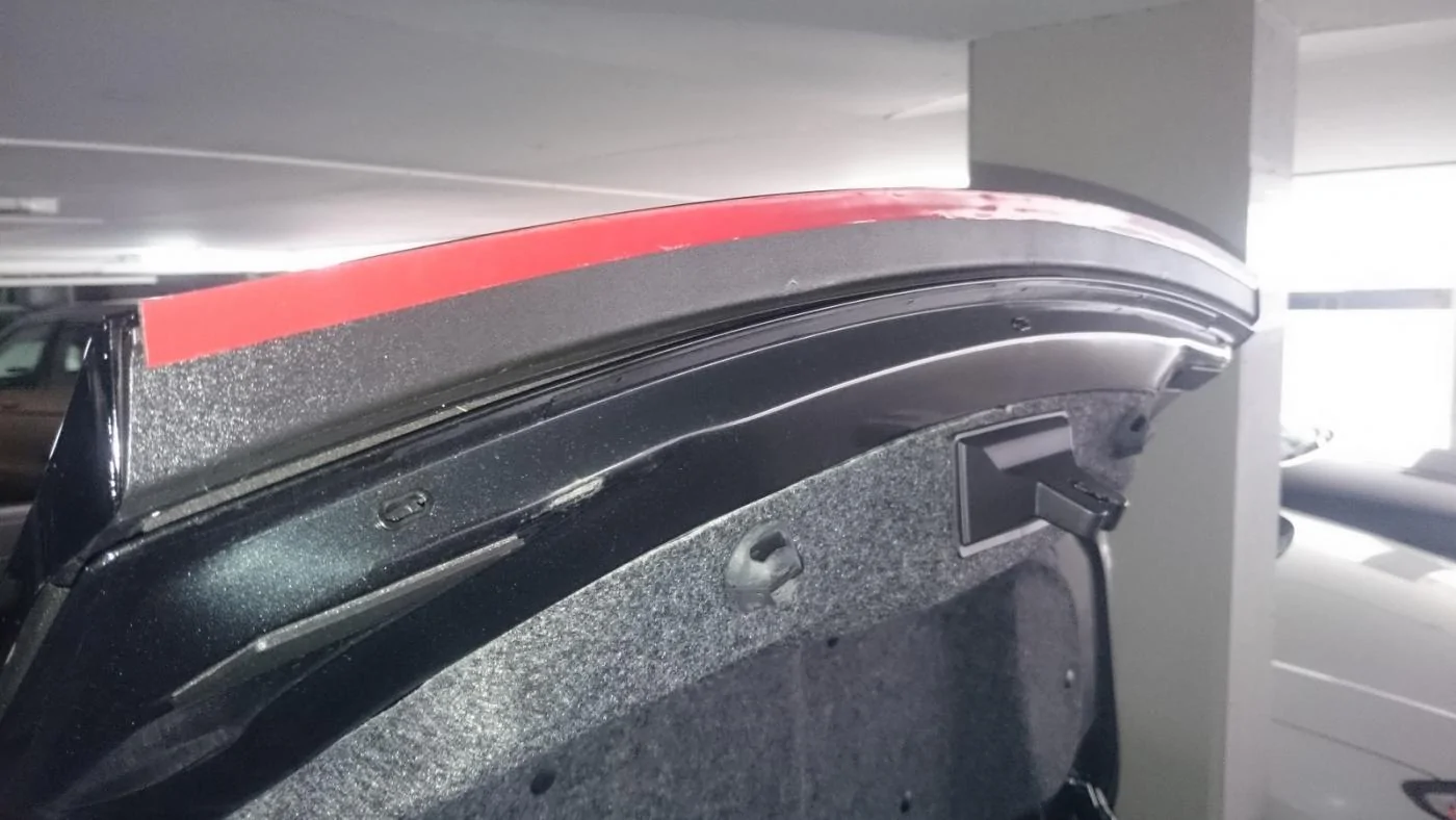

The funniest new issue for mine is that I had noticed that the boot rear decklid panel was indeed scratching the paint on top of my bumper.
Except it was not misaligned - the boot and decklid are actually quite well aligned in my case.
What you will find tho, is that as you close the boot, even ever so softly, the decklid panel does come in contact with the bumper. I don't know what flexes so much, but it does.
The solution for me was some double sided 3M tape along the bottom of the decklid, but I left the red strip you're supposed to peel off on the other side.
It sticks real well because 3M, and forms a soft close surface as well as a soft edge when lifting up the boot.
Now it feels downright luxury :headbonk:
Great fix - where did you get the tape (good colour as mine is ruby red )

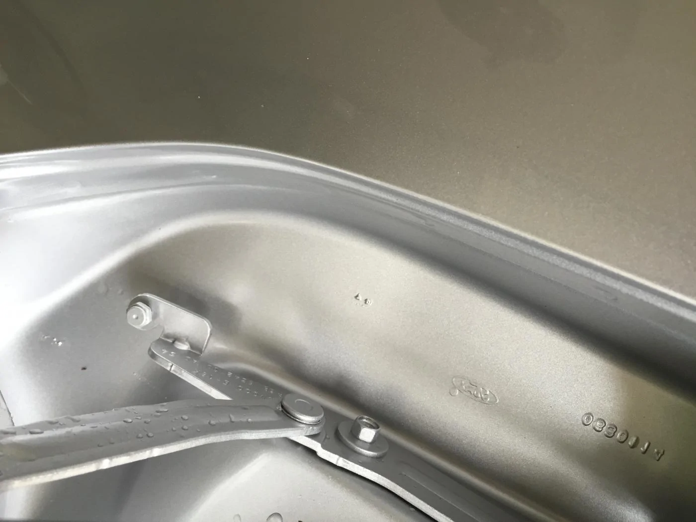

Anyone have this issue on the inside of the boot well on both sides?
Looks like something dripped there before painting.
The other side has cracked off and exposed the metal.
Repco or Supershit should have it :thumbsup:
You mean what look like water droplets? Or is that water?

and now I've noticed by passenger's side one is going too (I wonder whether Titan Ford will accept my word for it this time and order a part in advance without having seen it???)
Titan Ford? not a chance!
steerage250
Jan 7, 2016
255
159
Perth
Ian
2016 GT Fastback, 1928 Model A Ford
they have ! :) (will let me know when it arrives in stock)
They are now stocking the driver's side one - but not (yet) the passenger's side one
