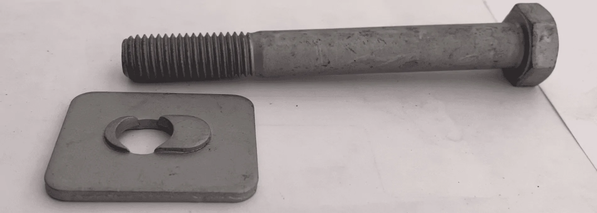

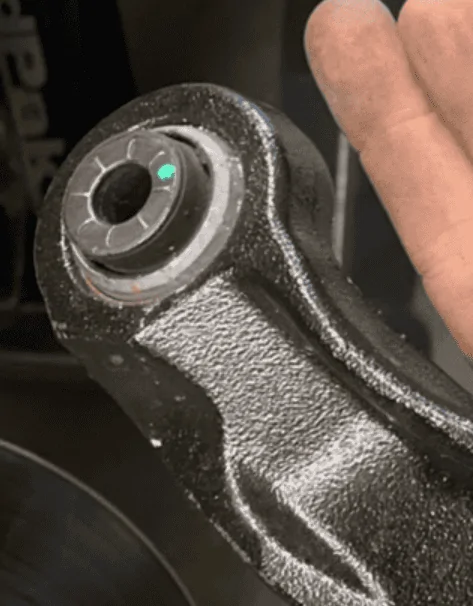

When you guys install an aftermarket upper control arm, how did you address mounting it on the subframe end, since it has that eccentric hole? Does it slide one end or the other and just lock it down, do you try to make any adjustment with the factory hole, or does something come with the new arm to just lock it into a position? (I understand once tightened in place, you don't use that to make adjustments anymore).
BMR posted a set of camber change vs suspension motion charts on a forum - might have been this one - Google should be able to find them for you. In any case, the curves looked best with the upper control arm pushed all the way in (toward the vehicle centerline) rather than all the way out.
As for how to keep them there, I'm using the locks from my set of SPC arms. There's no real evidence that locks are needed with the OEM arms because they have ridges on them that lock them in place when they're torqued down. Aftermarket arms tend to have smooth faces, so locks are good.
OEM arms with ridges to lock it in place after tightening:
Here's what an SPC lock looks like - I used the ones with the hole right at the end to hold my BMR upper arms in place:

damn, i never considered the geometric gain to be had by putting the upper pivot max inboard. Pretty sure I used the inboard position but didn't really think about it at the time.
