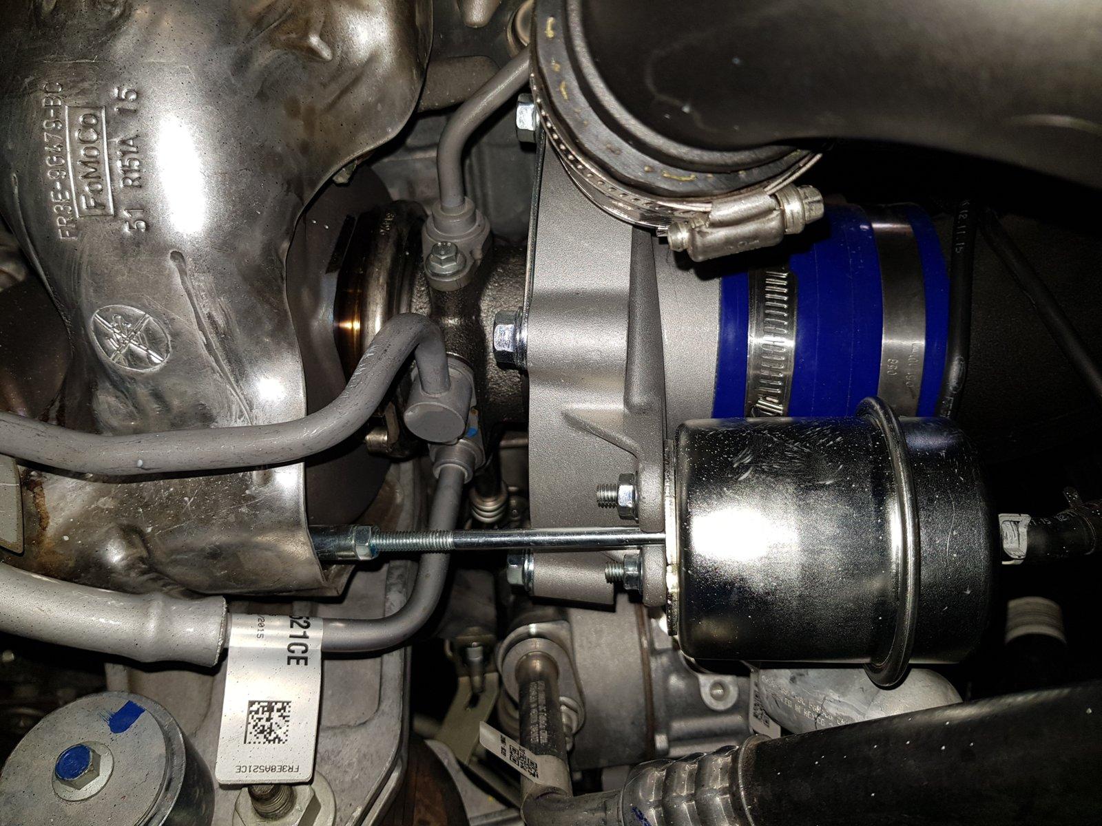

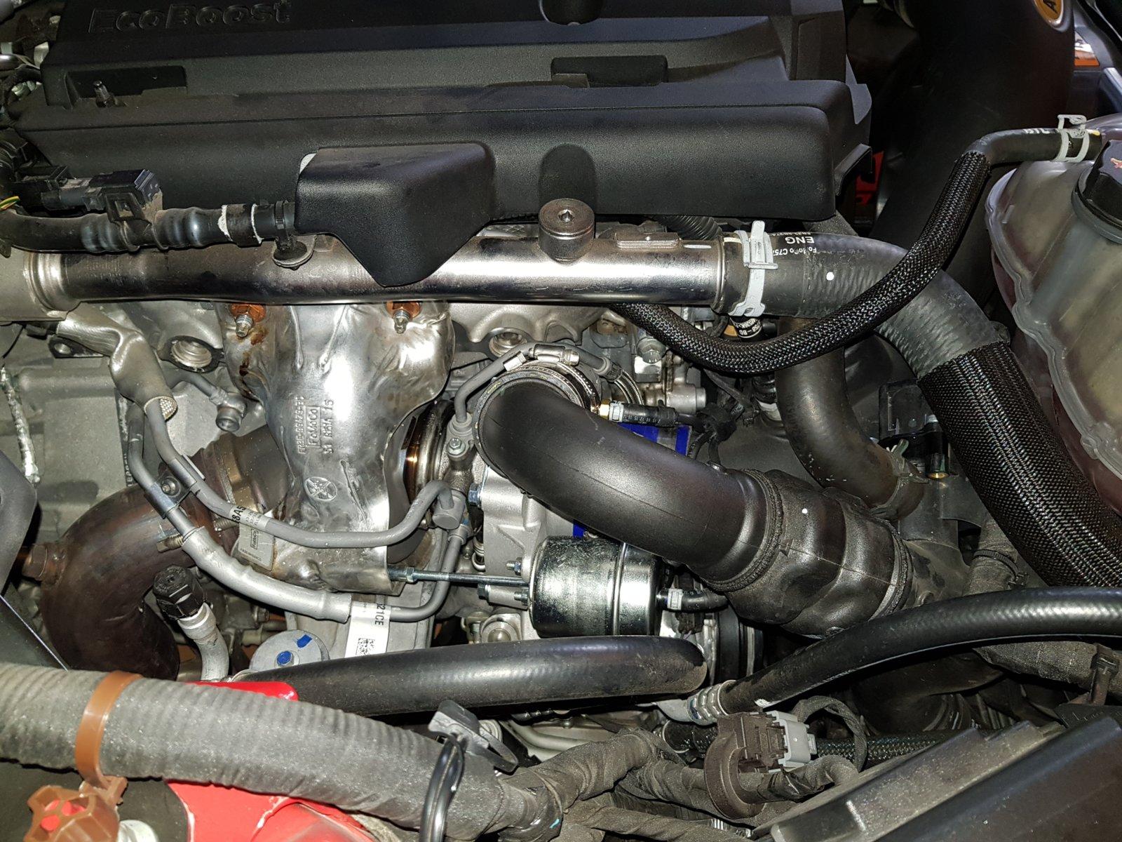

I decided to create this thread so that people who have already installed the PTE NX2 turbo can post information about the installation, their experience, advice for other people, questions, dyno results, datalogs, etc. Hopefully with time the information posted here will help other people interested in this turbo kit find the answers to their questions. So, feel free to post everything related to the Precision-Turbonetics NX2 turbo.

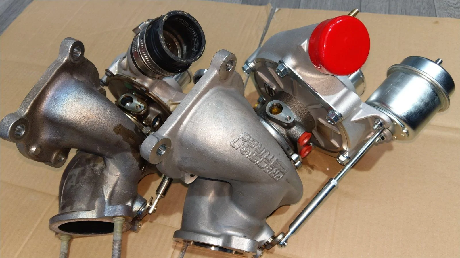

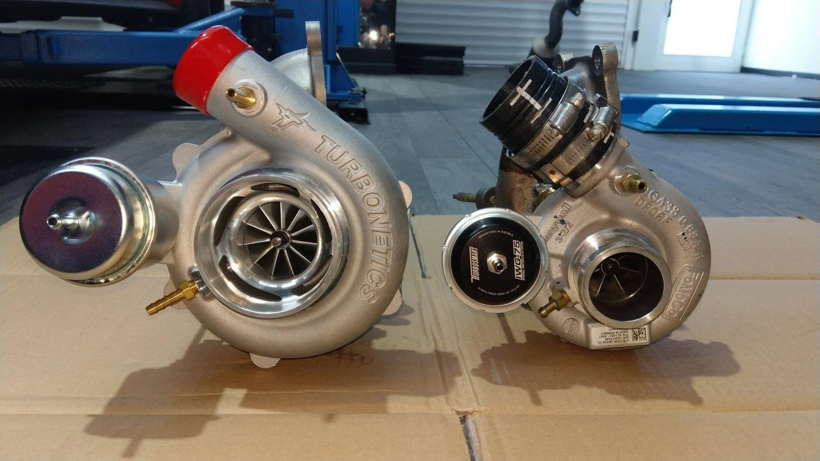

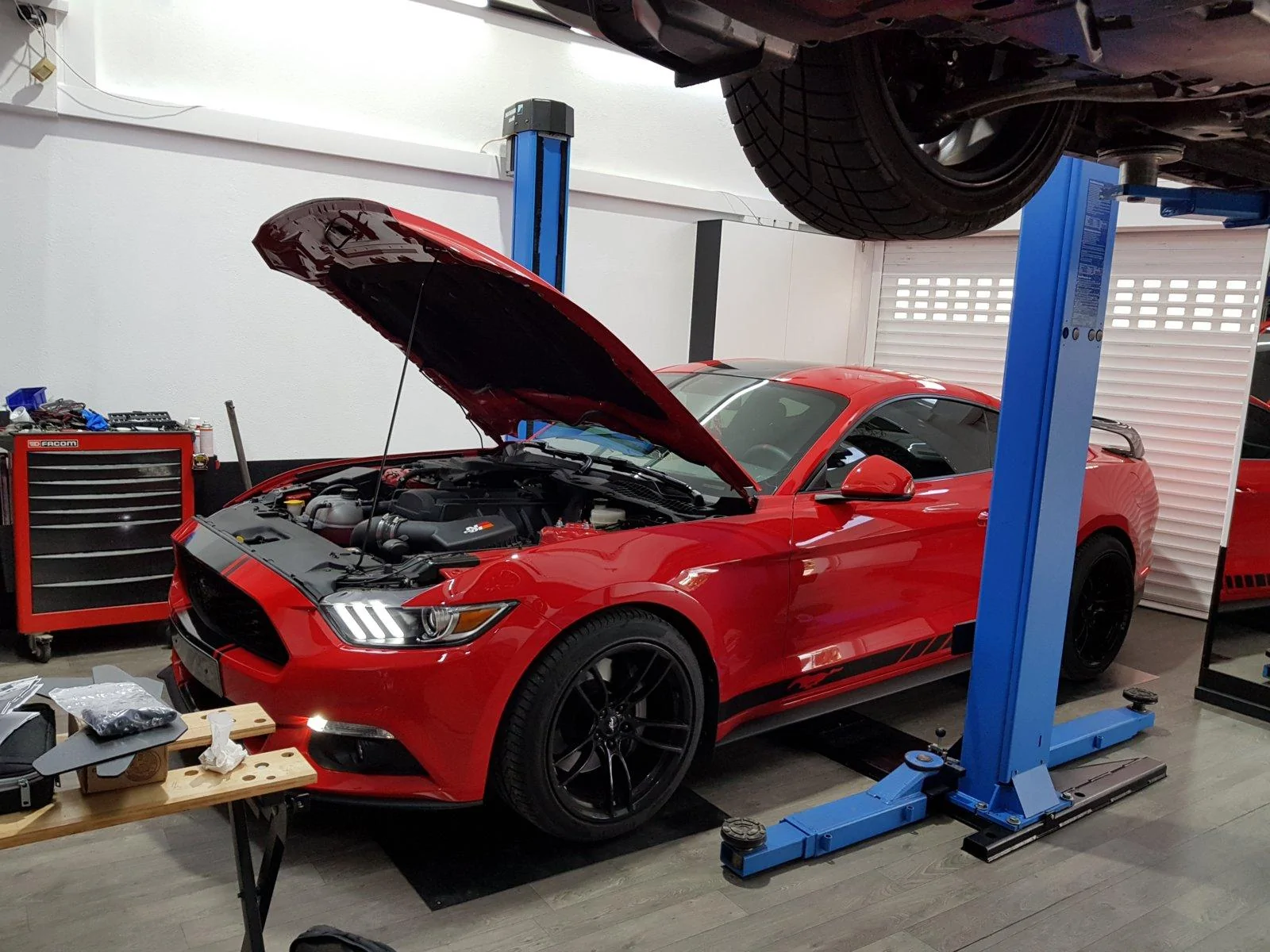

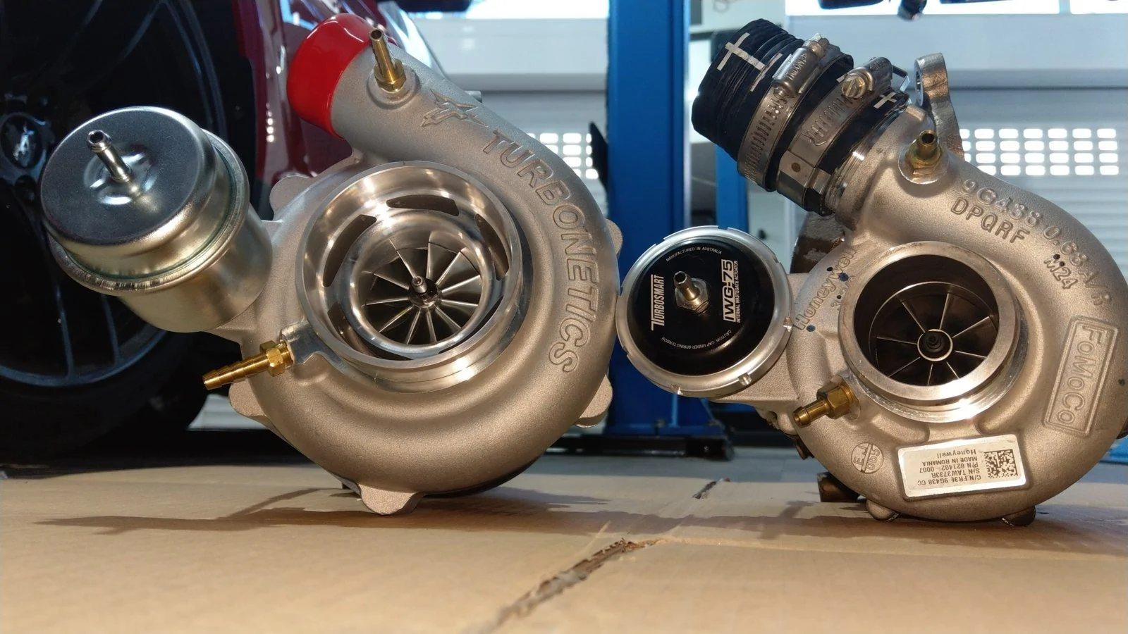

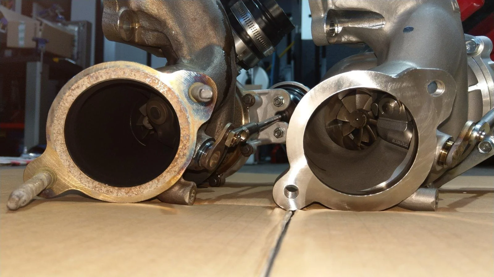

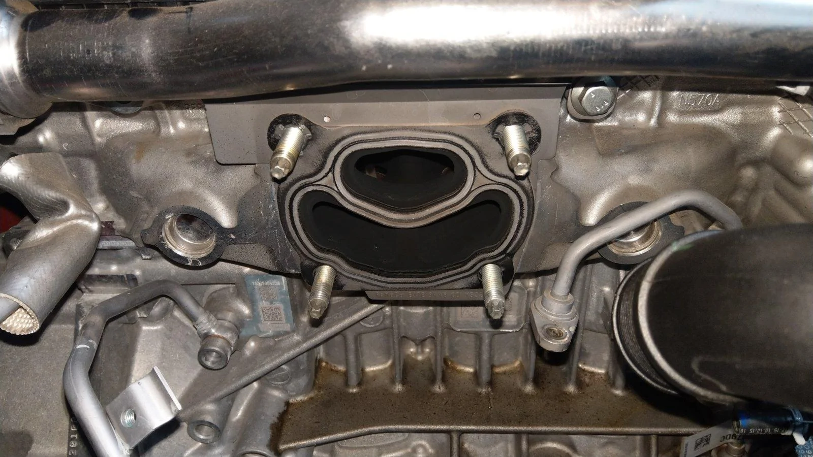

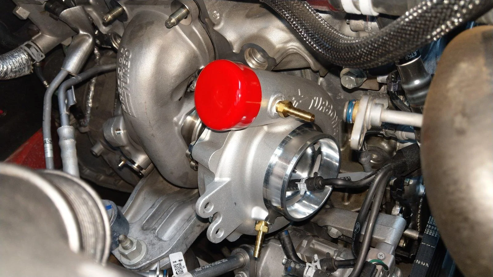

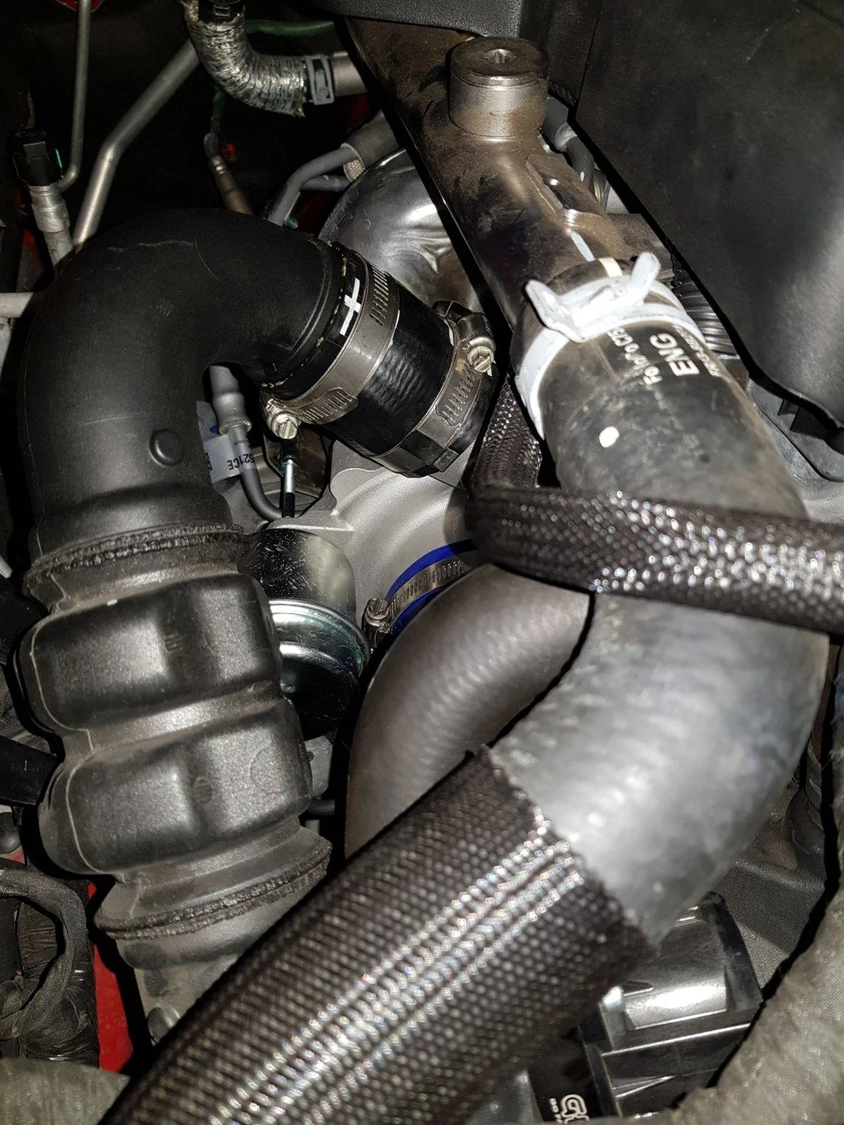

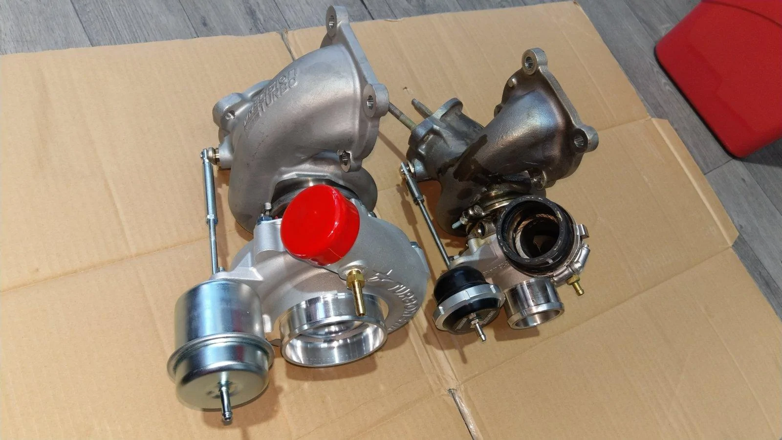

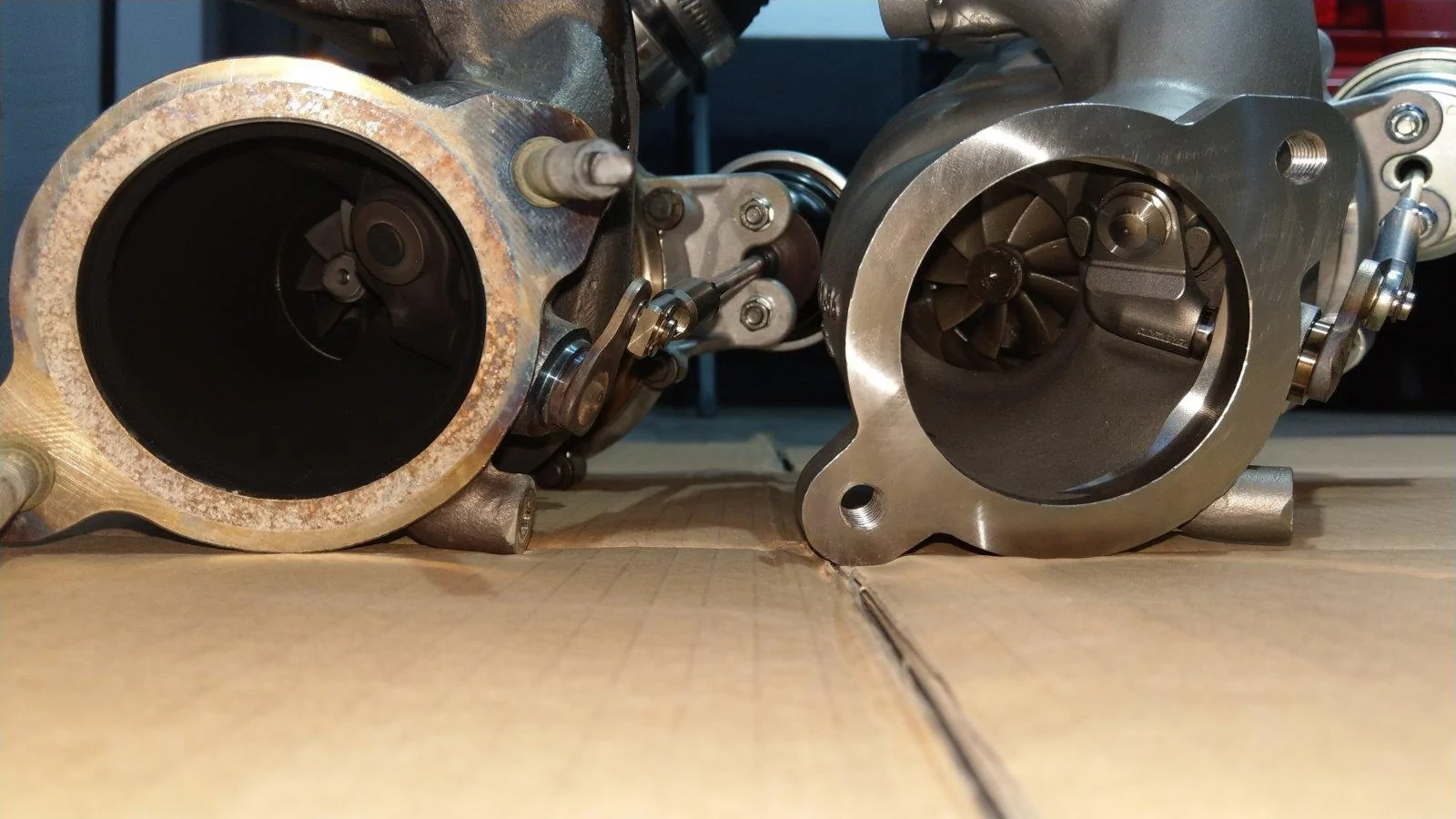

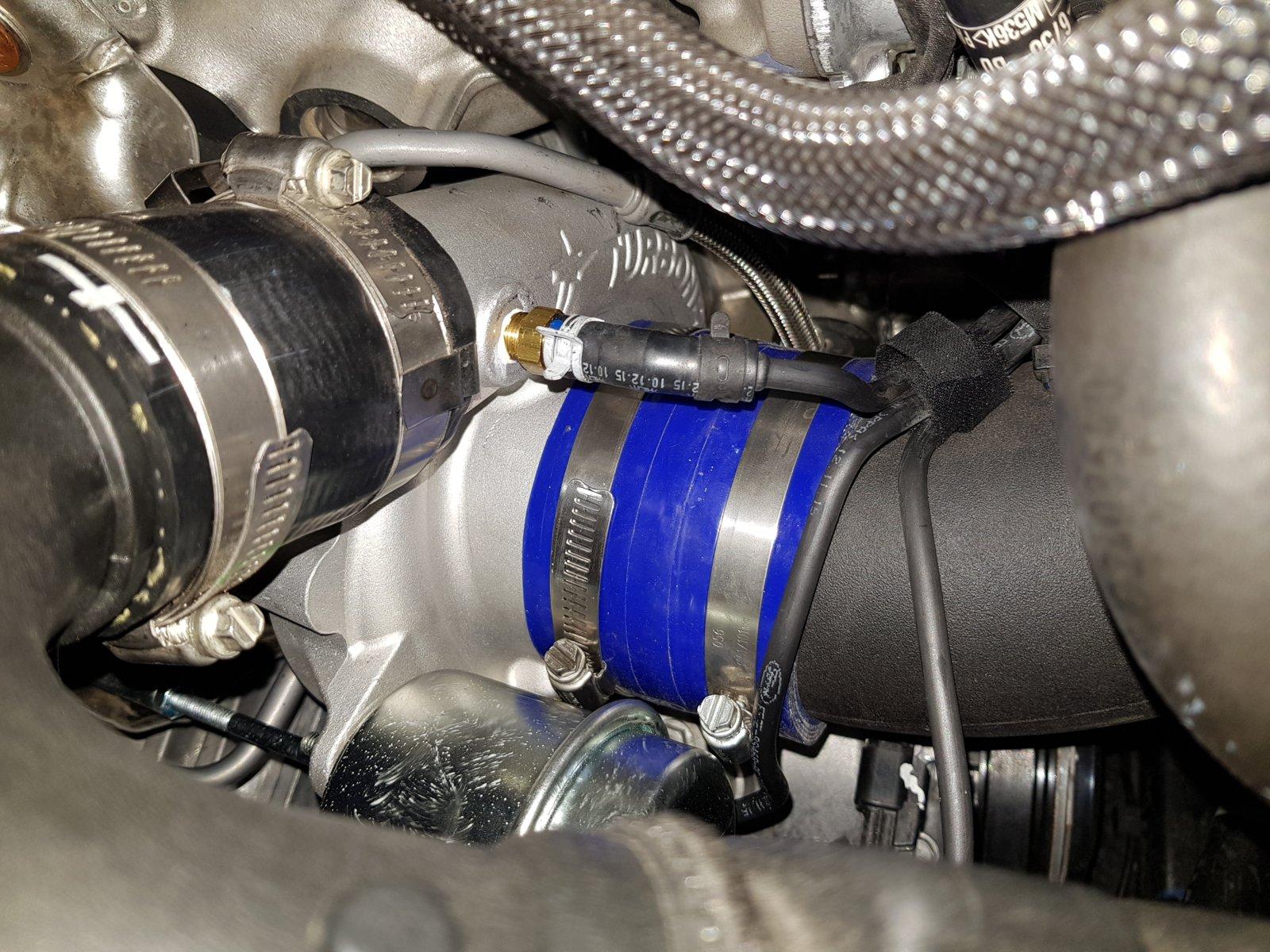

I will create the first post, as I just had the PTE NX2 kit installed on my car. The photos below show how it looks compared to the stock turbo before the installation and after it was fitted on the car.
As you can see the PTE is significantly larger than the stock turbo. The wastegate actuator is a large silver canister and the mechanic who installed the turbo told me that the spring tension is much higher compared even with the Tune+ WGA that I had on the stock unit.
Adam sent me the base tune for the new turbo and I had the opportunity to drive it for a while last night before doing the first datalog this morning. First impression is that the car pulls all the way to the red line, even with the base tune. Also I didn't feel any lag at the lower RPMs and this made me happy, because I liked the behavior of the stock turbo at the low RPM range. My only concern is that I observed a couple of boost pressure spikes, one at 27.74 psi and another one at 27.95 psi during spirited road driving. During the 3rd gear pull the boost pressure topped at 25 psi - still high, but I suppose that the revised tunes will improve this.
I will update this thread as I go through the tune revisions.
