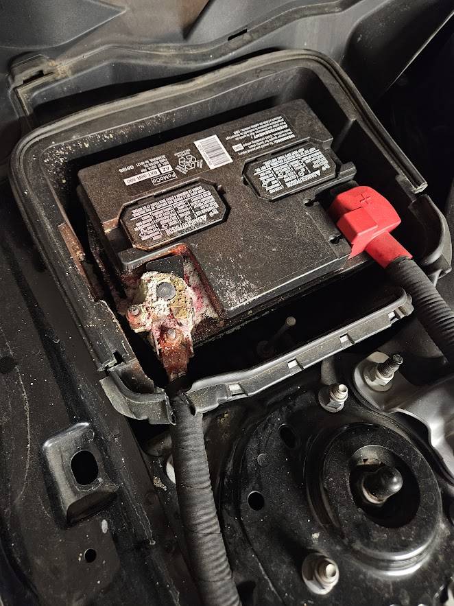

I've had terrible luck with the original Motorcraft battery. Have owned a used '16 GT, 19 GT, and now a '19 Bullitt all with the original battery. And every single one leaked acid like crazy around the negative battery post. This was my '19 Bullitt when I got it a few months ago with 36k on it. (But at least I got a decent chunk of change off the price because of the battery)
TLDR, I'd get rid of it immediately and replace with another brand, especially at 5 yrs old.
