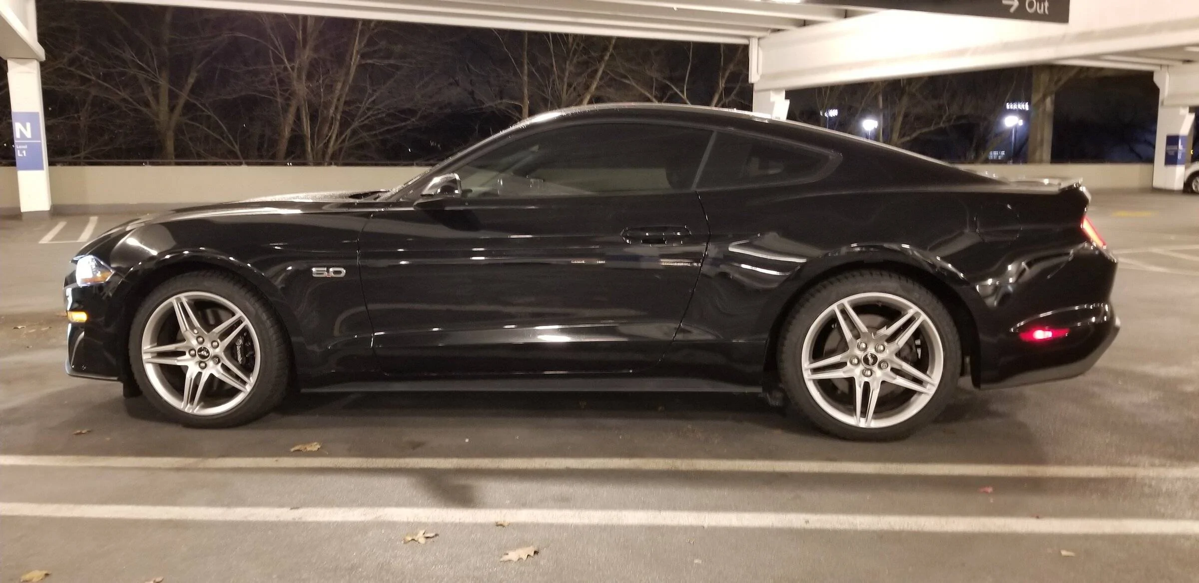

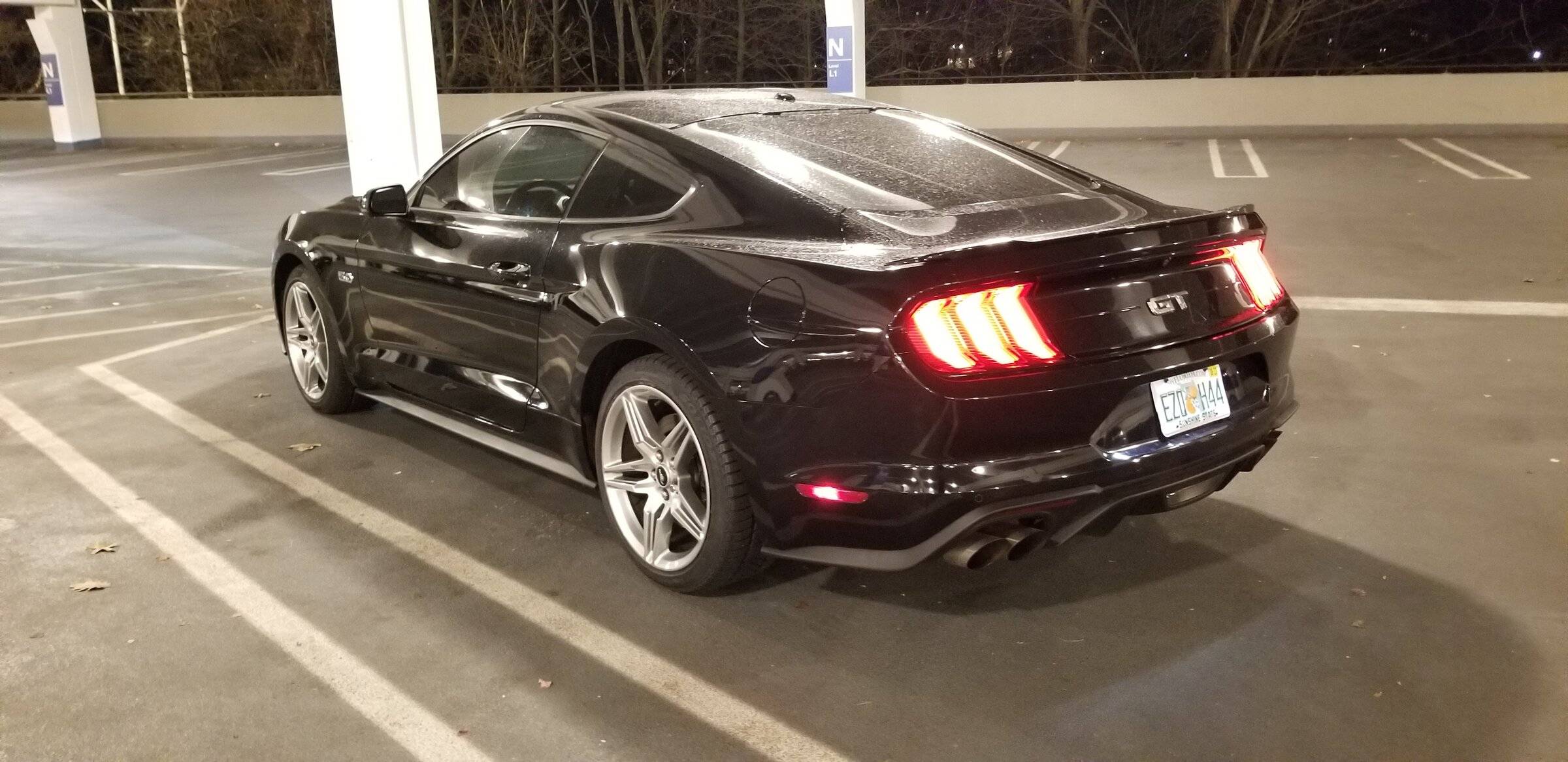

It worked great for me. PP1 wheels on a non PP1 GT premium. This car originally had the 20" wheels and is optioned with 3.55 gears.

Looks great, and yes the rims will fit.

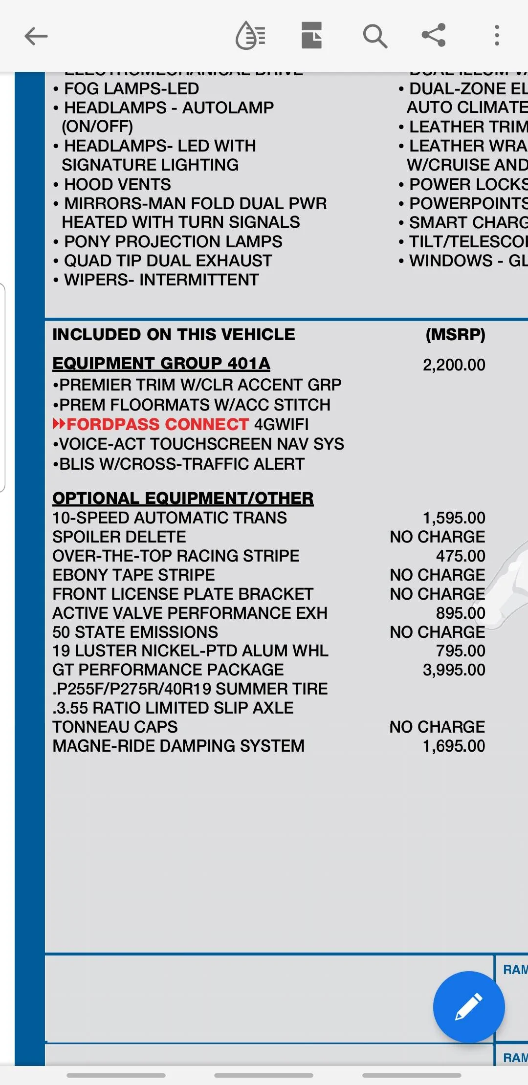

Those are the optional upgraded wheels. They were a $795 option in 2019. I think they're even more expensive now...like the rest of the options.

Those aren't part of the PP1 package. But, no not all PP1 wheels are black. For some years and/or markets, that wheel was available in nickel. Nickel was around $200 extra MSRP when I ordered mine. You don't see many in the US where most Mustangs are bought off a lot and dealers could lose more sales over the higher price than they would from not having nickel sitting on the lot, particularly when the typical buyer doesn't even know the option exists.

Yes and no. They aren't part of the PP1 package but can only be ordered with the PP1 package. So are they PP1 wheels? I'm gonna say yes. But you have an interesting point... and a nice car.
