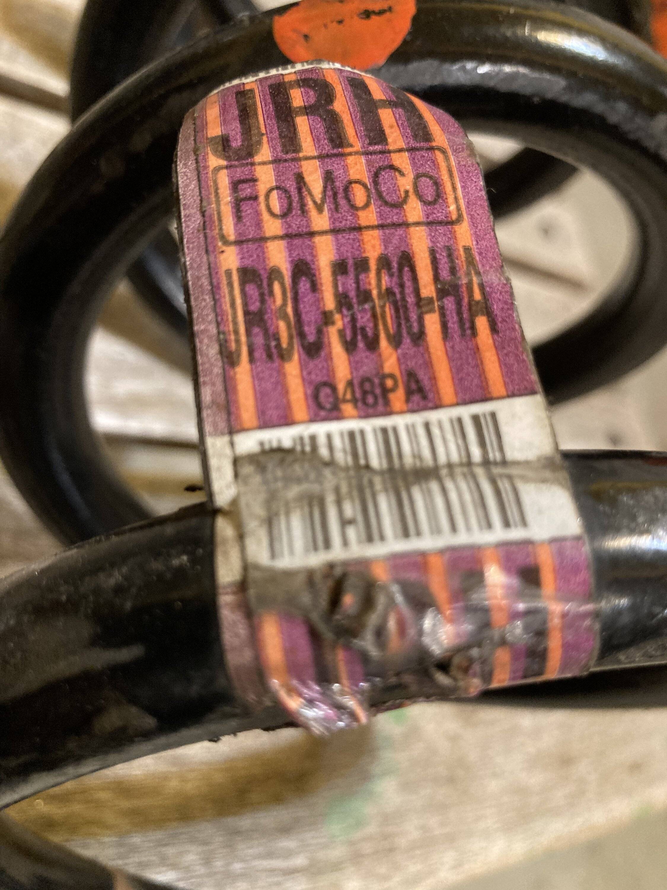

I bought some spring from a guy. I supposed they was the Eibach pro-kit because they were in a Eibach box, they were black and he said he took them from Ford. When I mounted it I found the car exactly the same. I compared the two (you too can see those circled in photos with are in the same position): the front spring (red circle) were exactly the same but the rear ones (green circle) were different, in fact the new ones were longer but with less "circles".
I ask him and he said that these were the pp2 springs. But for 2015-17 there was not a pp2 :frown:
So now I'm confused.. wtf I have mounted on?:crazy:

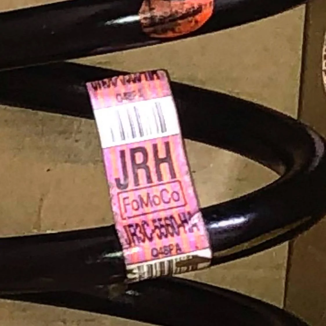

Have you compared part numbers that are on those paper tags ?

Do you mean this?
Yes. It looks like your new springs have them too, if it says FoMoCo on them they're most certainly not Eibach, JR3C-5560-HA is the actual part number.
That was the one of the new springs. And my old ones have a similar one (RRH fr3c-5560-ha).
I realized that is not the Eibach pro kit, but what kind of springs are them?

I wonder if someone bought Eibach springs, put them on their PP car (or had Ford put them on) and put the PP springs back in the Eibach box.
Eibach springs should have the Eibach logo on them. Yours don’t.
I bet you now have 2 sets of the same factory Ford springs.
Yes, I thought it but the rear springs are different and the codes on them too

this is a pic of the rear pp1 spring i just took off my car. it is the same as your spring
But from what I see you have a 2015 Gt (like mine) and from another post I read it's auto. So when you say that you have just took off the pp1 springs you mean that you put them on before, because them are not the original springs of your car. In 2015-17 there where not a pp1, just the pp, and wasn't available for auto transmission.
That code of your springs is effectually the same code of the unknown springs that I have bought.
So if that is the case I have change mine 2015-17 PP springs (fr3c-5560-ha) for the 2018+ PP1 springs (jr3c-5560-ha). So it's an upgrade, I hope..
