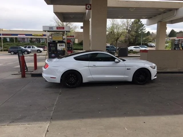

Got these installed yesterday. Install was pretty straightforward, hate those splined bolts in the front shocks, but a BFH does the trick, and living in Colorado a liberal amount of PB Blaster was needed to free the brake rotors from the hubs. Other than that for those on the fence about doing this at home, its fairly simple. Ride is great, honestly think it rides better than the PP springs and there are no issues with height over speed-bumps or getting up my steep driveway. Took me about 5-6 hours on jack-stands and a few trips to AutoZone to get a bigger hammer for the spline nuts but well worth it!

Looks great , did you do anything with bump stops or did you use original cheers

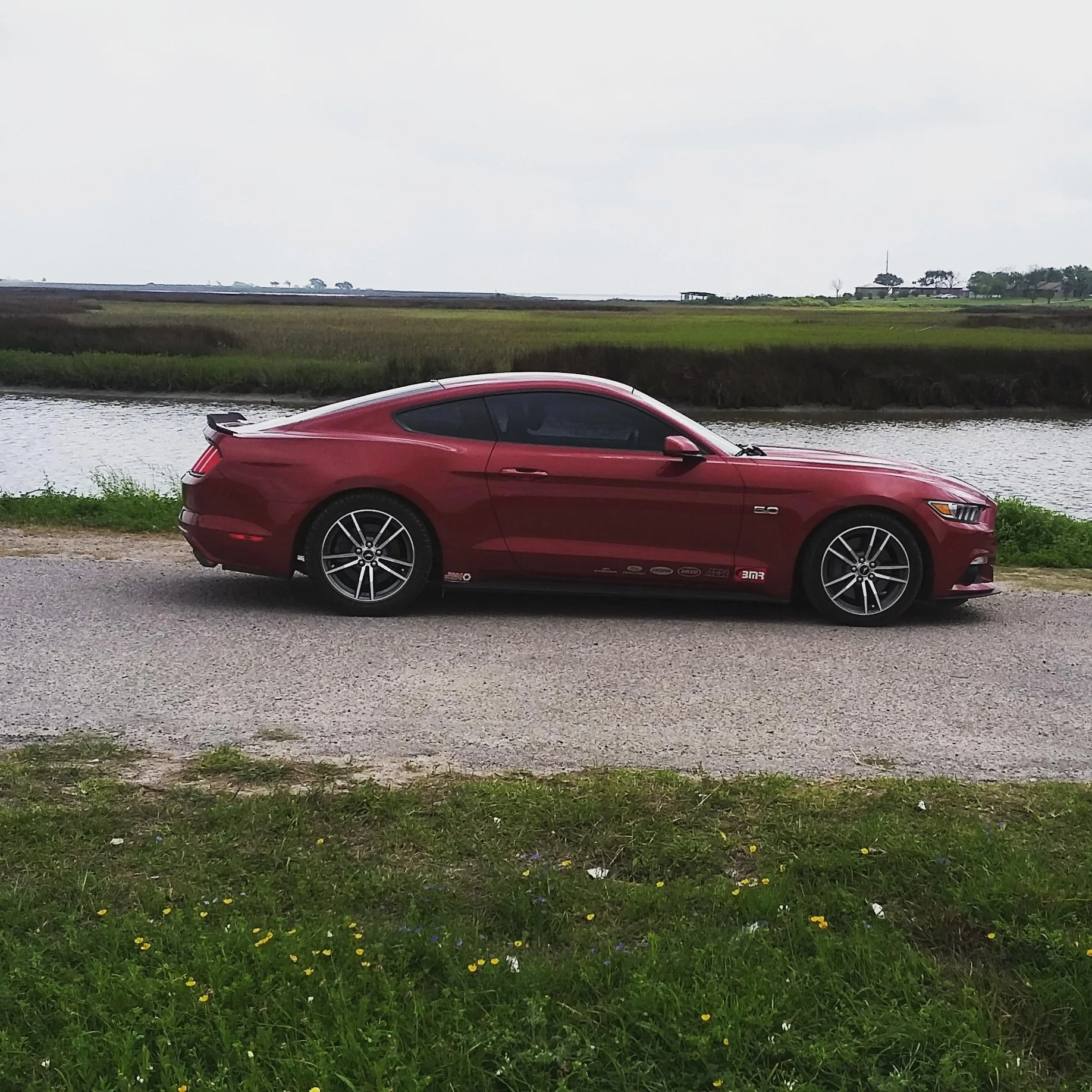

I have SVE progressive springs which are Eibach pro kit "house branded" by LMR and did the oe bumpstops with zero issues. No "Float".
Yes, replaced the bump stops all around and new shock boots on the front.
