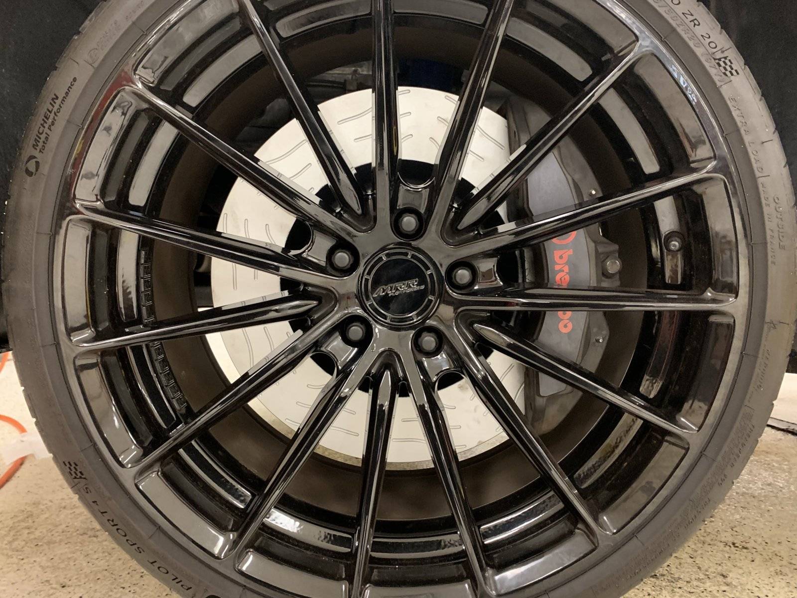

@bjstang This is off topic an hope OP don't get mad but what you used for the clear on the Hat of the rotors VHT? I am thinking to do the same but i am undecided as have read that the clear can get yellow after several time.
Thanks in advance...

Excellent. Thanks @bjstang.. Can you share how many coats of clear you put on?
