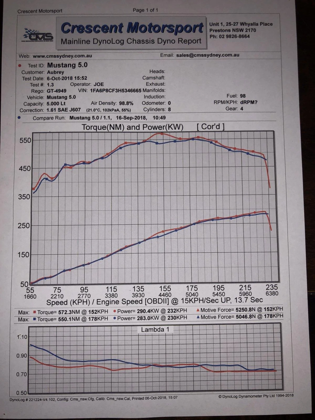

Update: I installed the local version supplied by Herrod Performance and the results seem to be at least as good as expected maybe a bit better.

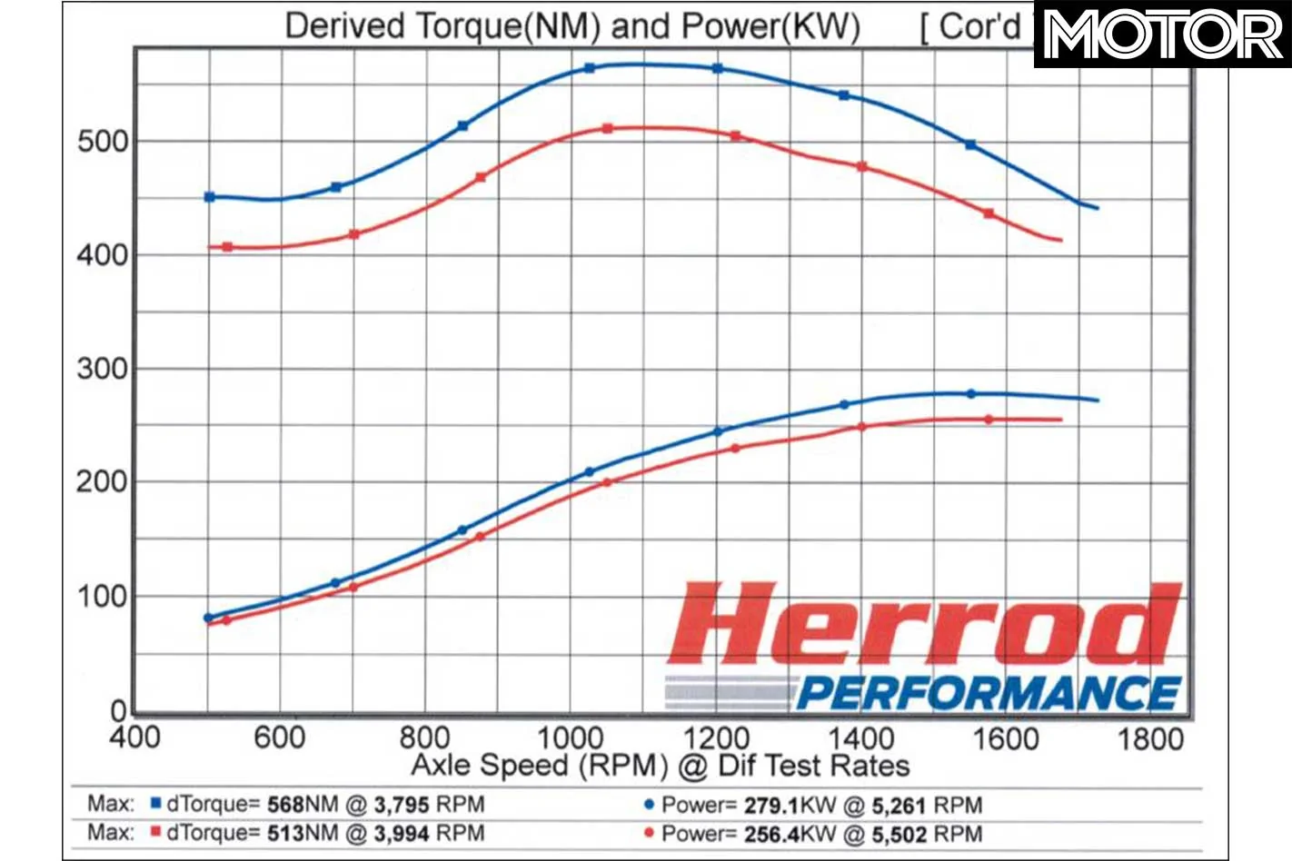

I find the whole thing quite interesting.
Herrod show a peak of 23rwkw over stock. I’m assuming they’re using their hub dyno which will tend to read higher than a roller obviously. Slight gains pretty much throughout the entire rev range. Call it almost 10% gain at a peak of 5261rpm.
You car shows a 7rwkw gain (less than 1/3 of the claimed increase) at around 6,200rpm.
Looks kinda weird to me :beer:

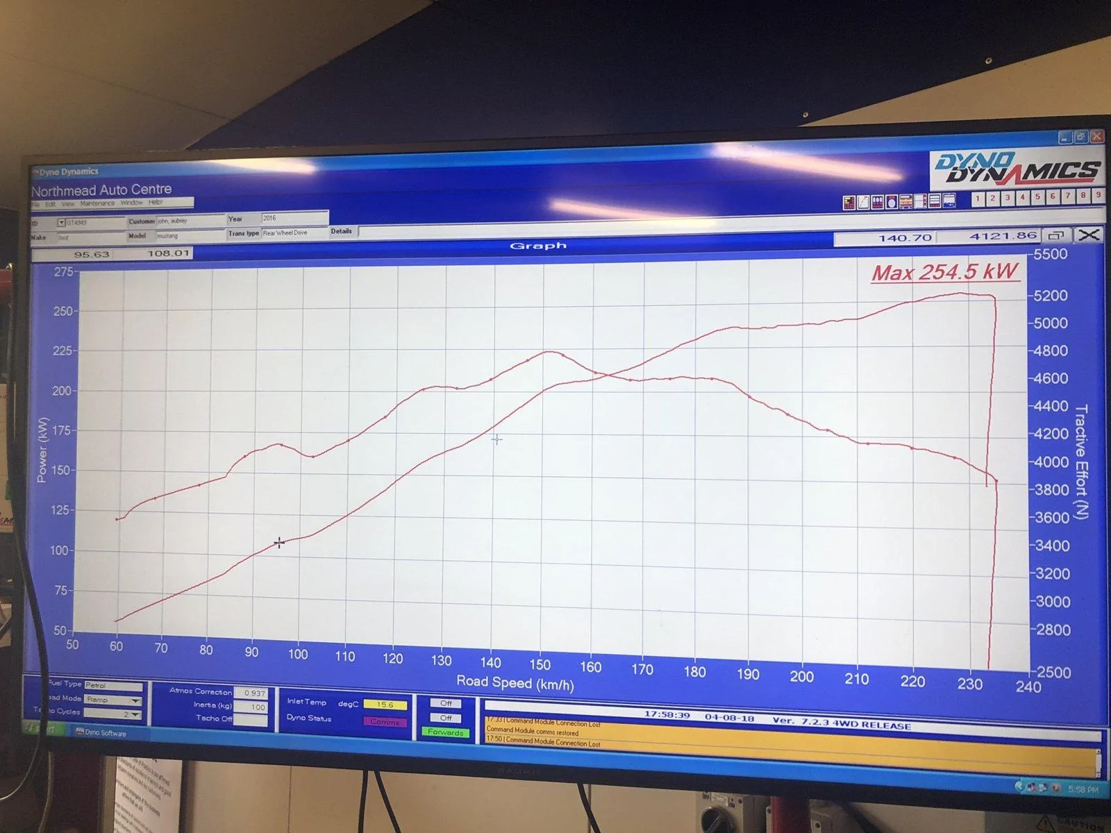

I’m going for another dyno on Friday, at least to verify the current PP2 tune and outputs. Hopefully within a small margin from this dyno.
I can’t explain the pre-PP2 results, the output seemed unusually high, and then it didn’t improve by much after PP2 was installed.

It’s weird. Very weird.

Hi Aubrey, it's a long shot but is there any chance it already had a tune of some description?

That thought also crossed my mind, they said that they did an update at the first service, maybe they loaded the wrong tune?

This is entirely possible! I heard that Ford Dealers were given a copy of the GT350 tune to start some trials on local cars in order to help homologation of the GT350 for Australia. I believe the plan was to flash the tune onto customer's cars who's displacement measured on the higher side of tolerance (closer to the GT350 5.2l) in order to get the most accurate comparison.

Haha! That would be very interesting. I have my first annual service in a few weeks, I'll see what I can find out.
