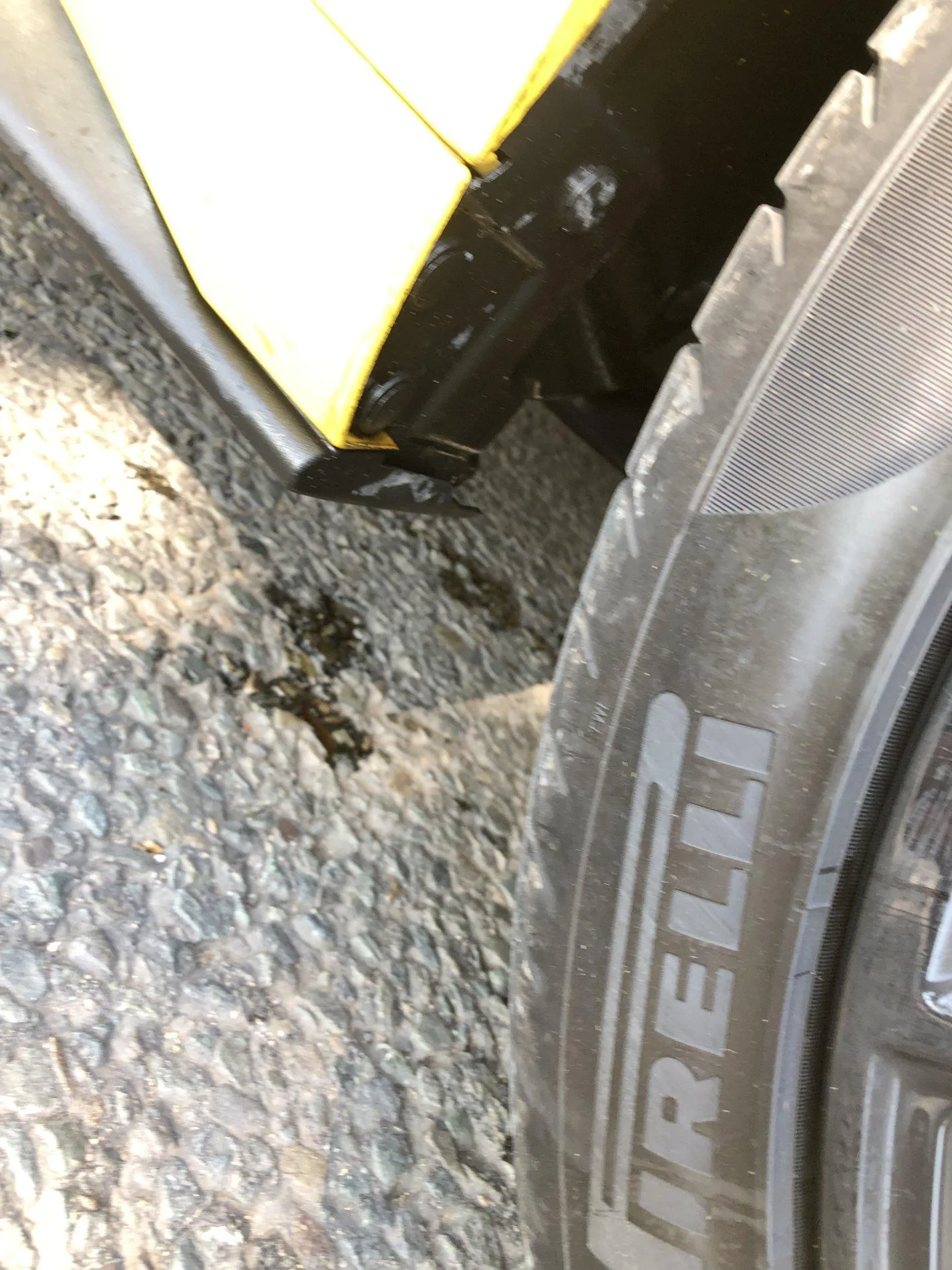

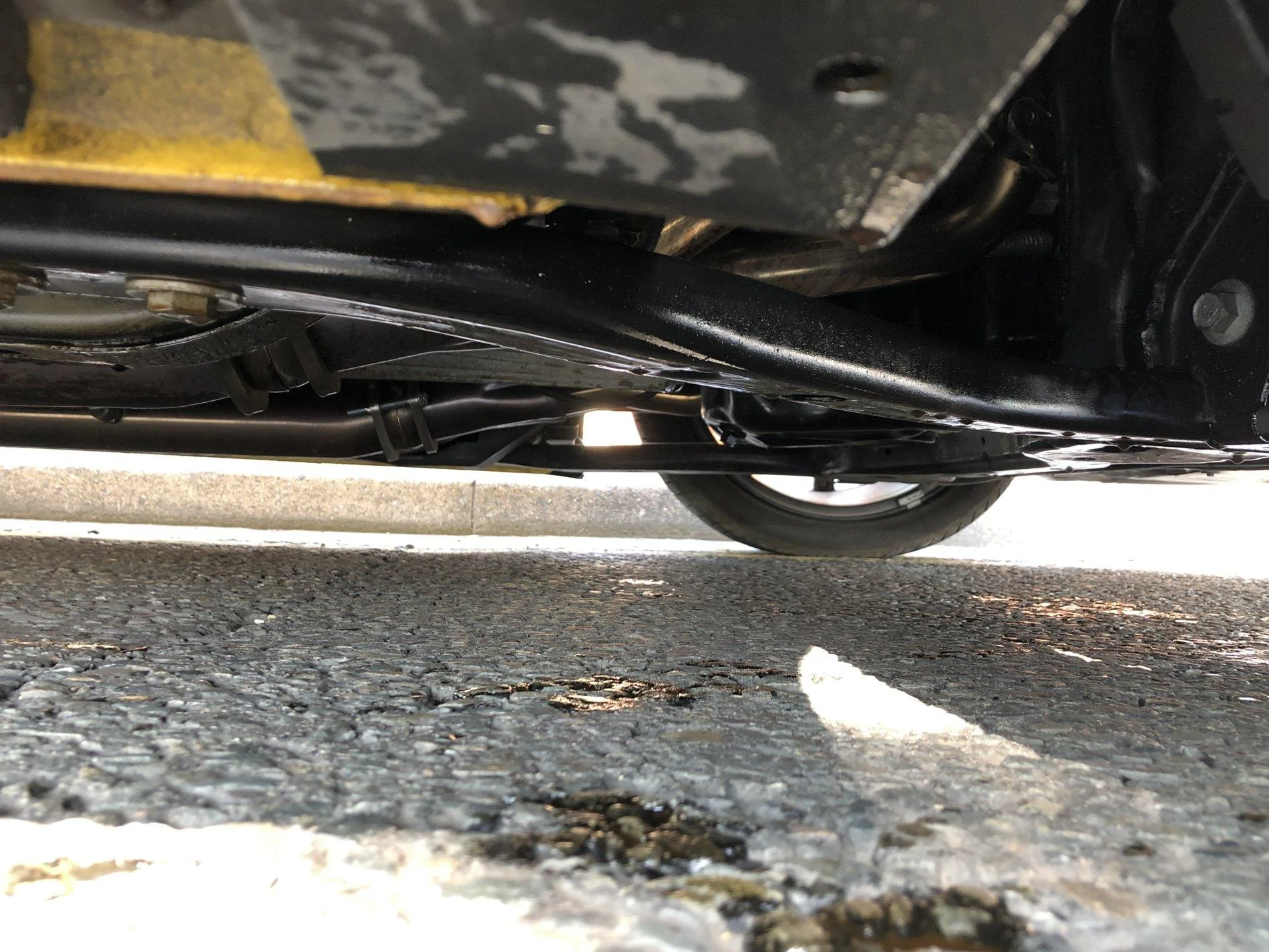

Oil everywhere!!!!! All down the drivers side of the car, in the arch liner, over the road, dripping off the subframe etc

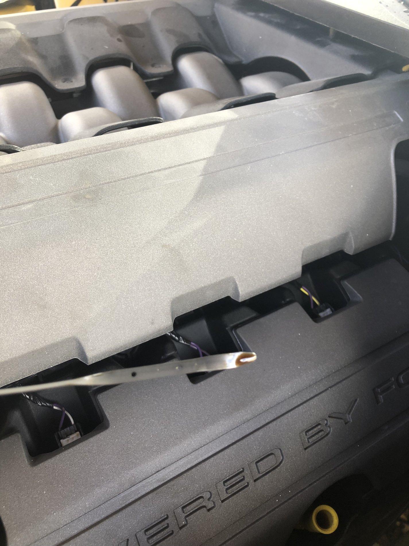

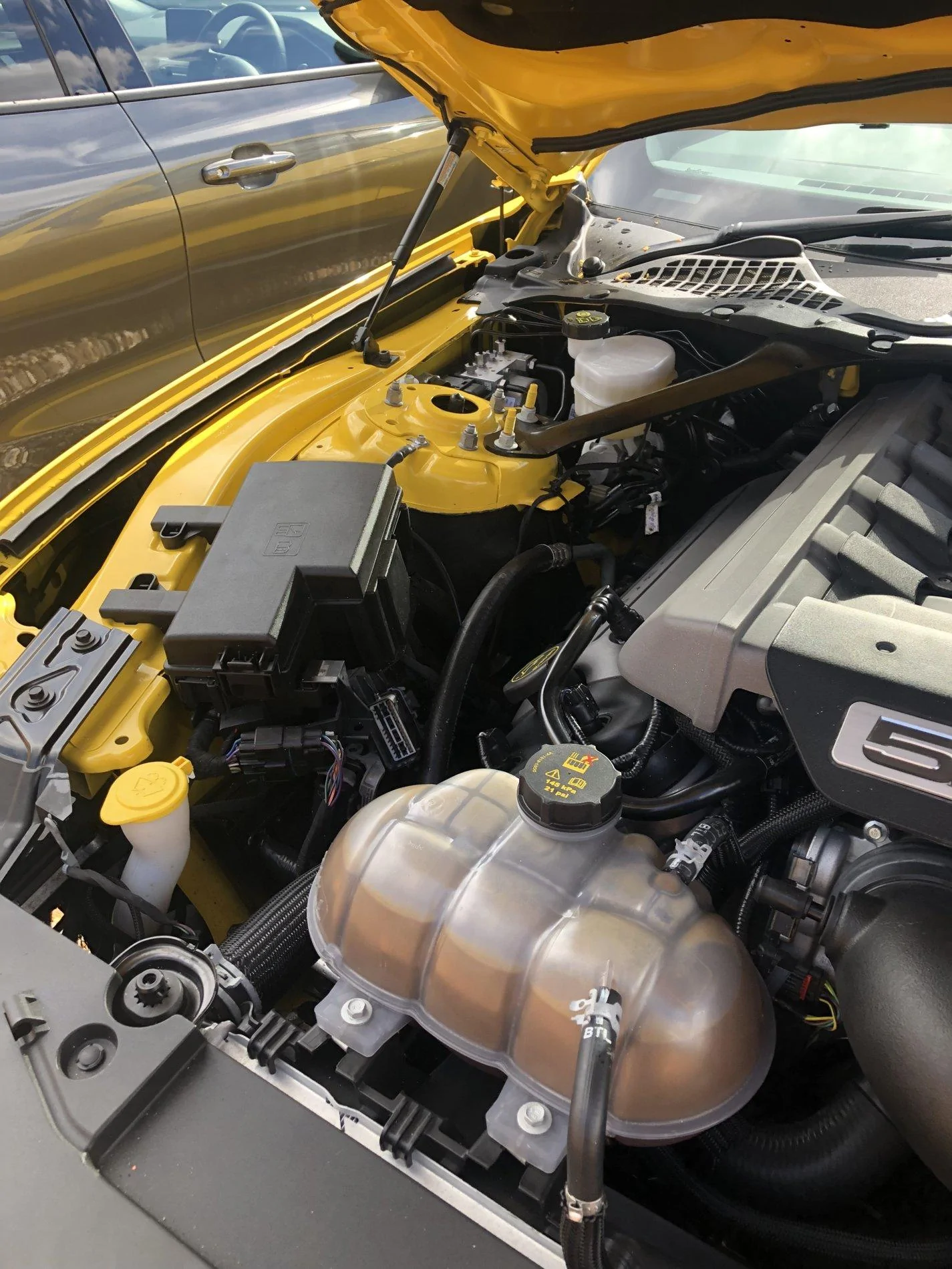

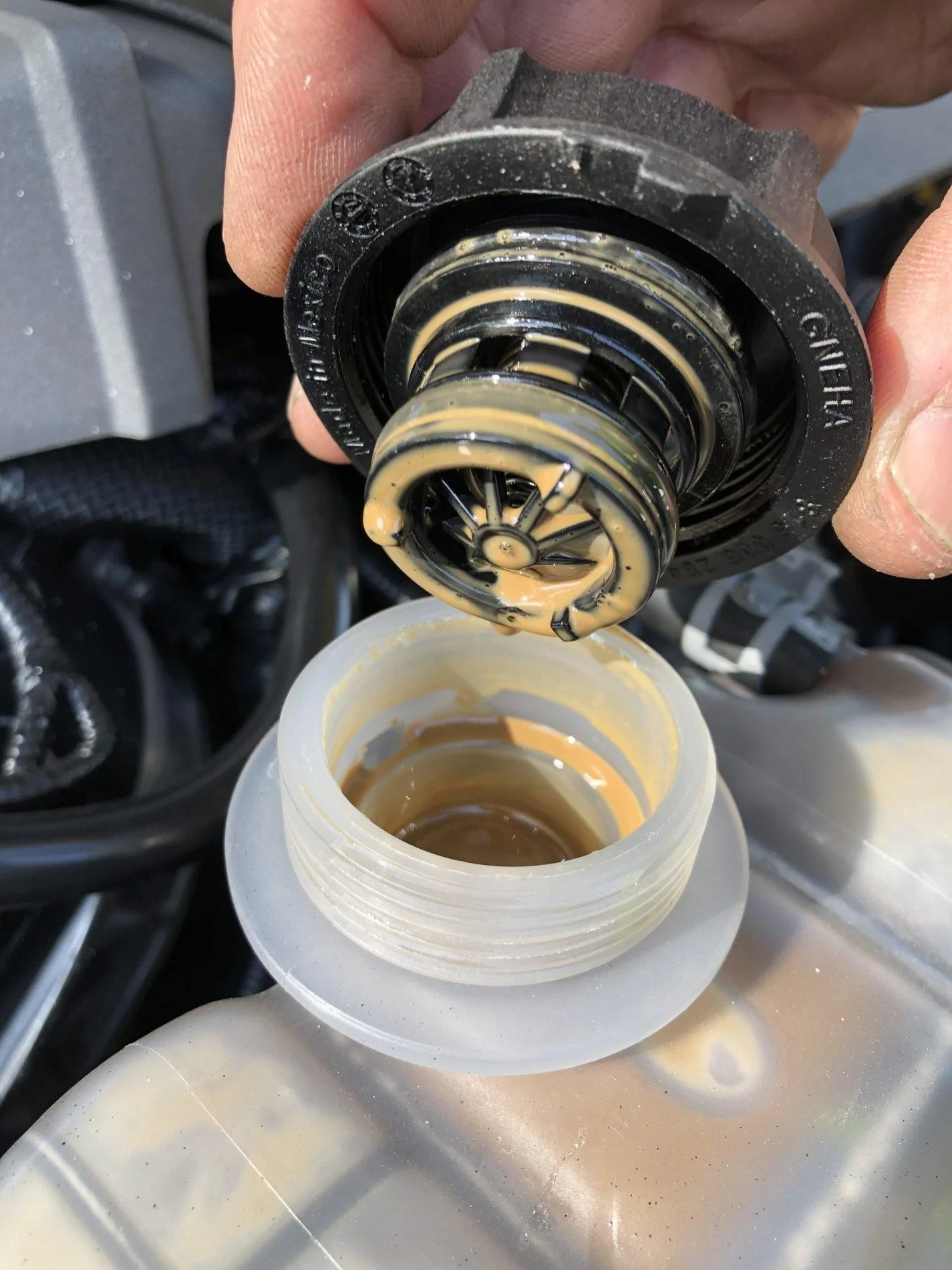

Opened the bonnet (or popped the hood’ if your authentic), much of the same, oil everywhere. Reservoir bottle clearly black and oil coming from the overflow. Called the AA who’s uninterested “technician” confirmed it would need recovering but couldn’t tell me why or what was wrong. I got him to check the oil for me which was just about/negligently on the very bottom of the dipstick.

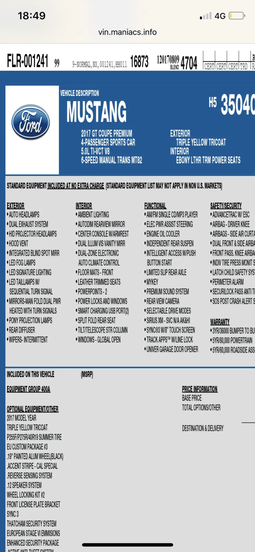

Interesting... If your build date is really Aug 17 then your car should have been built well after the oil cooler issue was resolved, regardless of which TSB you believe (one stated aug16 the other Feb 17) as the fixed date.
This leads me to believe even more that there is no fix date as such.

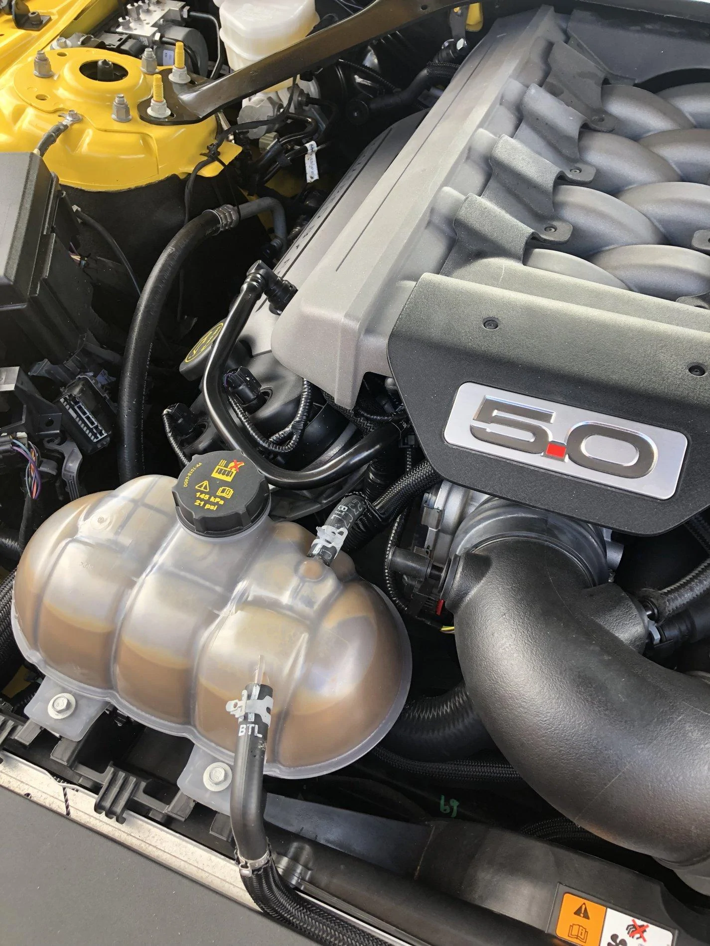

its a shame and surprising but i'm more interested in something else. how did you get the 17 engine cover to fit onto the 18 mani i've got the mani sat in my garage and yet to fit it as i've been looking for a solution to re-fit my 17 cover.

Think it's intake (air) not Intake manifold? I saw some guides to make a 18 mani fit a 15-17 cover, but need to look at them in the flesh and see if there's a possibility to create new pins and use them, or mounting some studs and bolts to it.

I had an engineering shop make up some brackets. I used a hacksaw and belt sander to remove the bracket at the back of the 18mani. They charged me about £60 if you want me to pass you their number?
