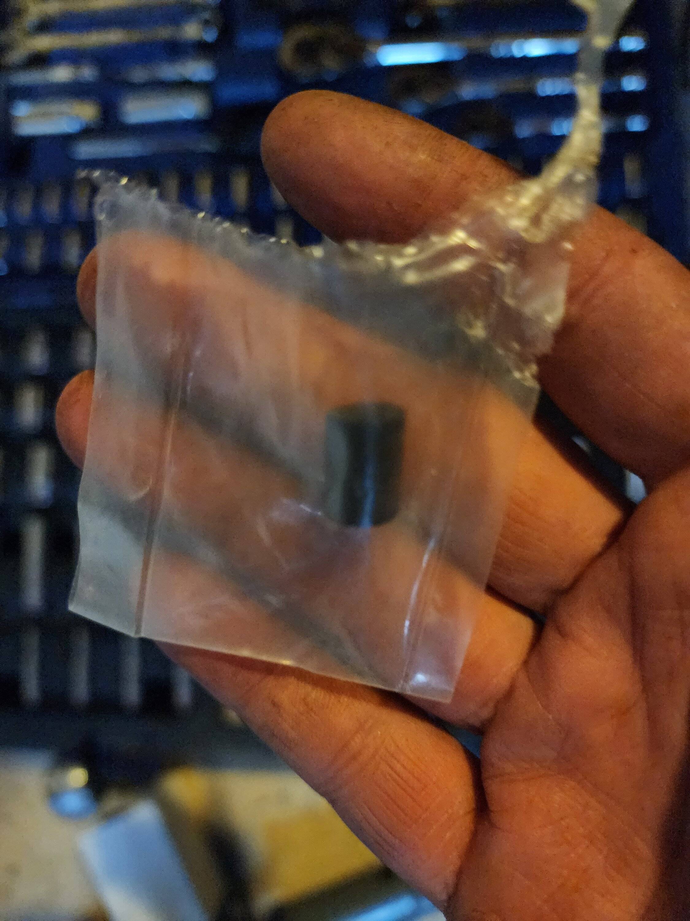

Installed a steeda street short throw shifter and shifter bushing bracket. Install was not fun on jack stands. At any rate, I have a couple questions:
1. Steeda includes a black rubber piece in the install bag for the shifter. I don't see anything about using it. I've attached a pic.

The supplied rubber piece is to be trimmed down and inserted into the knob before screwing it onto the shift lever. I tried this with my Steeda Tri-Ax race shifter and the threads in the knob disintegrated on the first short drive.
I ended up ordering a Steeda knob and using a jam nut to have adjustability and now it’s perfect.

Thanks both. Sorry I attached the photo.
Since I'm using an aftermarket knob, I don't need to use the rubber piece then?
