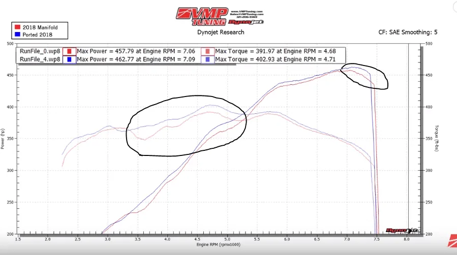

I got a used 350 ported IM with 47 lb injectors, just haven't installed it yet. Looking forward to seeing the difference in dyno with my current PP2 and FP tune.
The car it came off of was a 11 second car (Previous owner went with FI). Keep in mind that benefits are unlocked through a good tune. When I do the install
and dyno it I'll post the results here.
If you are going to install the IM and injectors with no other changes, keep in mind the GT350 heads are CNC ported to match the 350 intake manifold, your 5.0 heads are not. You should still see gains with the new setup, I will be interested to see where those gains are and how much show
Good point, let me see what my friend did when he had this set up in regards to the heads. I'll also retain my current 350 TB/Intake on the PP2 as well.
