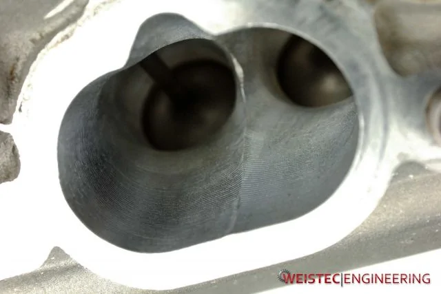

Hi. I was curious if the porters for the gt350 heads could work amg c63 heads? Since the port layout is very similar?
The flow numbers i have:
lift ported gt350 c63 stock c63 weistec
.2 192.0 202.9 205.9
.3 267 300 318.7
.4 312 348 375.5
.5 338 358 389.8
.6 357 359 397.9
gt350 intake valve size 38.3mm, c63 intake valve size 40mm
