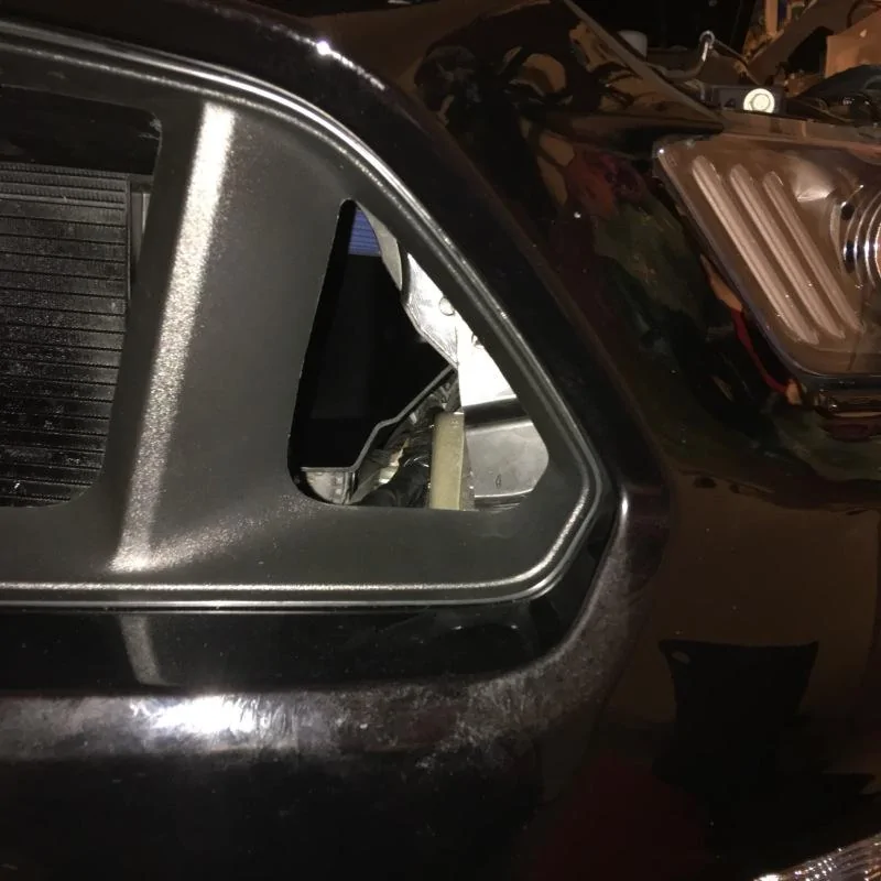

Am i missing something? The gt350 snorkel end does not fit the factory inlet opening from the grille
