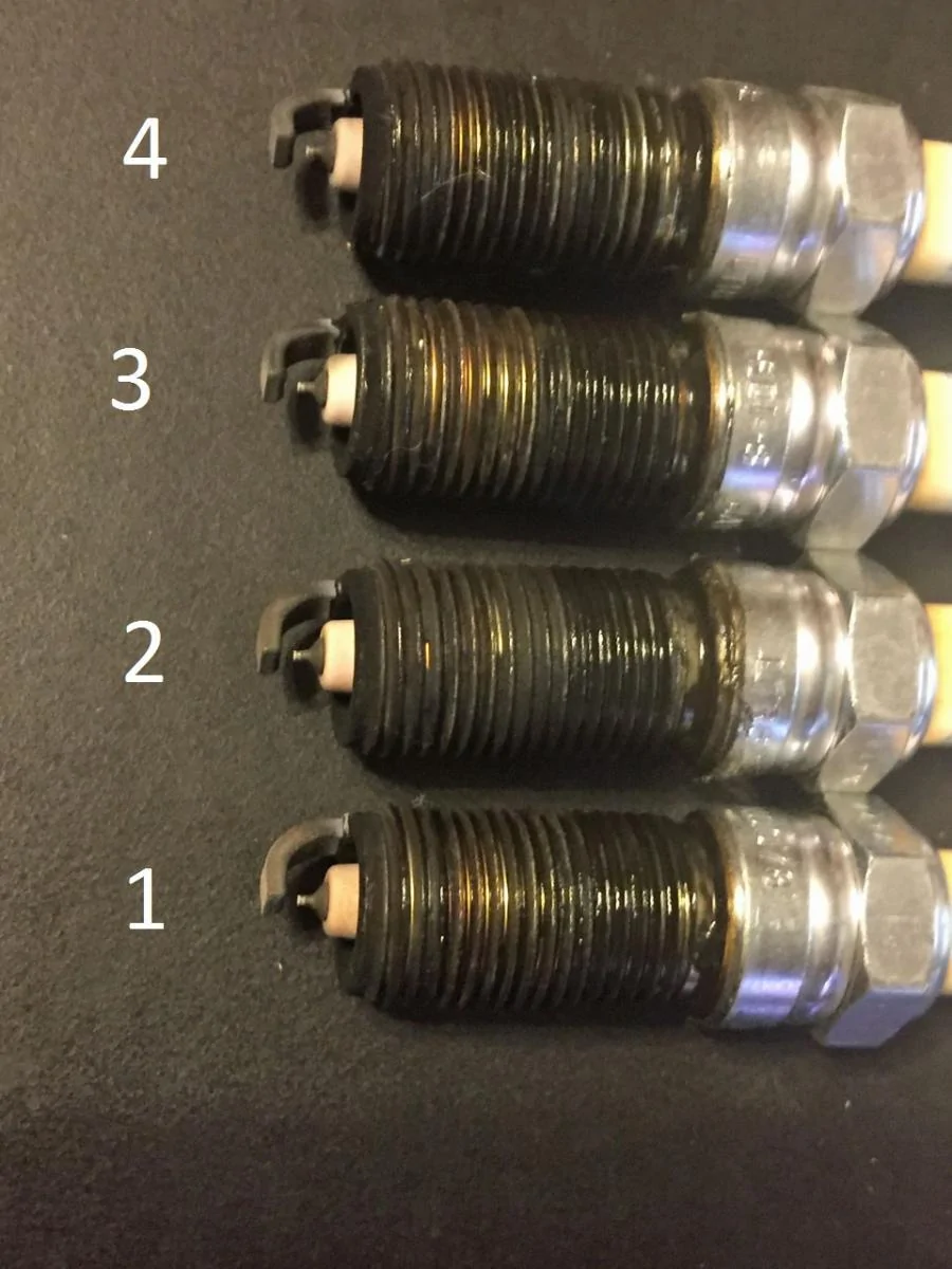

Carbon build up, spotting on the insulator plugs, the shading on the ground strap, broken or deformed parts of the plugs, etc.
Ideally, you want to see zero damage to the plug with minimal carbon build up and an insulator color that's white/light gray to a light brown color.
