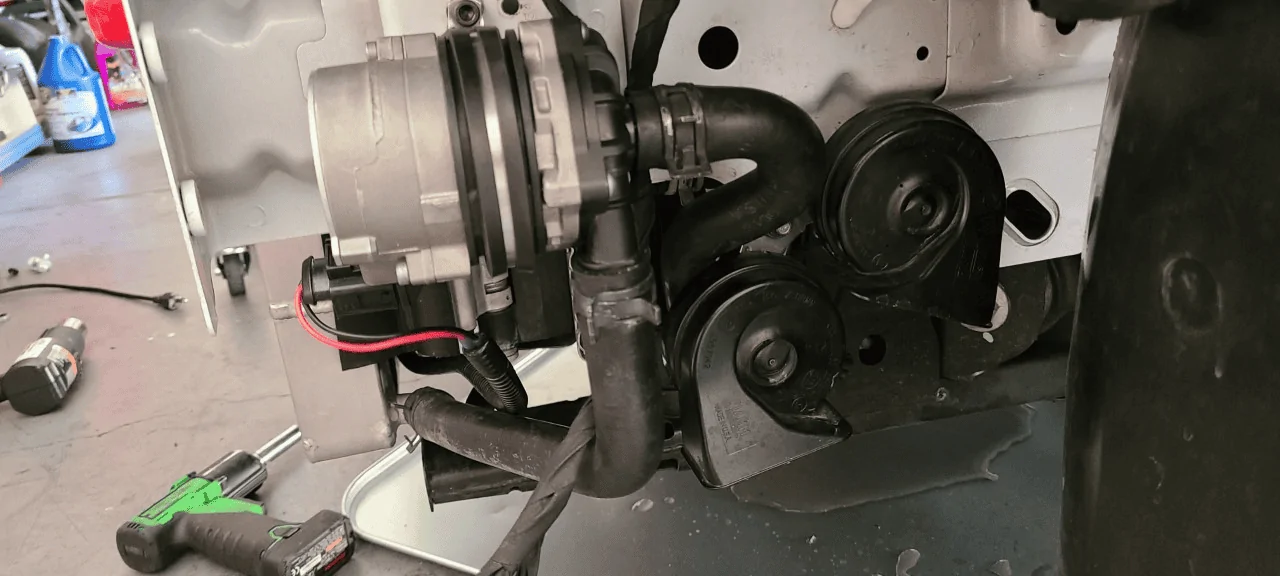

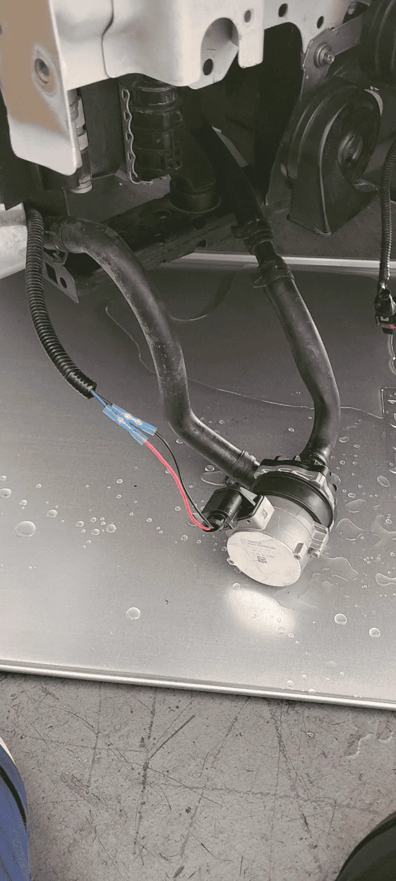

Im running a vmp tripple pass dual fan heat exchanger and a cwa 100 pump. Its worth it 100%

How did you integrate the CWA pump with the Roush harness? Is there an adapter, or did you make a harness?

im using a vmp harness, because im running dual fans too. Cut off old pigtail, crimp on cwa 100 pigtail.

@Vegas5OH My CWA 100 did not come with a harness. What pins did you use?

My pump is a 100-3 there is only a power and a ground to connect.

no the 100-3 has 3 pins. power ground and one that we dont use.
