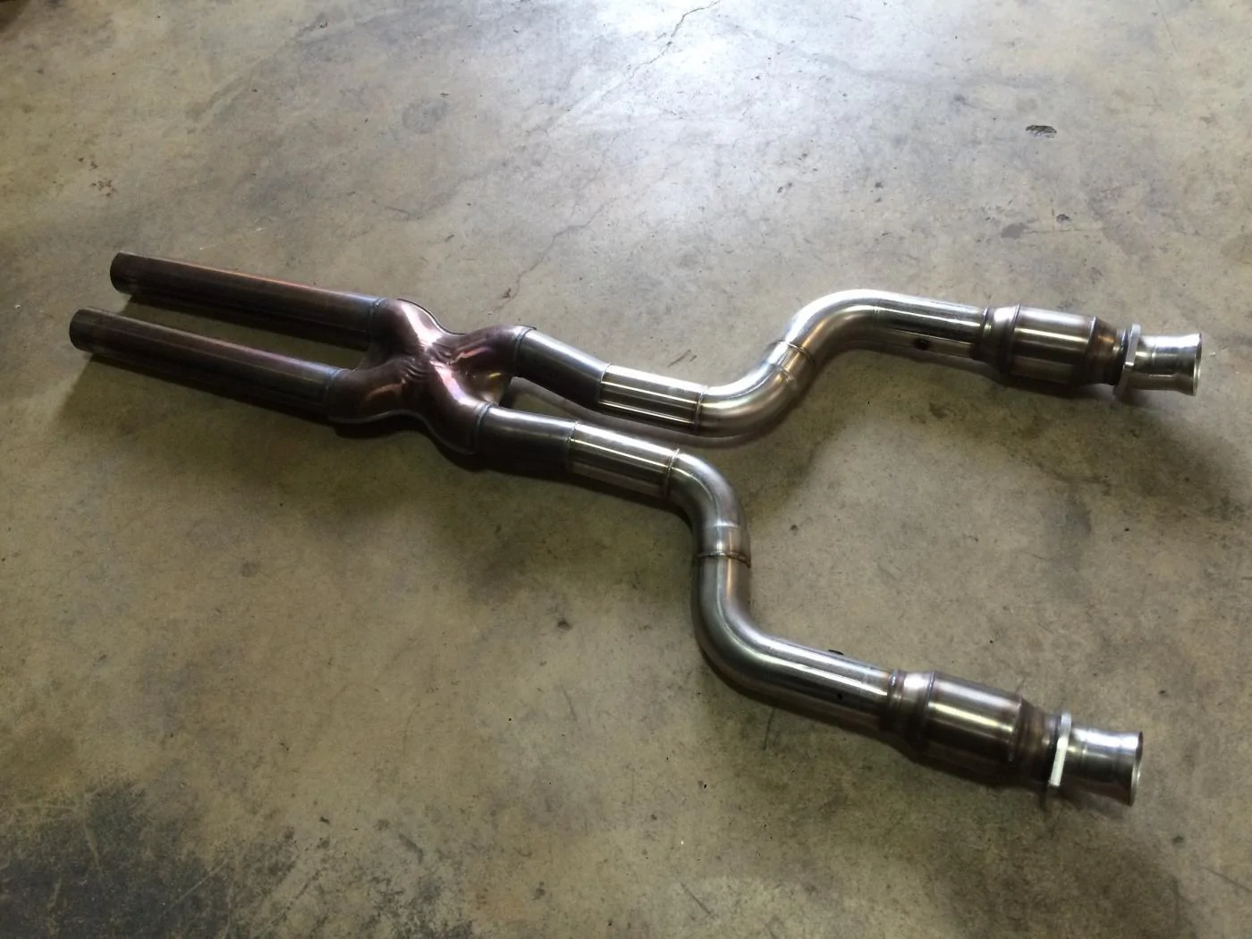

We just finished mating the kooks rear sections to the front of my magnaflow carback. Cut out the reductions / bottlenecks of course and welded in 3" straights

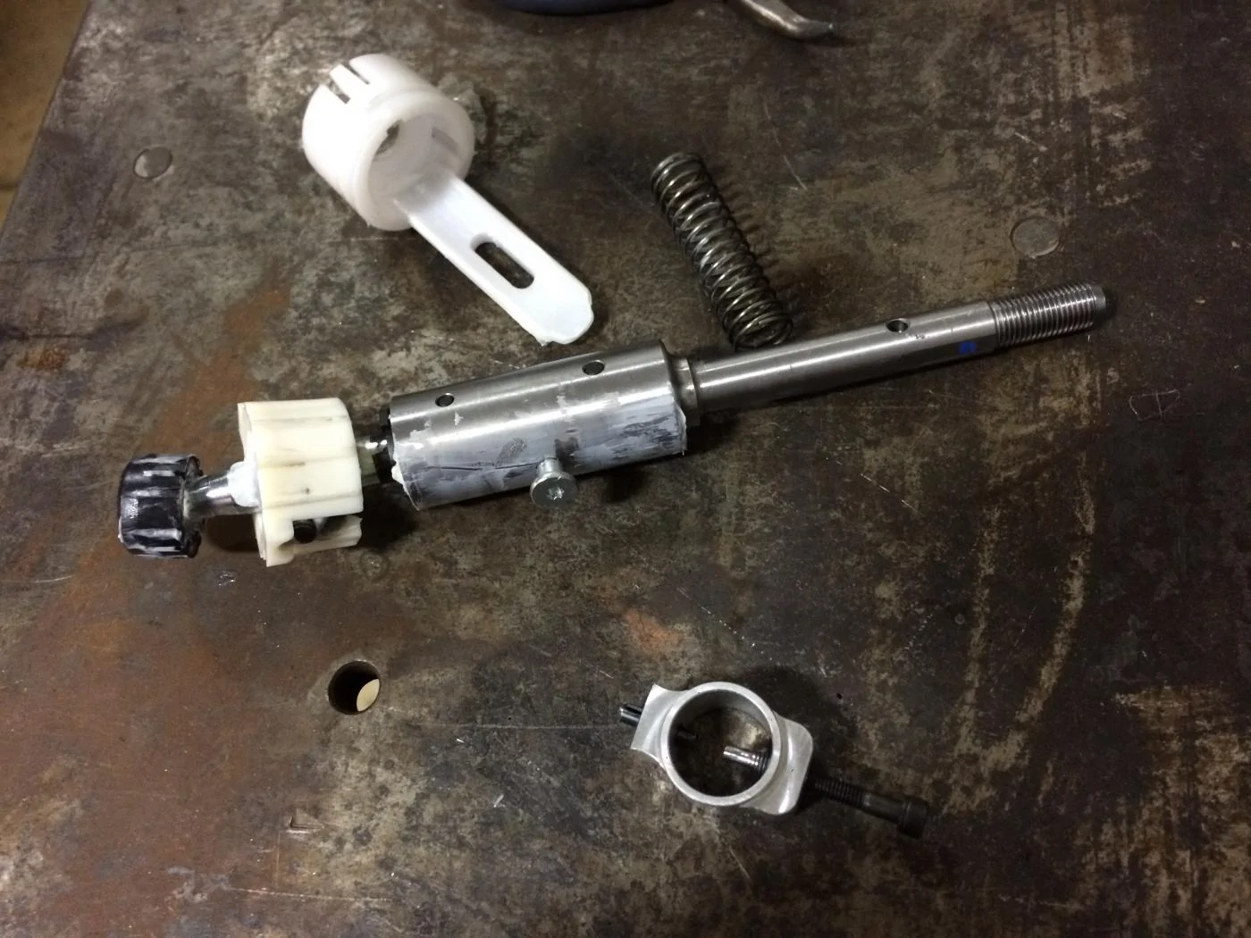

Well were calling it. Turns out you need some special tool to press a roll pin to get this rediculously over complicated shifter out of the car. This shifter is a train wreck. So I'm gonna have to abandon the car until I can get this SST to remove the roll pin. There might be another way, but I'm not seeing it and I'm tired and jerking around with this.
I'm confused. I haven't heard anyone who changed their shifters say they couldn't get the stock one out.

Ya the shifter kits come with the tool

I got over my disbelief in how obnoxious the shifter is in this car and made a tool myself to press out the roll pin. I win another round.

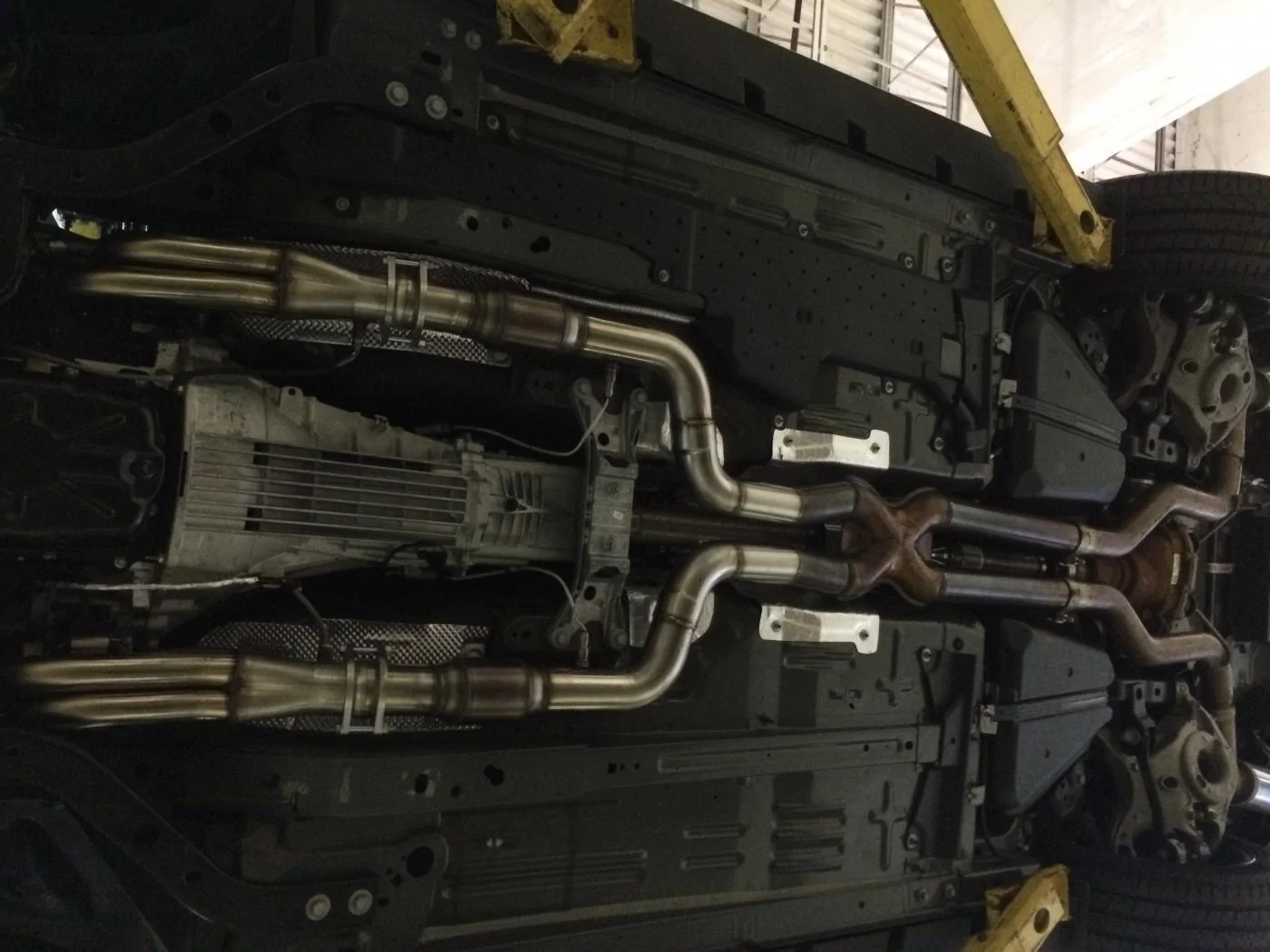

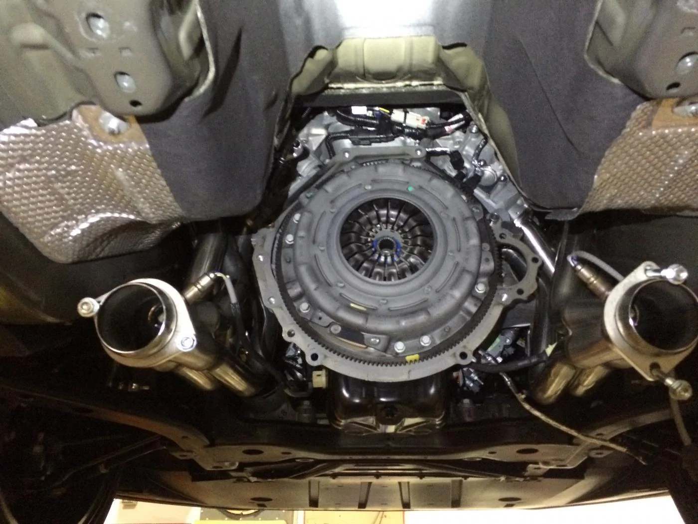

Drove the car for like 5 hours today. I love the new setup. Clutch drives awesome can hardly tell it isn't stock. Pedal might even feel lighter than stock. No extra noise from the twin disk because the floater plate is sprung, awesome.
The headers sound sick. Cold start scared me for a minute but they actually aren't much louder when driving normal... But the car screams when you get on it. I think it sounds exactly how I hoped it would. A little raspy sometimes, but it sounds mean either way.
I can't tell if it's faster but it's definitely not slower. I'll try and dyno right away.
