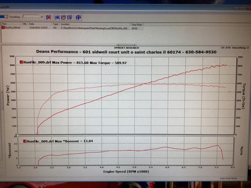

I'm sure everyone saw the thread.. But for the sake on continuity I will post my Lund e85 dyno results here. See attachment.
